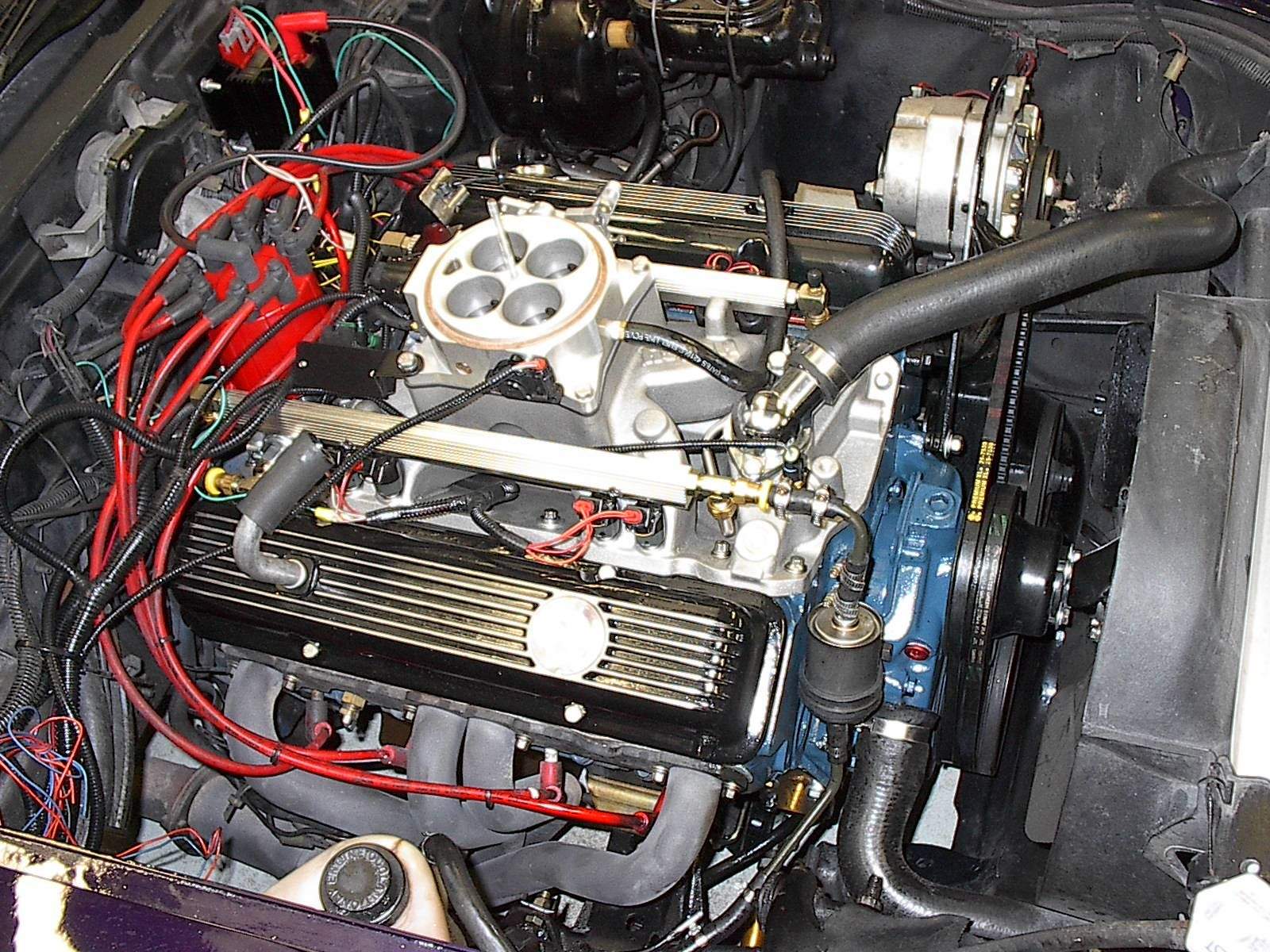

I ran the headman ceramic coated headers on my 72. They were full length and were part number Hed-68306. I had no fit issues and had no issues mounting the collectors to a stock style exhaust.
Same car
Would you happen to know if those Hedman headers will fit with a Borgeson power steering system?
