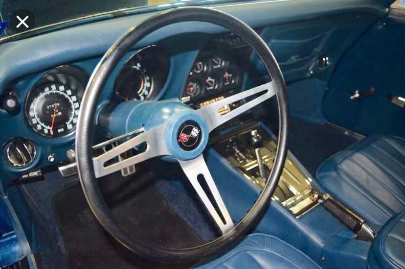

This is my “hula hoop” steering wheel...
My 71 is all stock, matching numbers and pretty much all original and I want to keep it that way. Unfortunately it is not equipped with a tilt telescopic steering column and at 64 years old the huge steering wheel makes it difficult to get in and out. If I find a blue TT steering column someday I may switch it out but until then I’d like to install a smaller, 78 to 82 style steering wheel. Will the later year steering wheel bolt right on? I may need to go back and forth between the original steering wheel and newer smaller one if I show my Vette. I don’t think I’ll be lucky enough to find a blue one but I’ll have it recovered anyway. Should I limit my search to specific years? Thanks for the advice...

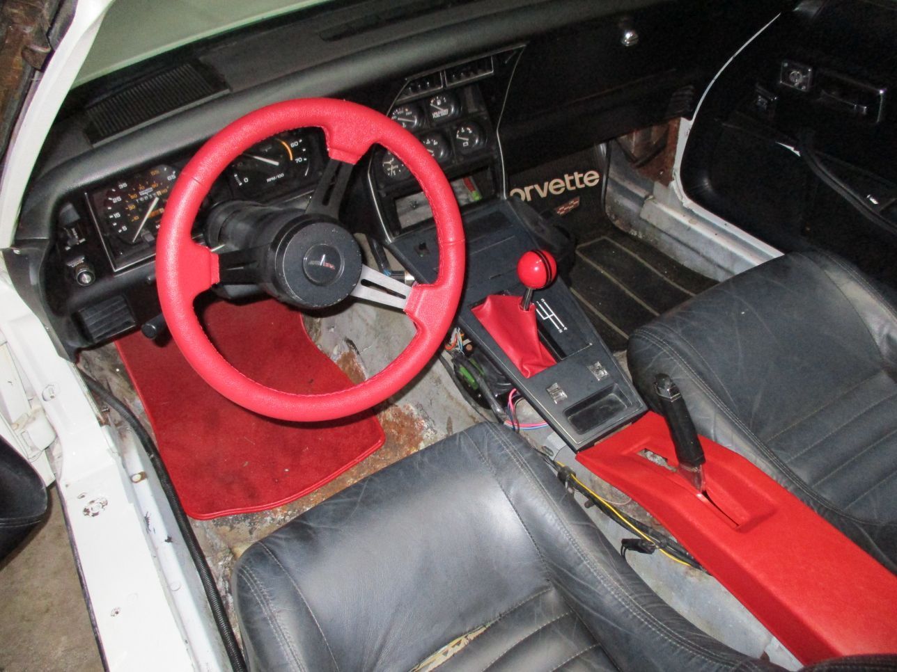

Volante Steering Wheels has a few that are C3 appropriate in a few more colors (no blue, though). I put an S6 Sport with black spokes in my 80.
https://www.volantesteeringwheels.co...ts.asp?Cat=456
(Please excuse the photo, it was from early in the change back to the stock red interior)
