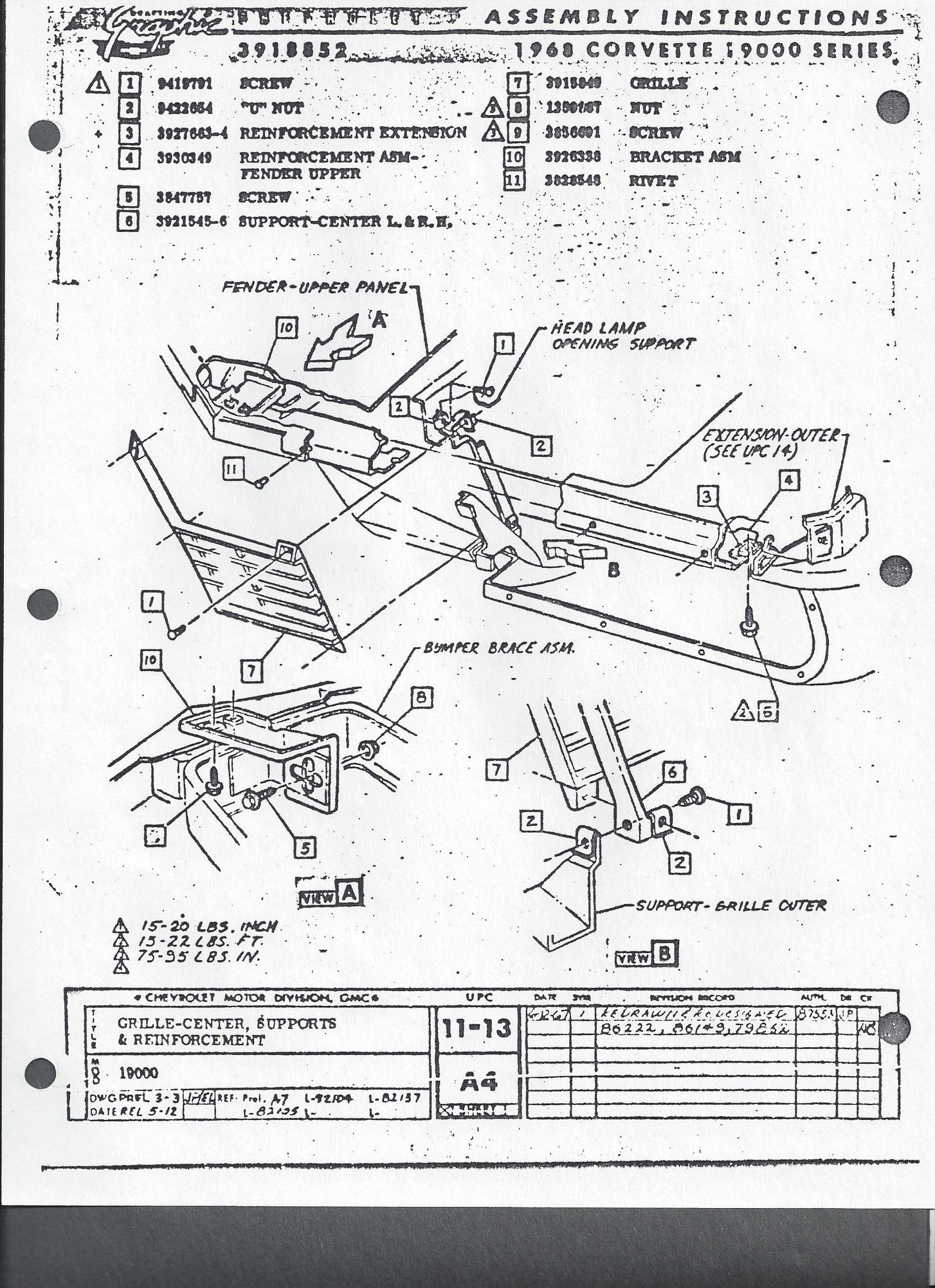

This is the early design front bumper support. This page from the AIM is not usually provided in new AIM. You'll need to find it in an old AIM. Note change #1 says Redrawn & Revised, dated 6-12-67.

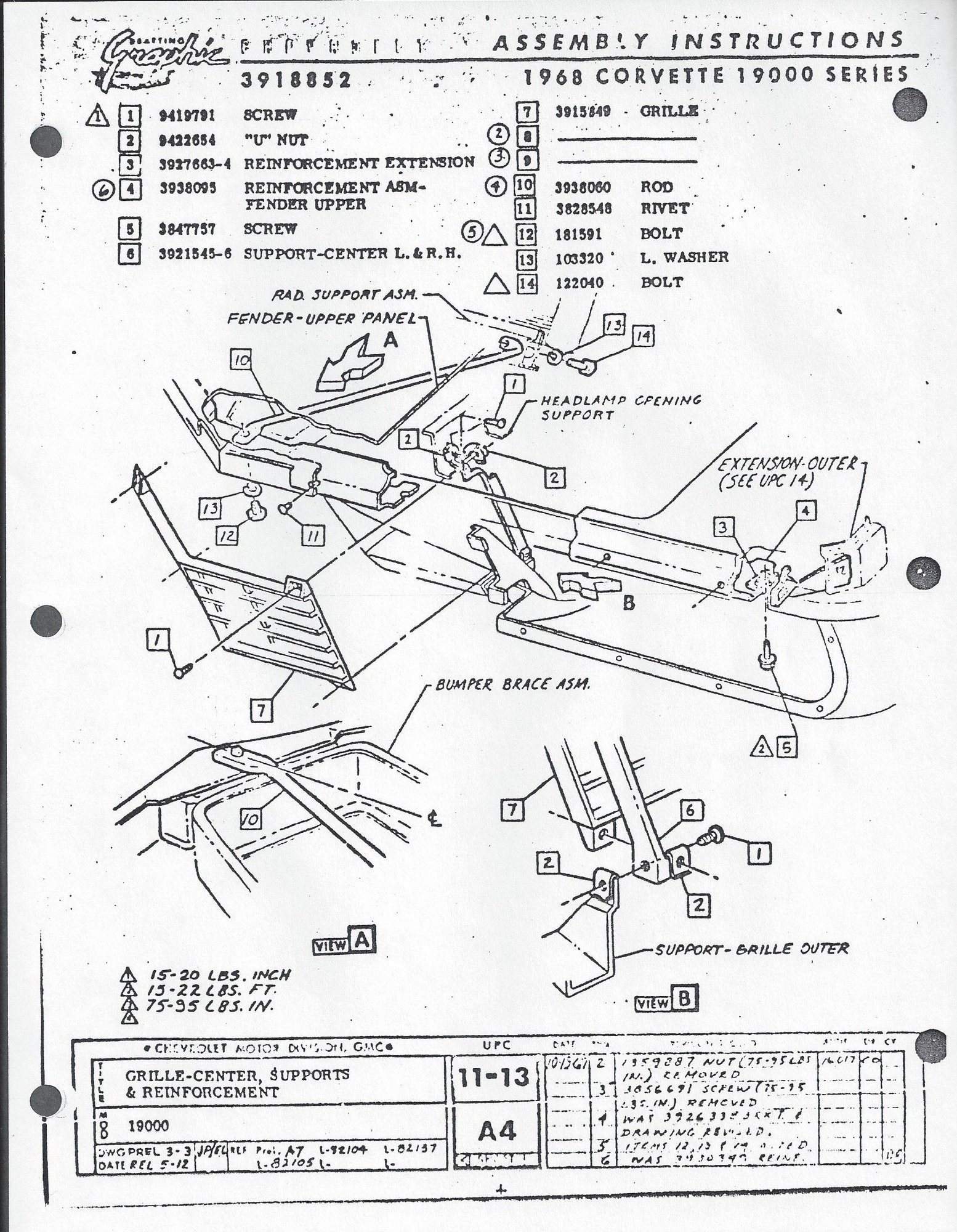

From: Roscoe IL
These are changes #2 through #6, all dated 10-13-67. These parts did not show up in production until about April 1968.
