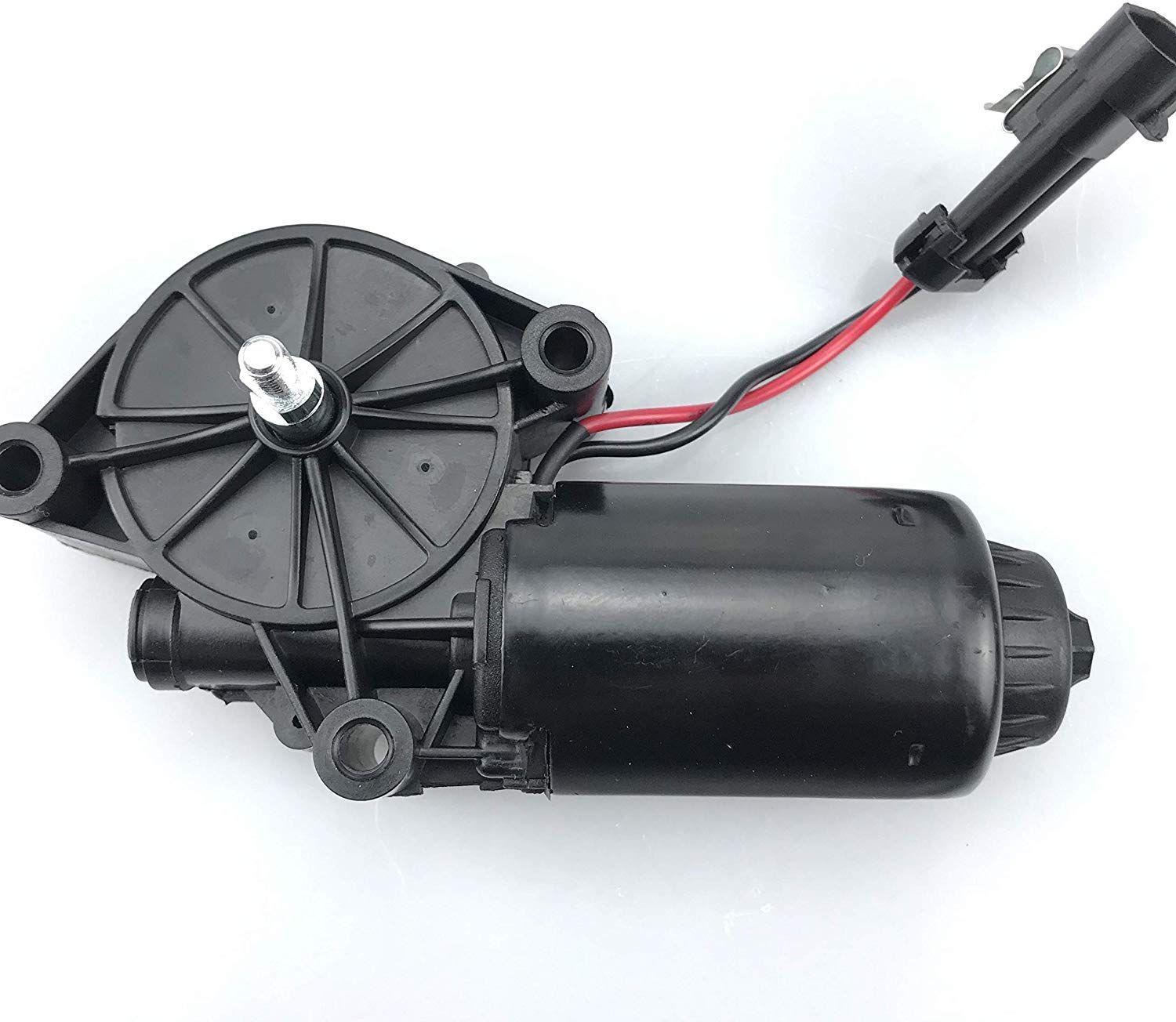

Some used Firebird motors-- with uses external electronic modules.

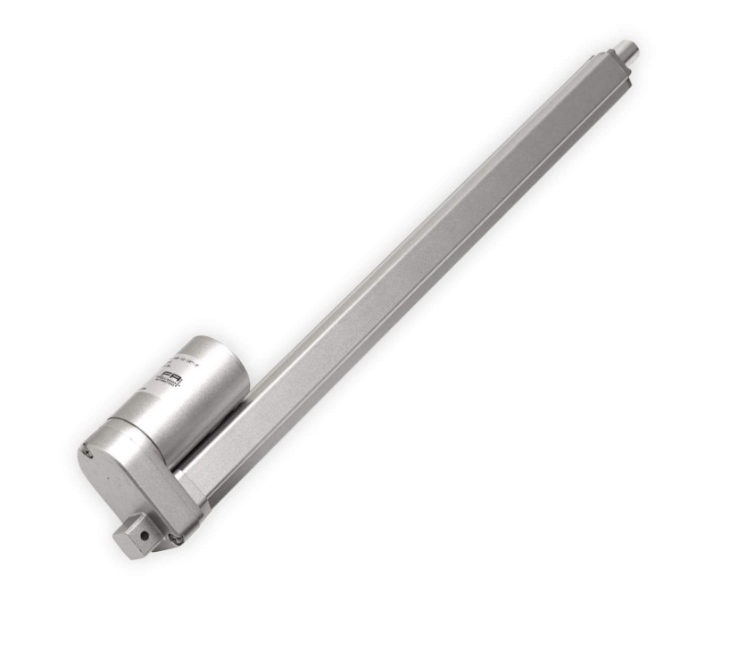

Also common were the linear actuators ones- slow but works- also uses outboard electronics.

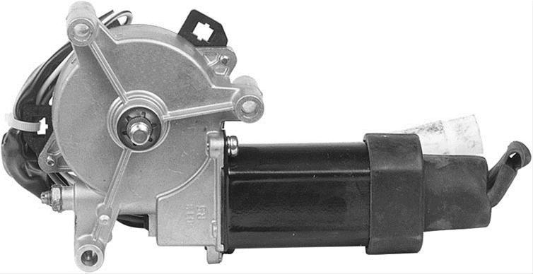

Linear actuator-
Miata Motor-
Firebird-

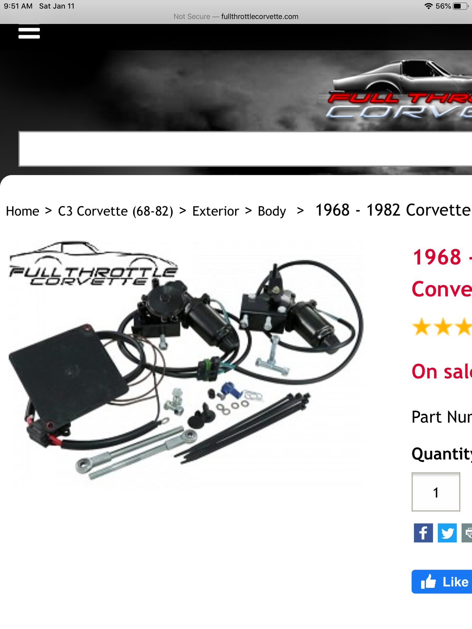

Hope this picture helps

I used the firebird / C5 motors - they are basically the came thing. You need to use the headlight module if not you're going to og nuts with relays reversing polarity to make them go down. Use the headlight module from a C4 or C5. Again pretty much the same thing.
The ecklers kit is using the module and is WAY over priced IMO
Here is everything you need https://mcspeed.homestead.com/our_products.html Hes out of business but everything you need to DIY is their very clearly.
One last edit...I did NOT need to create brackets to mount the motors if you take the gear out and reverse the spindle the left / right of the motors line up to the holes, a little grinding in the center of the housing and using the stock f-body arms and everything on mine clears and works like its factory.
