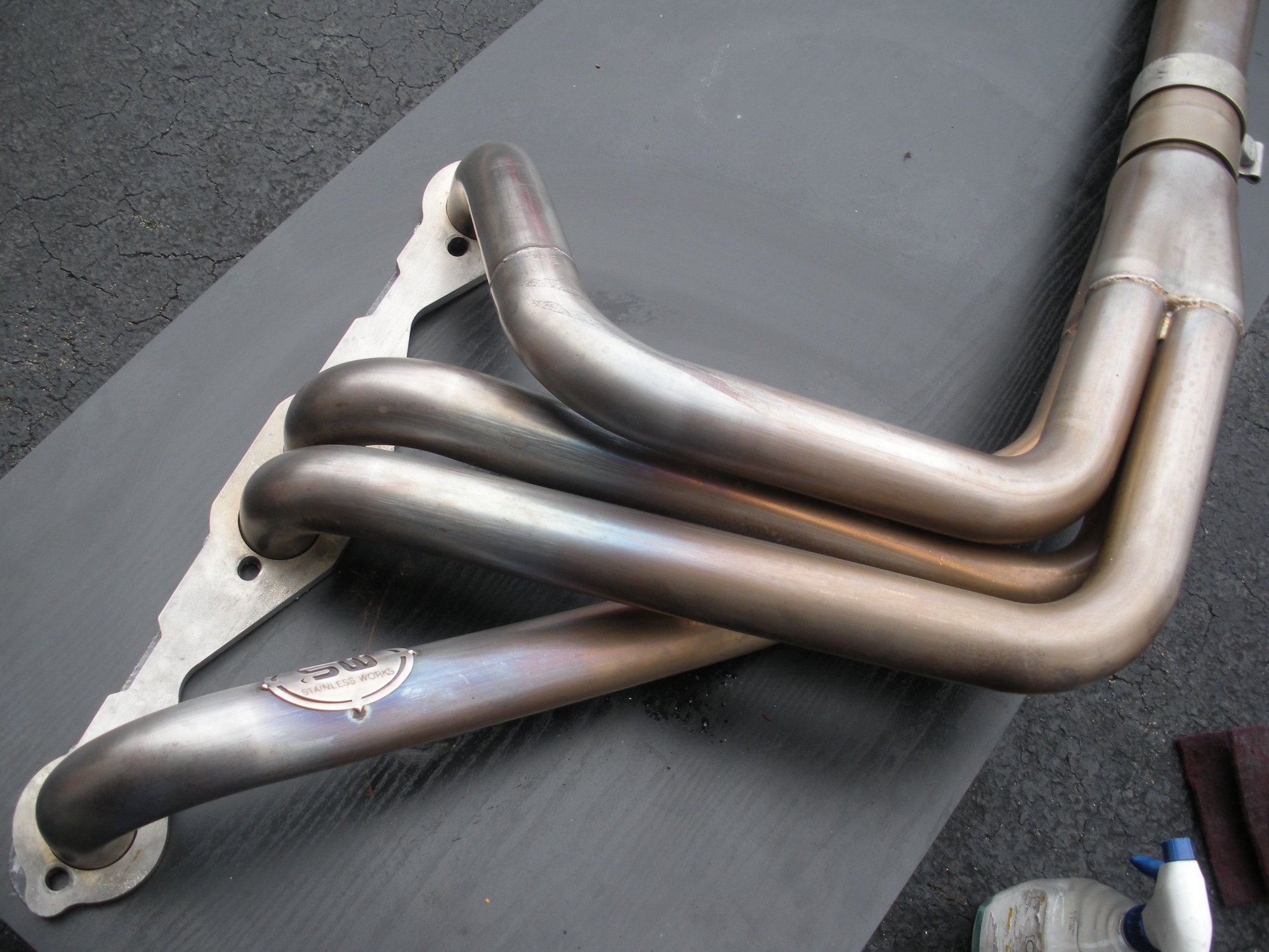

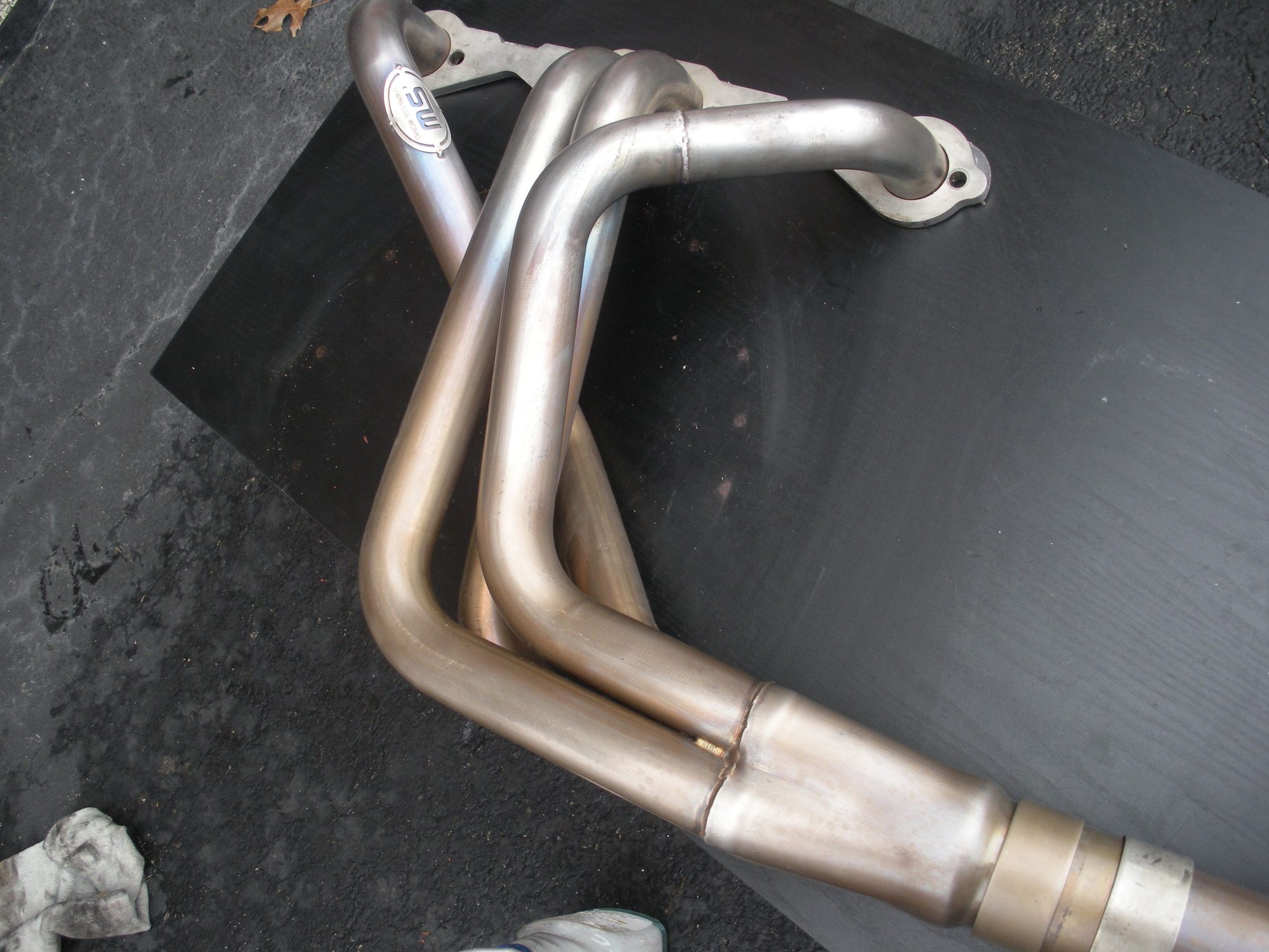

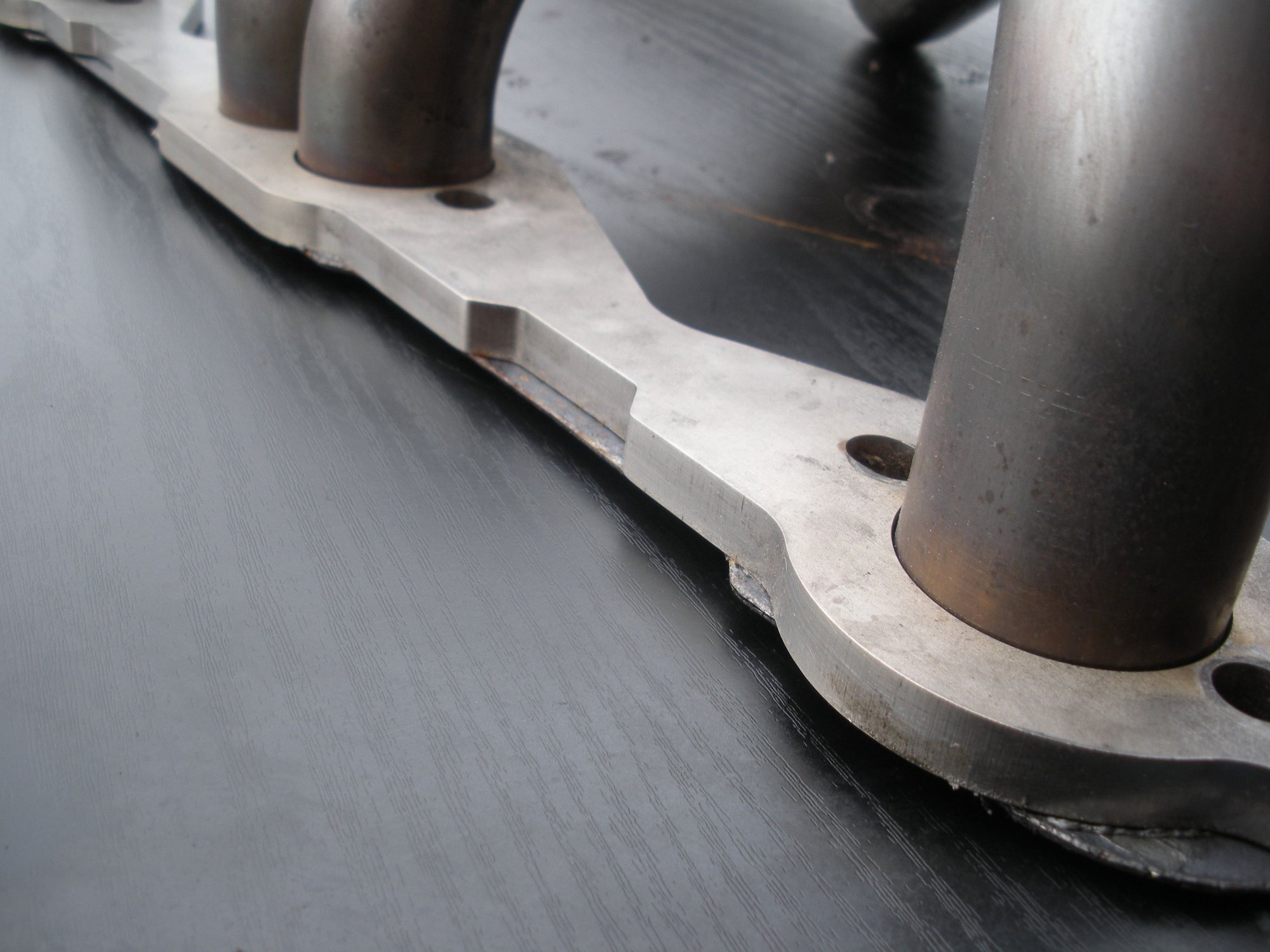

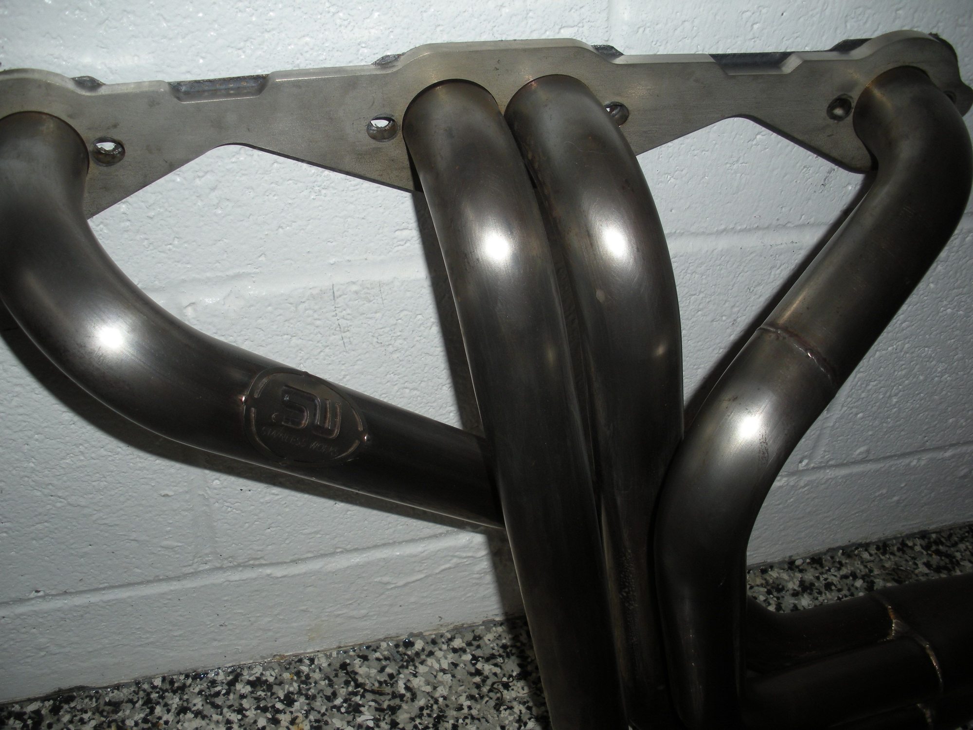

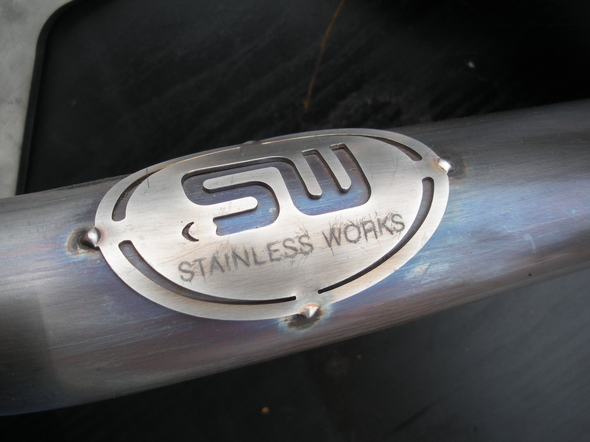

I have used both Hedman Elite and Stainless Works headers on my 77 Vette 350. Both have adequate clearance, but the Stainless Works cleared better, had more ground clearance, and clearly are better quality.....although they cost more. Extremely high quality welding, fit, and thick mounting flange for no warping. Really nice. I currently have my Stainless Work headers for sale in the forum classified, as I need to go bigger for my new engine. Highly recommend.

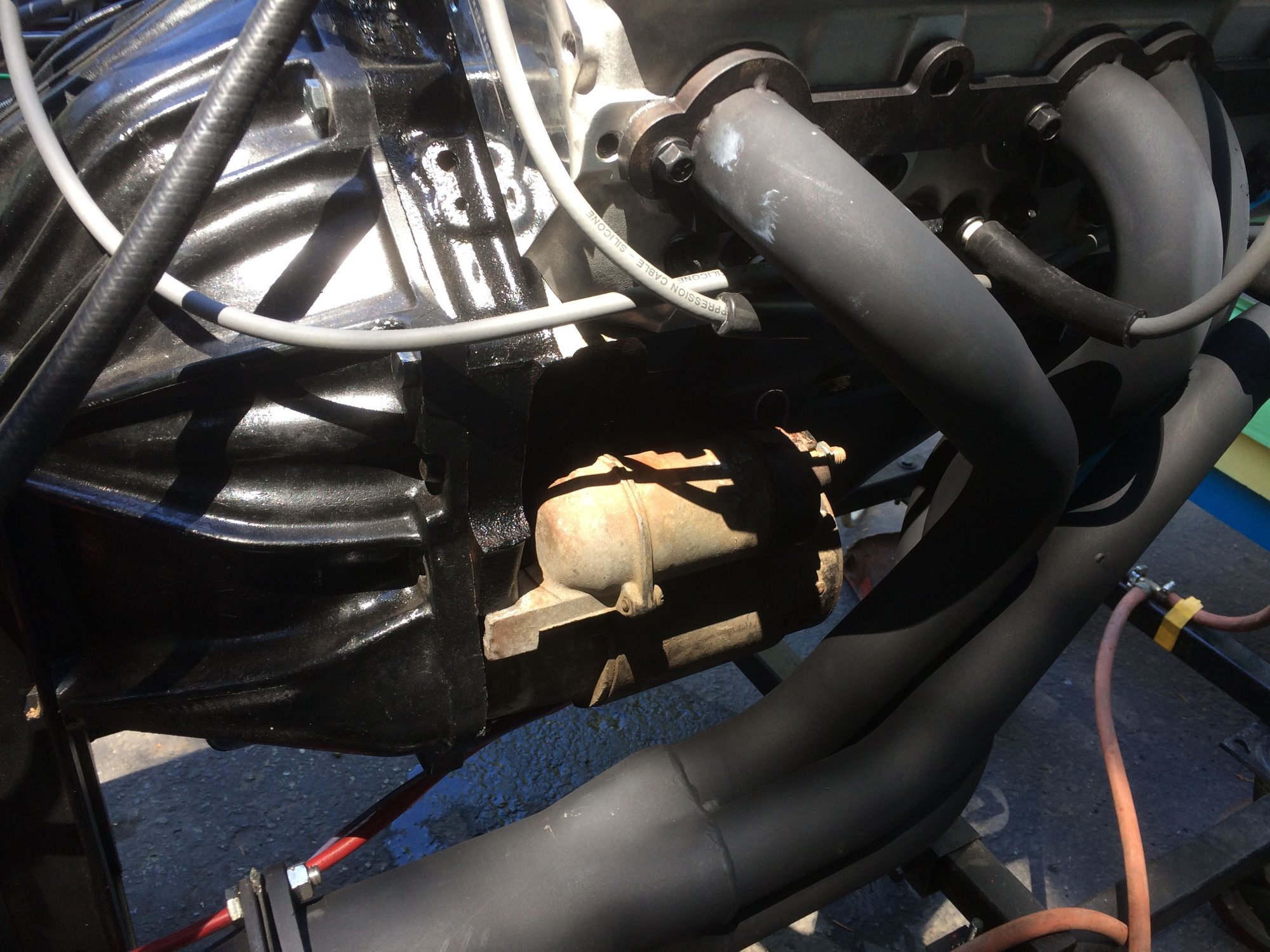

Here's some hookers they fit good but close to oil filter

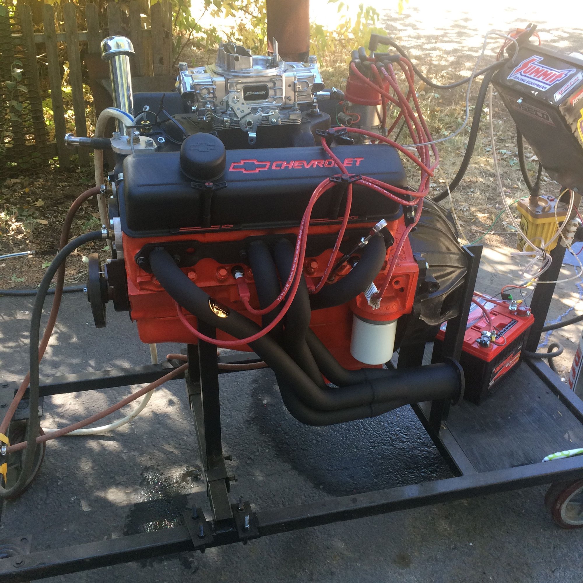

Here are the summit brand cheap but same thickness as hooker but fit way better
And full size starter clearance
Probably the best fitting headers I've ever had and the cheapest .
