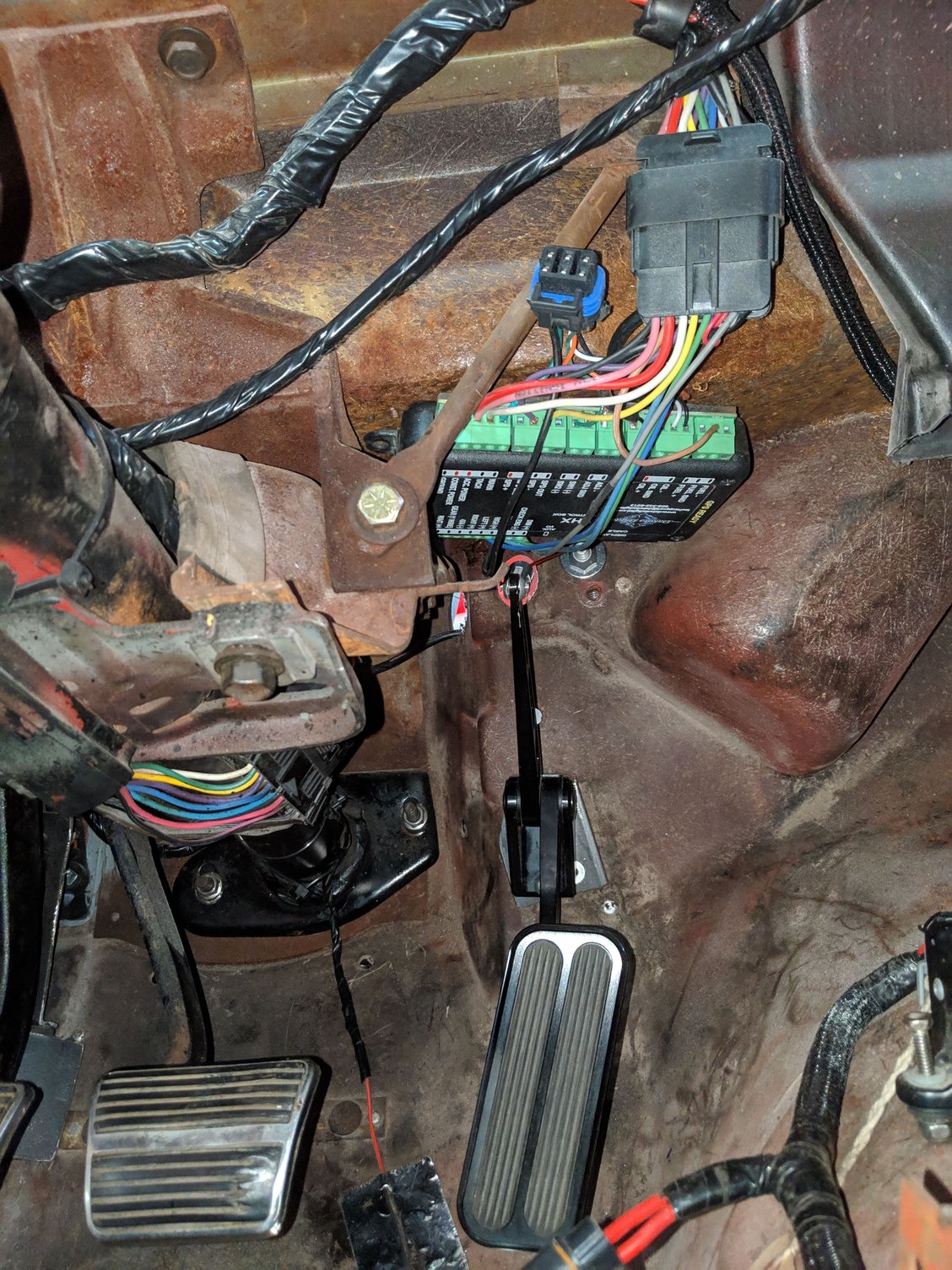

My other complaint is their control box. The wires are clunky, and really hard to not make bulky going in. They really need to have, say, a 40 pin connector coming out of the control box, with a connector you can populate with only the wires you're using.
I've found you just can't put enough tension on the wires at the box because of those screw down terminals to really get it loomed up nice. Does anybody have pictures of their install?

Actually that's what I did. I used a GM 20 pin connector and run my wires to that. I can disconnect the box troubleshoot, add or remove and need disturb the rest of the wiring.

I had debated doing it, but you still have to wire into both sides of that box. Do you have pictures of what you did?

Found a build photo. It's attached to the car with high strength Velcro.
