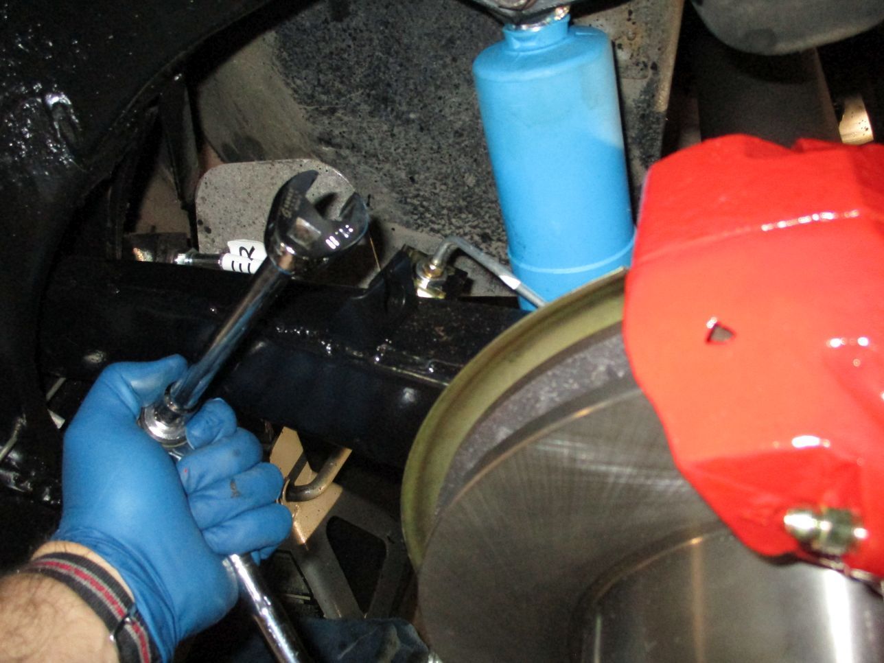

In addition to the flare nut wrenches, I needed crows foot wrenches to get the rear brake hose replaced. I bought this set from Amazon.
Nice... Love more tools.... ORDERED!
