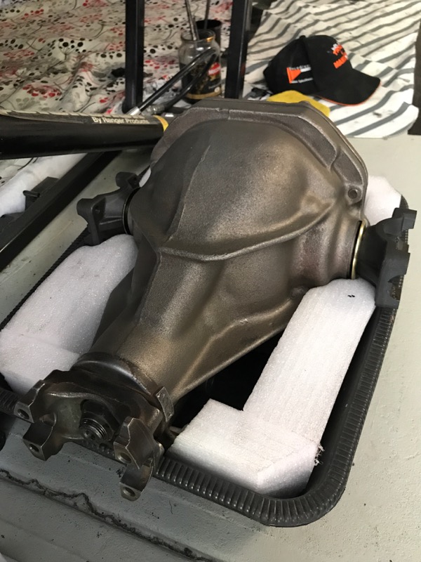

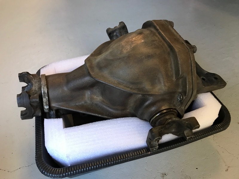

I Cleaned my diff with simple green and wire brushes before sending out for rebuild.
They removed the internals and media blasted it with old bearing shells in place.
Came back like this...
I them sprayed it with Metal Mask after cleaning with thinners etc.
