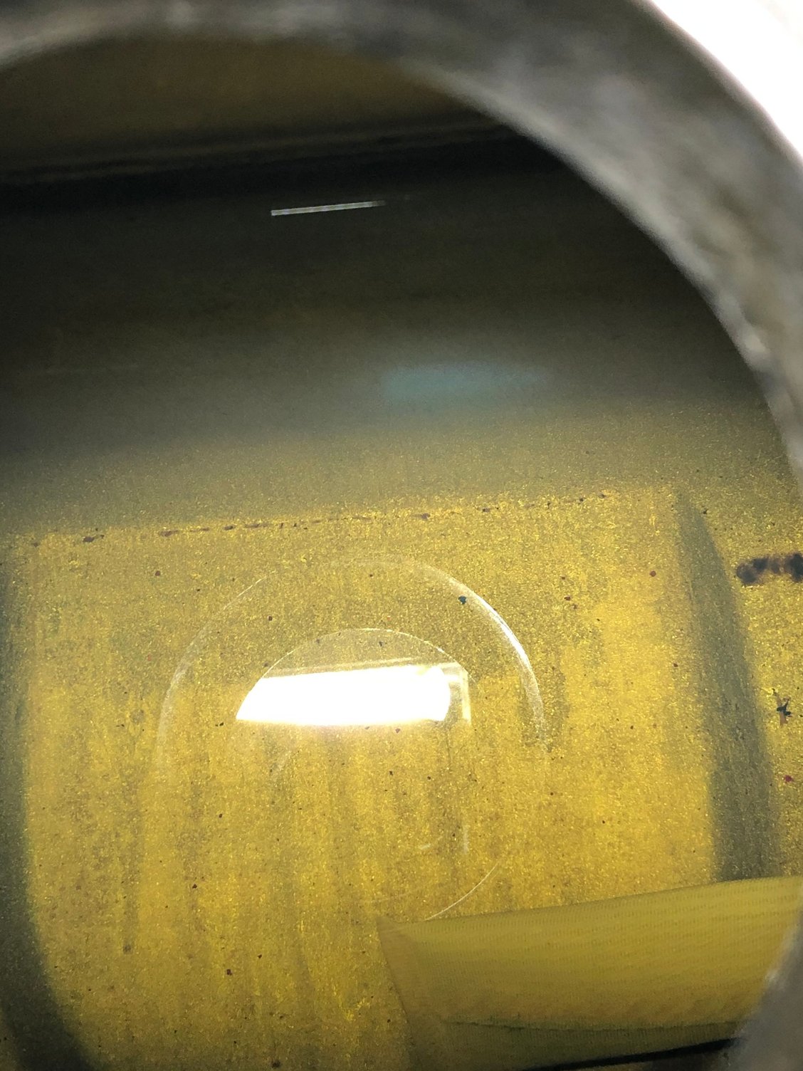

when I bought my 74, the gas tank was out of the car sitting under a tree. It had a dead frog in it too. on closer inspection the top had tiny pin holes where the straps had rusted through.
I bought the por15 gas tank kit for about $50. Washed it several times followed the directions. Dried it with a hair dryer and put masking tape over the pin holes. Then you basically dump a quart of product in and spin it around till it’s all coated.
that was in 04 and this is a shot of the inside today. It's a little work but I've been happy with the solution.

The inside of mine above was well rusted. Was outside the car getting rained on with no cap or sending unit. And the dead frog.
thing about por15 is it likes a “tooth” to grab on to. So you don’t need to worry about sanding or blasting the inside of your tank.
clean it, treat with their Metal Ready and then coat it with the product. The product has a silver look.
