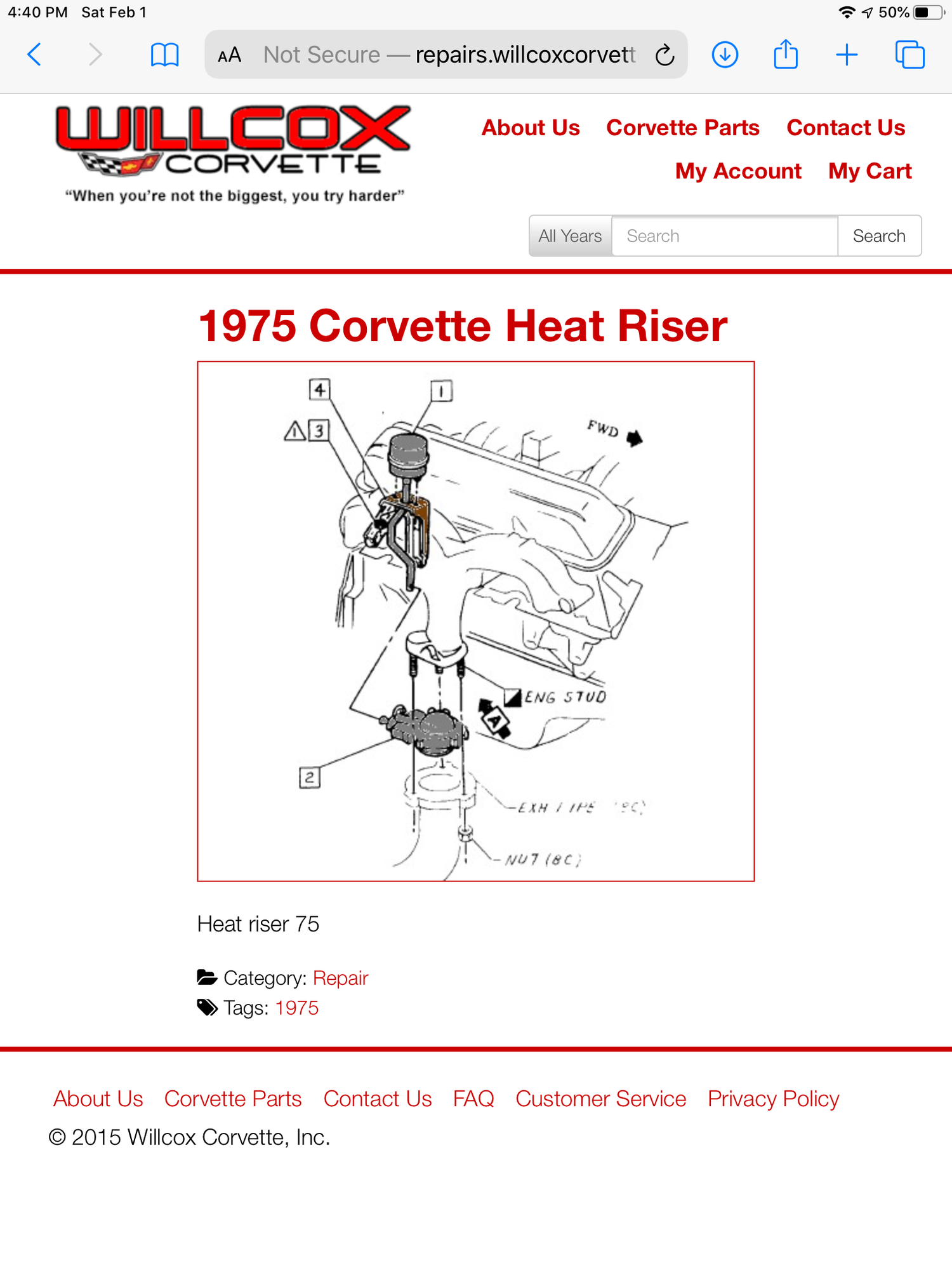

Old Feb 1, 2020 | 04:41 PM
interpon's Avatar
interpon
Joined: Jun 2019
Posts: 7,657
Likes: 2,469
From: Indiana
Originally Posted by Steve Kistler
Not sure what you’re asking, but it does have the tube that goes down into the manifold and then hooks to the carburetor and it is hooked up and sealed
maybe stuck closed?
