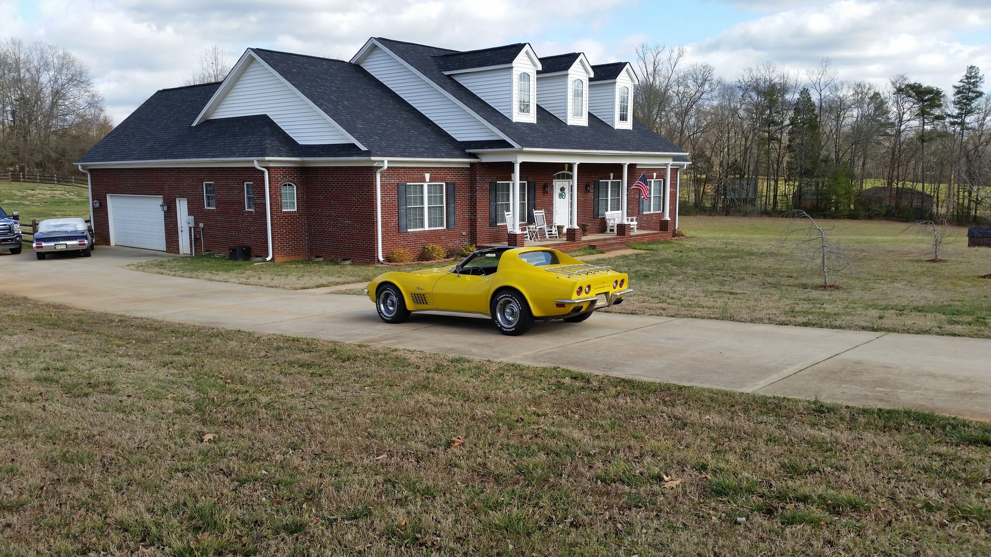

The attractive home looks much like one in Florence County SC?

Jackson, you are close I live near Charlotte, NC ( thought my info was on my profile, will need to add it )

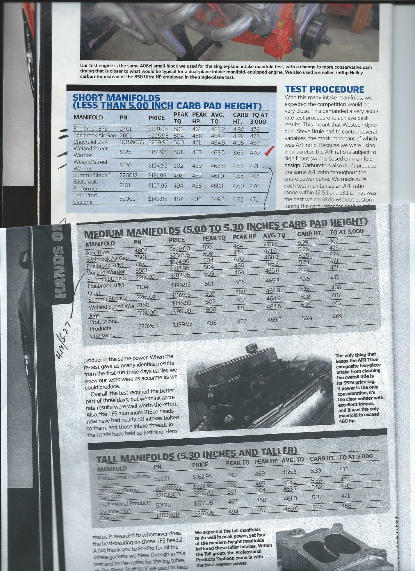

Most manifolds work well for a mild build, height is the real issue. check the thread on manifold height.
File Type: docx
