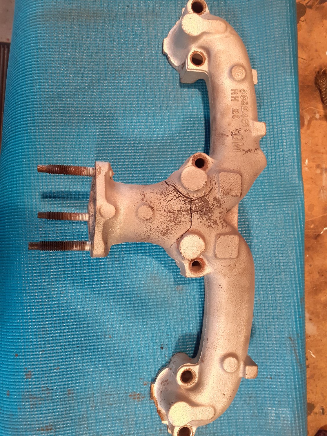

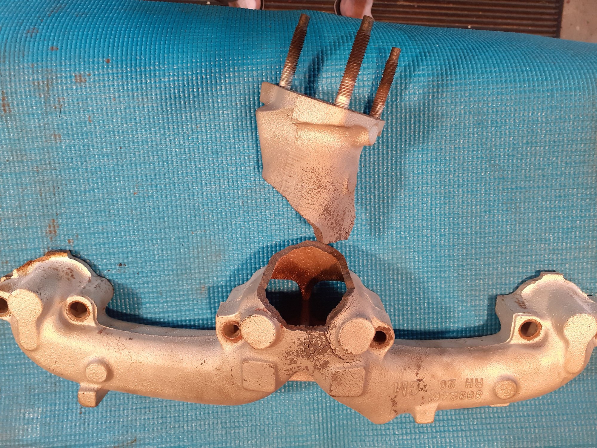

As you can see I broke my exhaust manifold LH,I was on a back road and
hit down a bit hard...but on the positive side I replace them with 2 1/ 2" ram-horns.
As you can see the car has been lowered by 1 3/4" all round....it drives a way better...but there is consequences

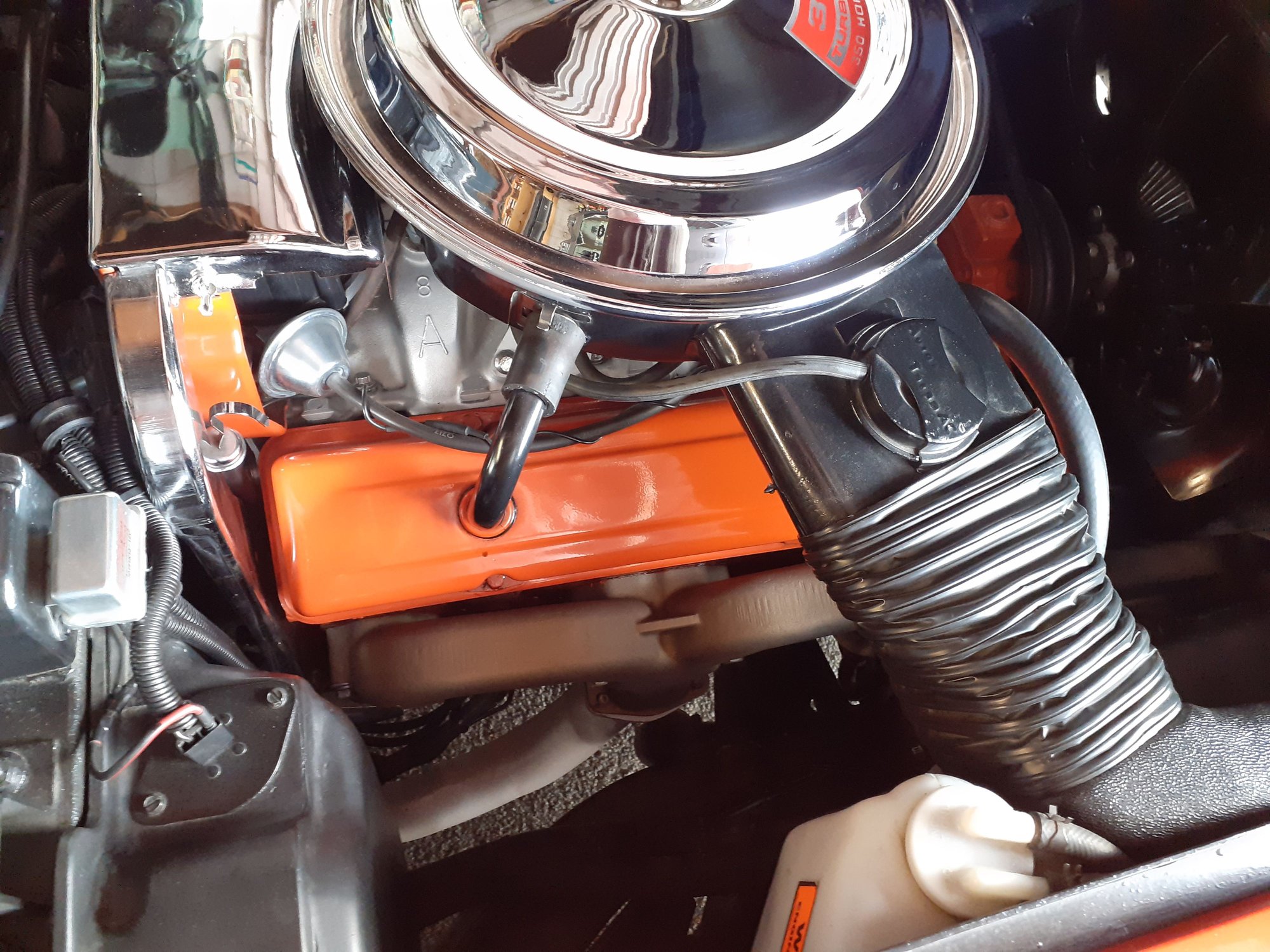

Great looking engine bay! Second only to the red car in your last picture!
Don't forget to post pictures of the new exhaust manifold.

No ..scrapped the rear a bit which I guess leveraged on the manifold,the manifold did have surface cracking but no splits.The road I was on was used by logging trucks a lot ...so say no more

Seriously, if you were in the middle of nowhere on a road trip, a good mechanic could 'V' it out and braze it with an Oxy/Acetylene torch and brass rod. The grains of metal open up with the heat, it would probably last indefinitely (or at least many years). I've welded some cast iron manifolds ...but not one as cracked as yours.

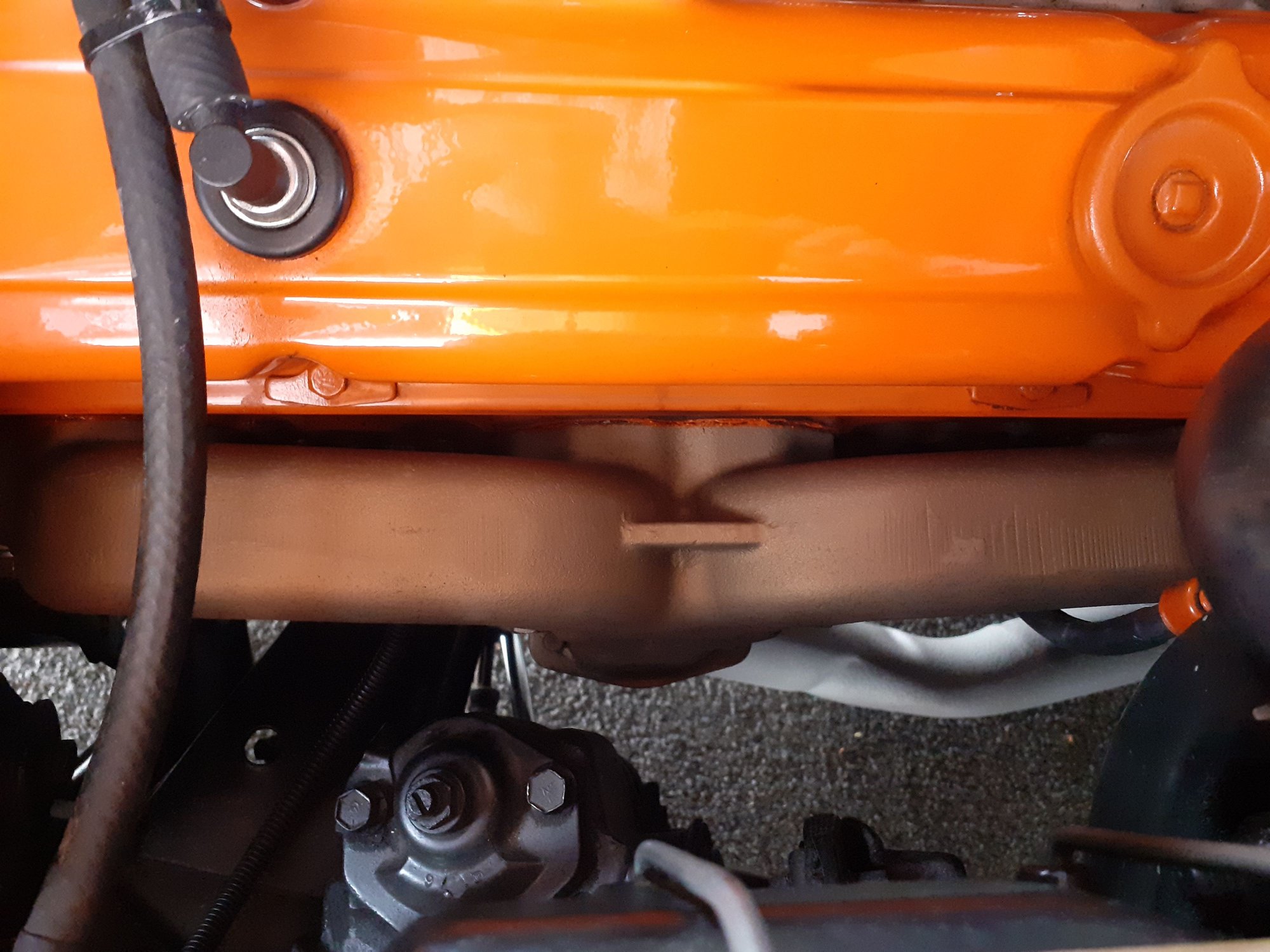

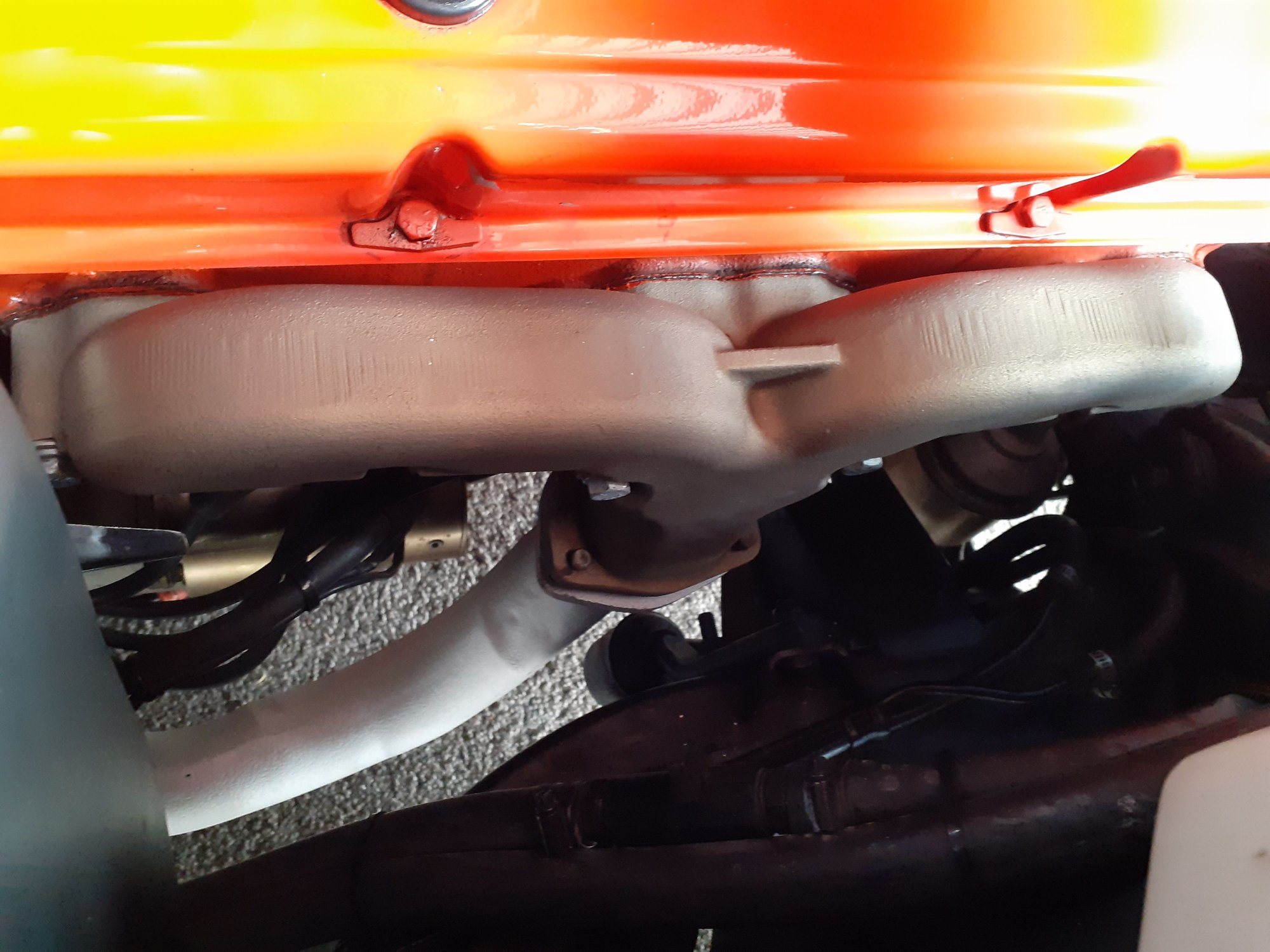

[QUOTE=nz corvette;1600921825]Now why didn't I think of that!! The truth be known when we pulled the down pipe it came away,
but would have held in place for sometime I reckon....Maybe next time I'll try the JB weld
Iv'e attached a couple of pics of the new manifolds...I think they look pretty good
