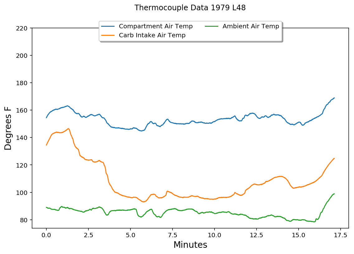

Here's a thread with @pauldana's intake, and some data I took in my 79.
https://www.corvetteforum.com/forums...ilament-3.html
The first image are some temperature readings under the hood of a drive with a drop-base Edelbrock air intake. The intake air to the carb in this case is hot. The second image is some data under similar conditions with an L82-style dual snorkel intake, taking fresh air from above the radiator. I'll have to repeat the experiment someday while measuring RPM, speed, TPS, and inferred engine load (vacuum).
