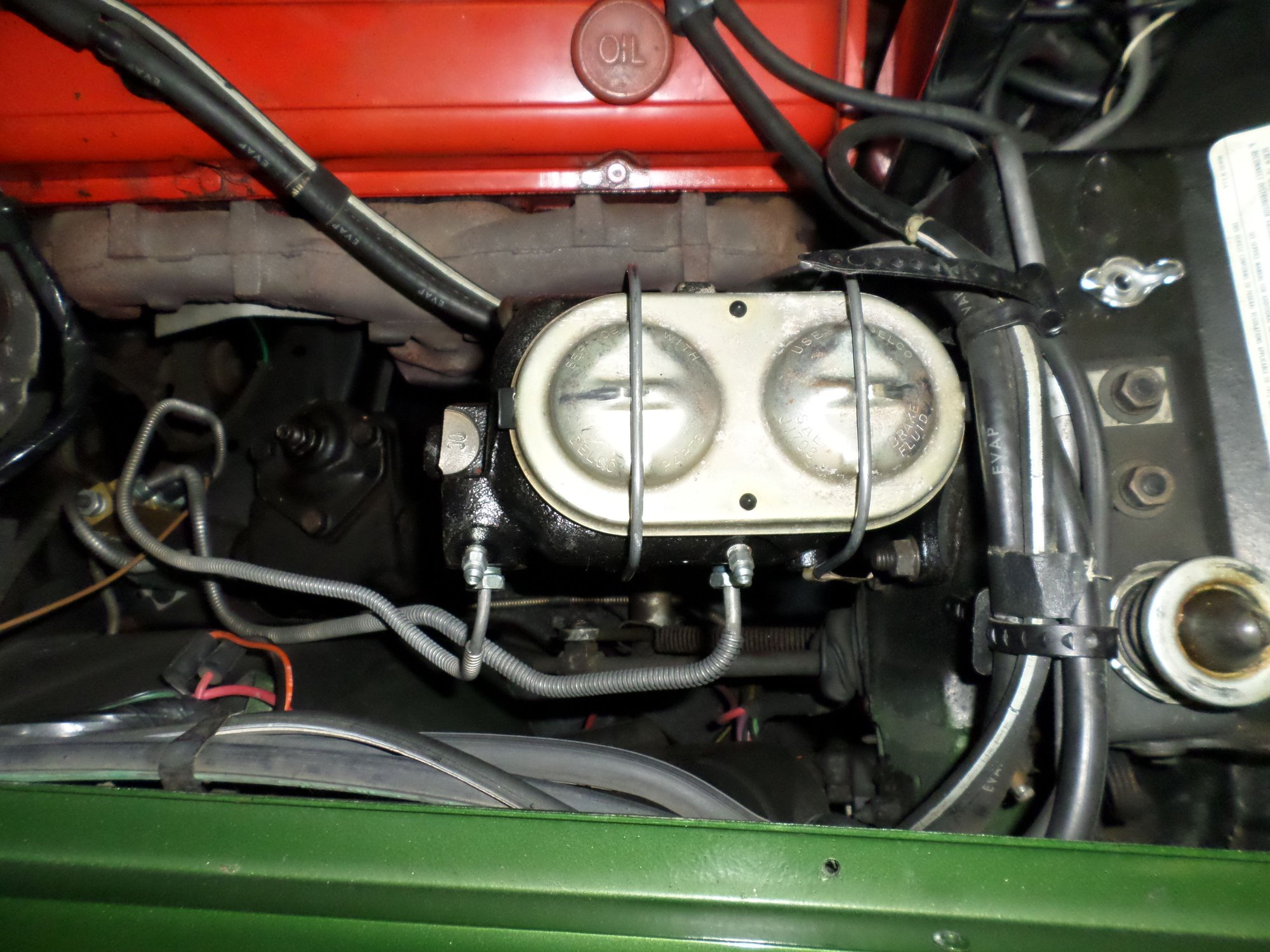

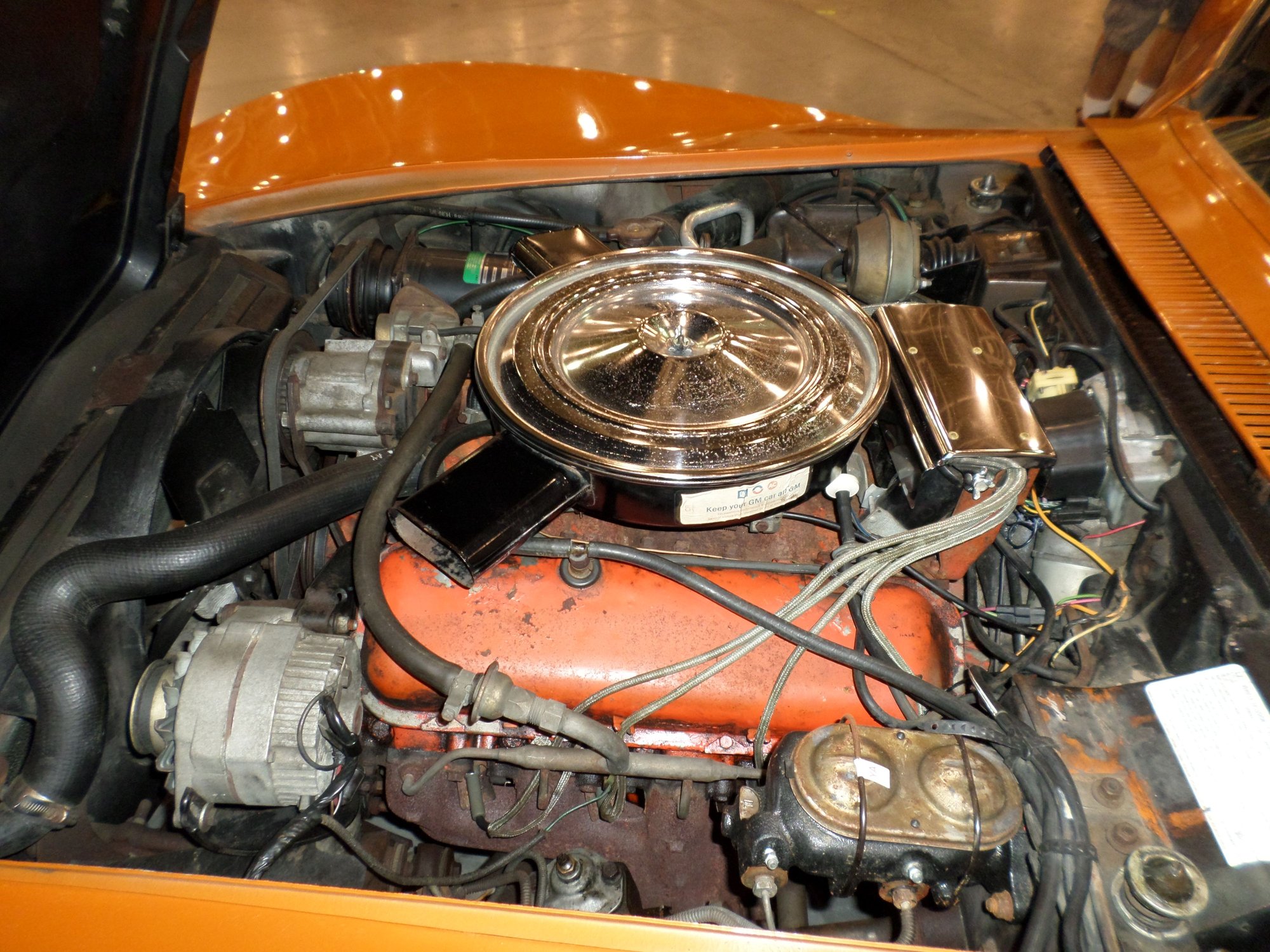

1973 master cylinders were painted a gloss black. They were painted then the were machined. Over time the paint would slowly be removed due to brake fluid. Any machined area would start to rust.
7T1vette
Those are Bloomington judging guide lines as it left the factory. NCRS is delivered to owner after normal dealer prep.
Photos are from very low mileage unrestored 71 and 72 Corvettes
