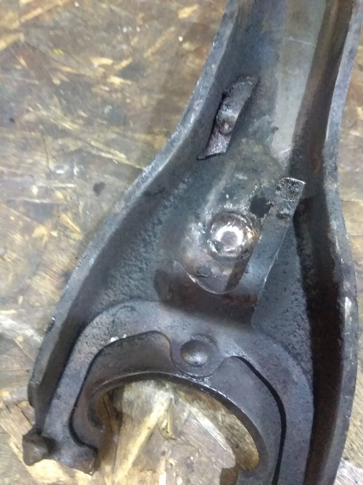

Ok so I was able to get the transmission out today (still working on the bell housing and clutch, hopefully will have time tomorrow). I had difficulty getting a socket or wrench on the middle side bell housing bolts. The old throwout bearing is very noisy (spins around fast/easily and sounds like it's full of rocks). I'm going to install a LUK clutch kit but will be scrapping the plastic throwout bearing (ordered SKF N1488 as a replacement) and will also be scrapping the magnetic pilot bushing (replacing with National PB656HD). I am also going to order a new clutch fork and ball stud. I was wondering if the Corvette America manufactured ones are any good. Thanks

I experinced this exact phenomena about 35 years ago. Turned out the pilot bearing/bushing in the flywheel had siezed (hope I spelled it right) on the input shaft.
The input shaft will then not release completely from the flywheel no matter how you adjust the clutch. So check the pilot bearing and the front part of the input shaft for any damage.

Thanks for all the replies and advice. It looks like this is the problem (I hope that is it anyway and not an additional issue). Waiting on parts to arrive and then I can get back to installing new clutch, pilot bushing, clutch fork, Ball, throwout bearing.
