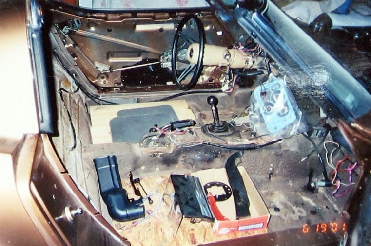

I am NOT tearing my dash apart again to replace the evaporator/dryer! If that is a must then I’ll do without A/C.

Thanks, If I could get 50 degress on a 90 degree day, I'd be happy. Why? Because the wife would be happy!
If I had a time machine and could travel back in time to this point in my restoration then I would do the whole system.
My back still hates me for this!

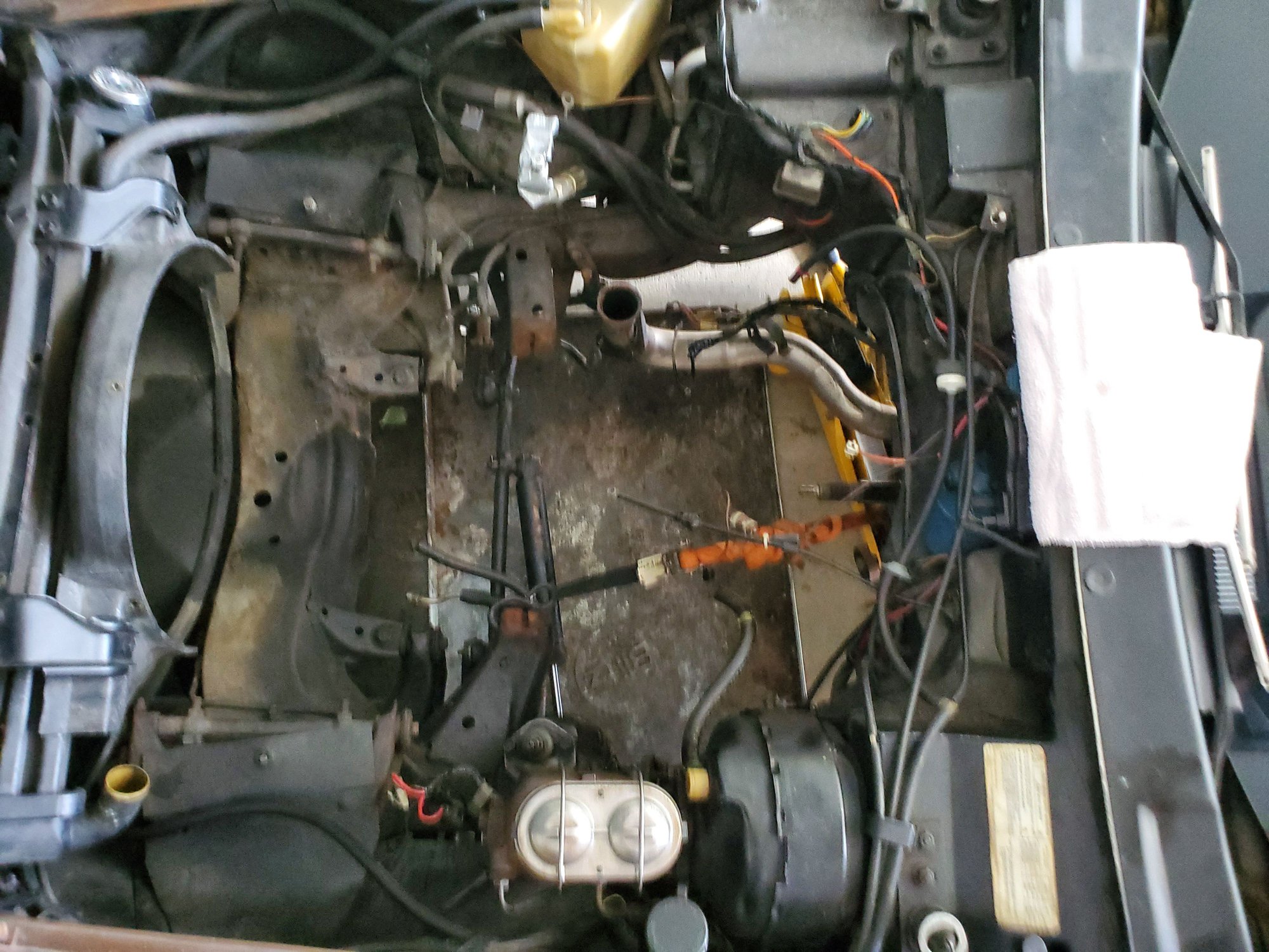

I just had the hood off and the radiator/condenser moved out of the way for the engine removal last summer.
Did not want to do that again because I actually wanted to DRIVE the car this summer instead of always working on it.
