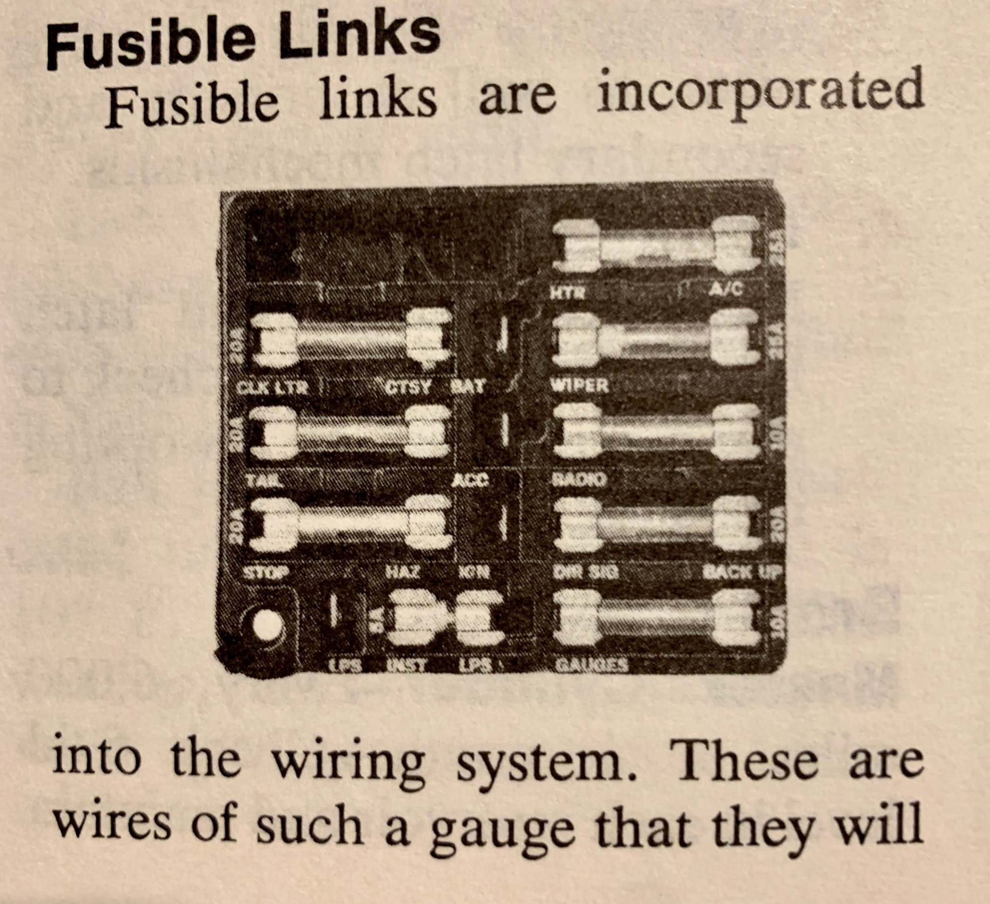

Did you check the fuse? My gages went dark because of a short in the hot wire to the cigarette lighter. On bottom of the fuse box you should see a spot marked “ inst Lps “ it’s the smallest fuse in the box, a shorty, only 5amps. Check that fuse for continuity, if it’s blown replace the fuse, easy fix...
BTW, turn the headlight switch counter clockwise for full intensity...

Yeah thanks. That’s the first thing I found wrong. I have an 80 with blade fuses located in upper left corner of fuse box and a bitch to get too. Found multiple bad bulbs and sockets. While replacing I decided to change both printed circuits (speed/tach and gauge cluster). Cleaned up some rust spots and everything seems to be working. Added bonus power antenna now works too. Now just to get all those parts back in the dash. Hopefully this afternoon. Thanks for your reply.
