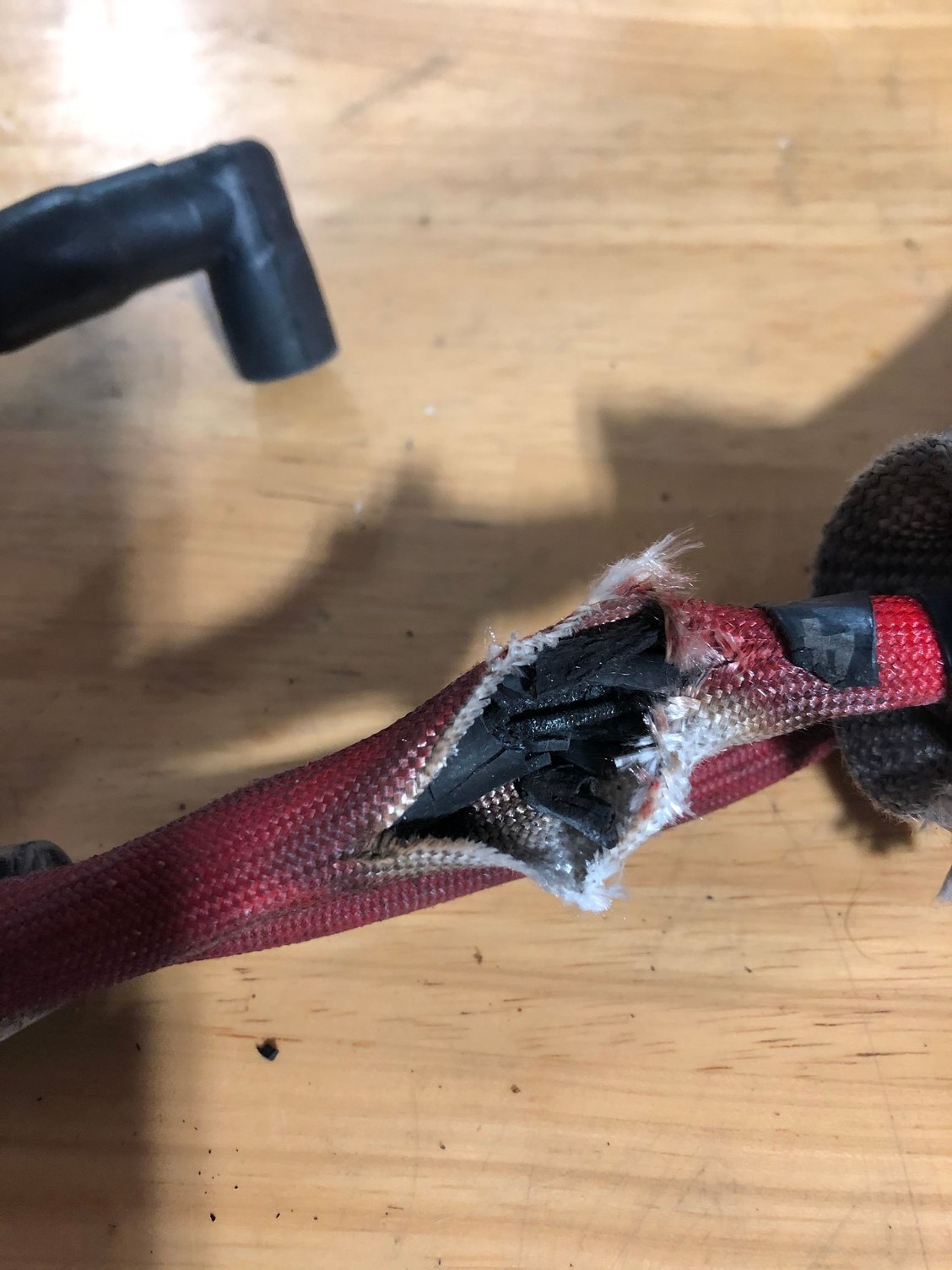

So after I FINALLY got my car to run an 8 second 1/4 mile (8.89@157) the other day... I swapped the tires and started going to the local cruise-in deals we have. On the way home one night I decided to lay into it a little and was rewarded with some popping and banging. I "thought" I had actually heard some on that last run...but wasn't sure.

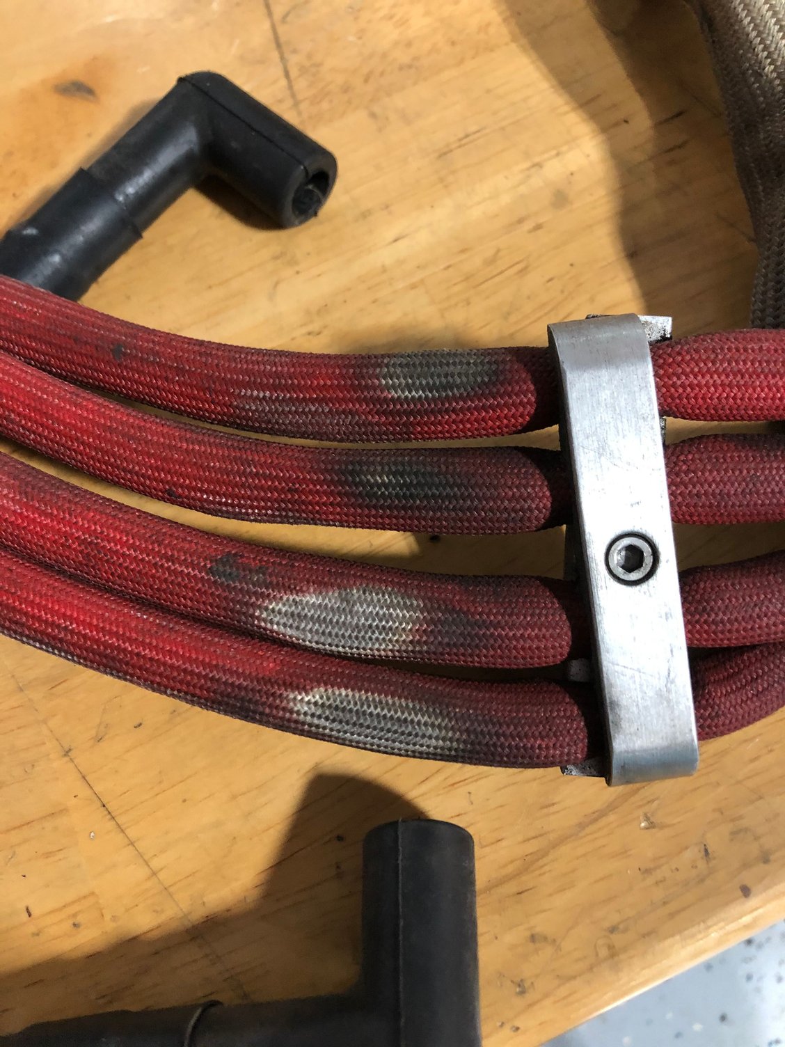

I started checking things out and noticed some white spots on the heat sleeve insulation over my plug wires. First...let me tell you my plug wires run under the headers between the block and headers. I just like the way it looks a lot cleaner. But of course things get a LOT hotter in there especially with the turbos cranking hard. Anyway...the heat sleeve wasn't melted or anything...just had changed color in some spots from the heat. But as I felt along the wires I could feel distinct depressions inside the sleeves in the wires themselves. The heat sleeve was fine but the wires inside were melted!
Here's a pic after I cut one open.

strange how it lines up like that right after the clamp. Do that heat marks line up with a header tube? I wonder if the clamp is transferring heat through the insulator and causing it to remain hot like a reverse heat sink...

I agree, those aluminium clamps may be pulling heat into the wires. I loom mine with tie wraps but I don't think they'd handle your heat.

Originally Posted by ajrothm
Damn!. Those wires got crunchy. Definitely have to keep an eye on that. I also run my wires under the block/behind the headers. I made some brackets/shields to help keep the wires away from the pipes and tighter to the block. Yours with the turbskis is probably REALLY tight under there.
I'm sure things get pretty toasty in there....those headers are probably glowing on a hard run! They have been there since I put it together with the turbos...so can't really complain. That's about 8 years ago....
Yes..the wires were getting up against the headers in a few spots......it's pretty tight in there...I tried to re-route them a little this time. The aluminum separators are away from the headers and don't touch.

wonder if its possible to bend up some thin gauge metal, bolt it to?? Just to keep the heat away. 8s..you are a badazz man. And driving it on the street!!! The garage it guys are missing out on the fun
