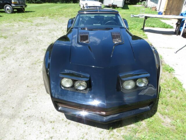

A question for the techs out there.
My 74 350ci Twin Turbo seems to be running a bit hot. About 210*. Currently have a 3 core aluminum radiator. Considering installing a supplemental electric fan in front of radiator. Comments welcomed by All.

“IT IS LIKE DRIVING AN F18 SNAKE! Handling is as responsive as A BLINK OF AN EYE.”
to see a gen 1 boosted rather than another lsx. Did you do that yourself, what brand/size?
car is HISTORICAL piece. Built in 1977 by Bob Larson of Larson’s Engineering out of Livonia.MI, Carl Holbrook of Holbrook Racing Engines and Dave Schilk of Ford Racing. Car was garaged for over 42 years. Bob Larson designed the Custom Twin Turbos to function using stock C3 hood. I changed over to FITech injection system and hood is being reshaped to accept 4.5” height increase as you read this. Lots of other extras added in last 3 months. MSD ignition, RideTech front and rear coil over suspension, front and rear anti sway bars, BFG Radials 15x 10 ( car had original 77 tires). Entire car had only 2 miles on it when purchased.
History details are available via GOOGLE. “74 Twin Turbo American Pickers.
