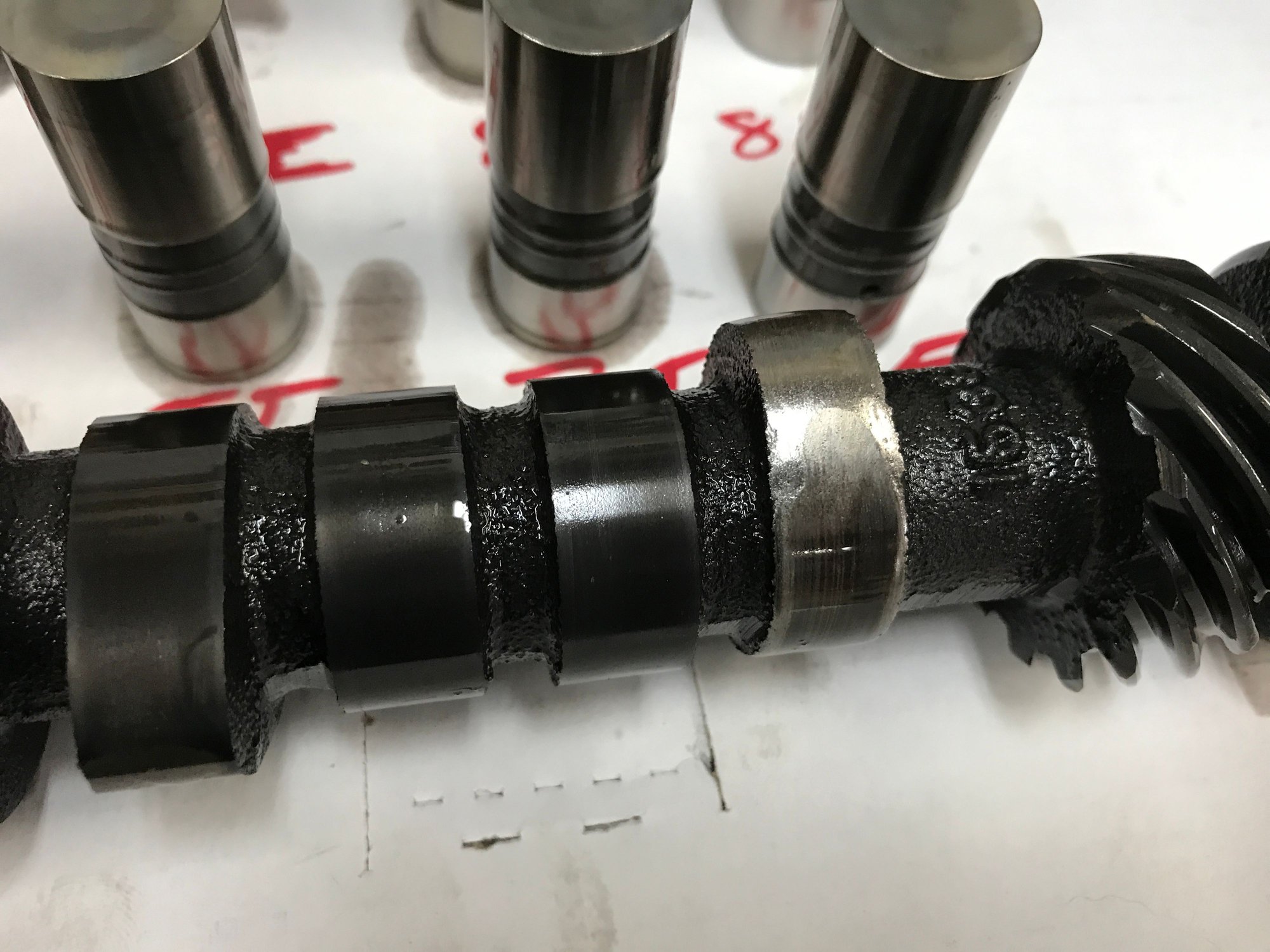

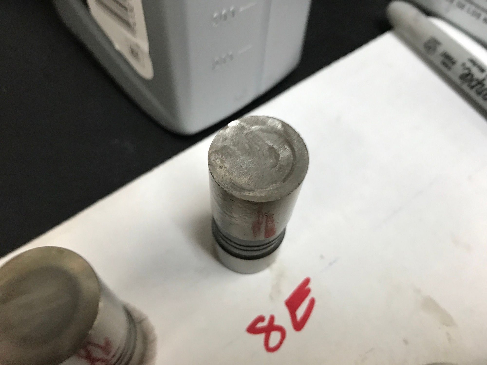

Dropped the pan today. The lobe is gone, and so is the bottom of the lifter. The second photo shows the bottom of the lifter when it’s pulled up to the point where it jams. The other side of that lobe doesn’t look too good either, but I didn’t take a photo of it.

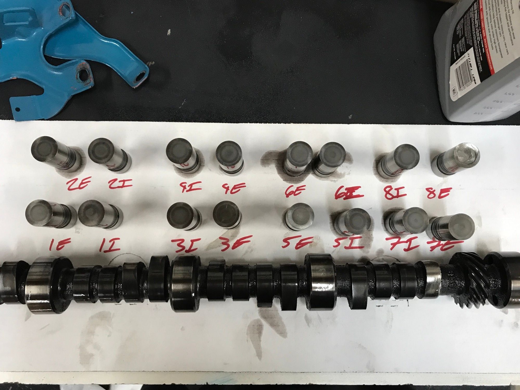

I pulled the motor out today and tore it down. The only issue I had removing the cam was that I got ahead of myself and forgot to pull off the fuel pump, so the push rod was preventing it from coming out. I just had to pull that one lifter up until it bound up and the cam cleared it no problem. Main and rod bearings had some wear, not through the plating, but they looked pretty shiny. Also saw some wear on the cylinder walls, with 6, 7, and 8 being the worst. Some light scoring I can just barely catch with my fingernail and one more severe scratch in #6. I saw some of what looked like debris embedded in piston skirts, but I’m not sure if that’s what I was looking at. I don’t think I could get a photo of that.
The lobe lost about 0.140” on the shorter side of the lobe, and the lifter lost about 0.060” on the shorter side.

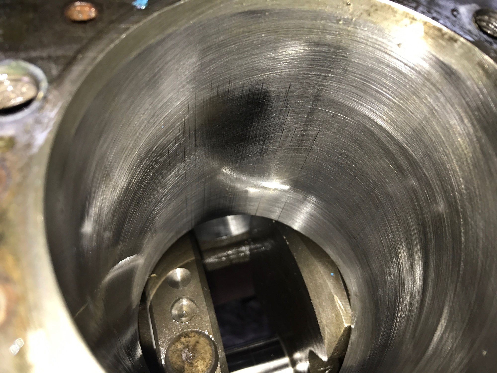

I know roller cams can go bad too. I've heard of roller lifters rotating and wiping out the cam, hopefully that won't be a future thread of mine. I'll probably keep running VR1 oil because of the mechanical fuel pump push rod. As far as quality lifters go, I've read the Morel 5372 lifters are good. I had been looking at a Howards cam and lifter kit, looks like it includes Howards 91164-N lifters. Are their lifters any good or should I plan on buying just the cam and buying different lifters?
What do you guys think of this? All the cylinders have some scoring but 3 of them look like this. They're not very deep, but I can catch them with my fingernail. Does this need fixing or can I leave them alone?

Morel lifters are expensive . Comps lifters are made by I think stanadyne and have been good.
I wouldn't get hung up on the scratches, but I think the cam was more human error than anything.

I dunno what else may be lacking, but unless you rebore it again, suggest do not spend much on putting that block back together ,,, certainly not a decent roller setup or better pistons or better rings.
As I suggested last week to another here ... perhaps find a rebuildable core roller L31 iron vortec.... and build that ... then the gent quickly found one ... in Belgium, no less!
note crank looks as if it's been rebalanced since new.
