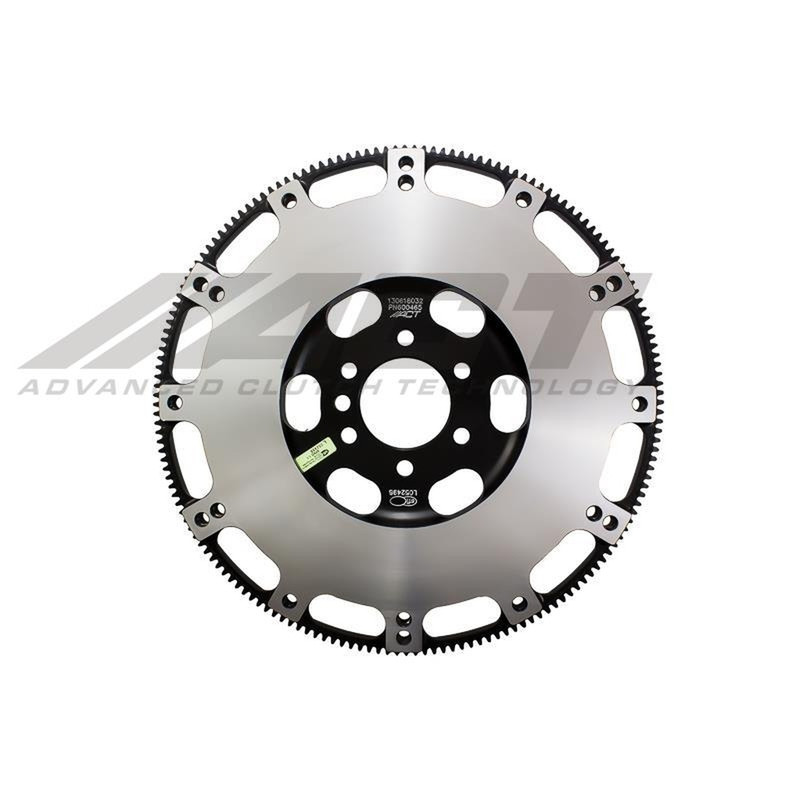

What I ended up with is something like this, I'm out away from home so I don't know the exact part number. But the tko 600 is a 26 spline 1.125 input shaft for ford. You just need to call these guys. This is rated for 950 foot pounds of TQ and 1000+ HP. I have a manual pedal and it is easy on your leg. Very easy to shift
https://www.summitracing.com/parts/acl-t2s-f03

Centerforce has a light metal clutch setup, which includes a lightweight flywheel. LMC is the acronym they use to find it in their catalog. Advantage is lower rotational moment of inertia. You get quicker revs and don't waste horsepower by spinning up heavier metal. I've been happy with it in both SBC and LS versions.

how can you not love a 15 pound 168 tooth flywheel

12lb, 153 tooth.
