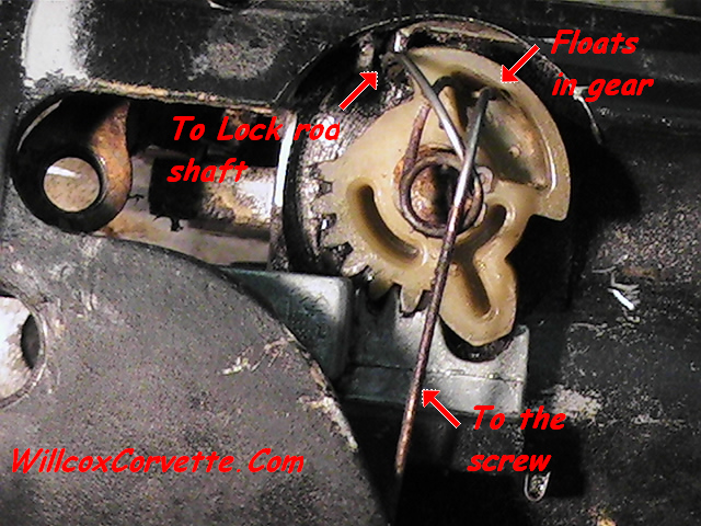

However, slop in the actual housing where the cylinder is can cause issues as well as a deteriorated rack assembly. The rack is what drives the rod that controls the ignition switch and if I had to guess this would probably be the culprit of your issue. The rack has a plastic gear that drives a link that the ignition switch control rod hooks too.... Hopefully the pictures below will give you a better idea.
Another thing that could cause this issue is the upper collar being torn on the mast jacket so that question would be easy to answer by asking you if the column has play from side to side and up and down.... If so then a major repair would need to be done.

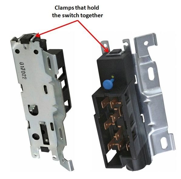

One other thing to check related to the switch is - if the switch itself is still functioning as intended. The C3 ignition switch is made up of two major assemblies with some internal moving parts sandwiched in between. The switch assemblies are held together by a couple of clamps on the ends of the switch which literally clamp it together.
Over time the clamps can loosen allowing the two assemblies to partially separate, which can inhibit the functionality. Also over time, the contacts inside can get corroded and there is some metal transfer (such as occurs with a set of points) which can inhibit it's functionality. I have had both happen in the past and only discovered the problem after removing the switch (to replace it with a new one). Once I saw this, I fully separated the two assemblies (just to see how it worked) and discovered some minor corrosion. I cleaned the contacts and reassembled the switch ensuring it was fully clamped together, and it functioned perfectly.

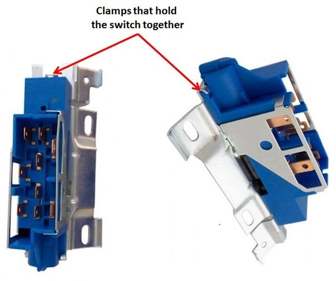

I've noticed that some of the newer ignition switches use a clamp arrangement that locks the two switch assemblies together making it almost impossible for them to separate.
Newer style ignition switch...
Good luck and I hope this saves you some time and aggravation...
Incidentally, Ford used a similar style of column mounted ignition switch as this on some of their 80's and 90's vehicles. Apparently, as the switch would separate, arcing would occur internally and may have resulted in fires. This resulted in an NHTSA mandated recall to replace the switches.
GUSTO
