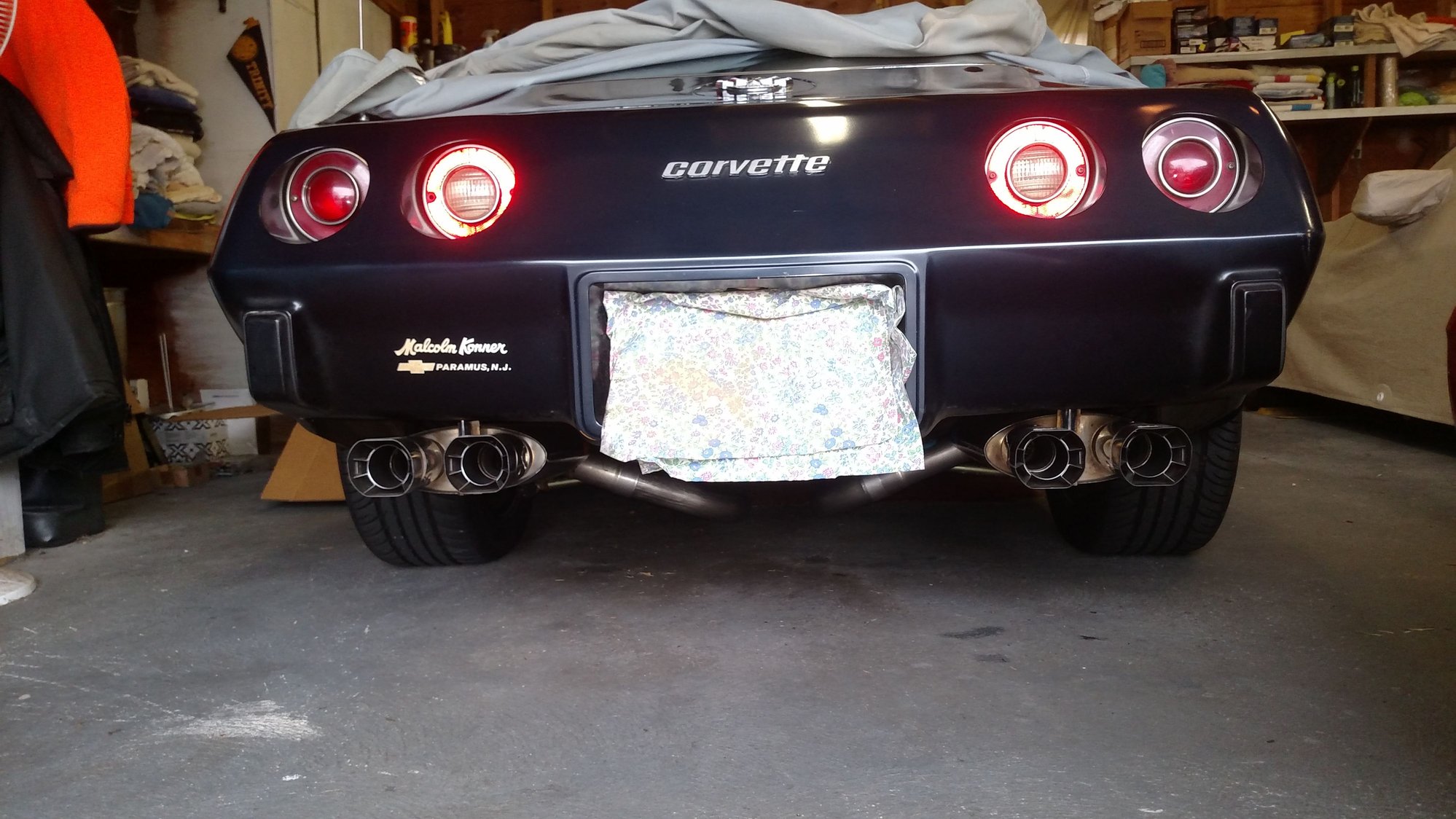

These are Magnaflow 2.5 inch mufflers tucked up where they belong. The outlets are directed down at 45 degrees and the chrome tips are added. BTW - Magnaflows are straight thru. Best for performance.
