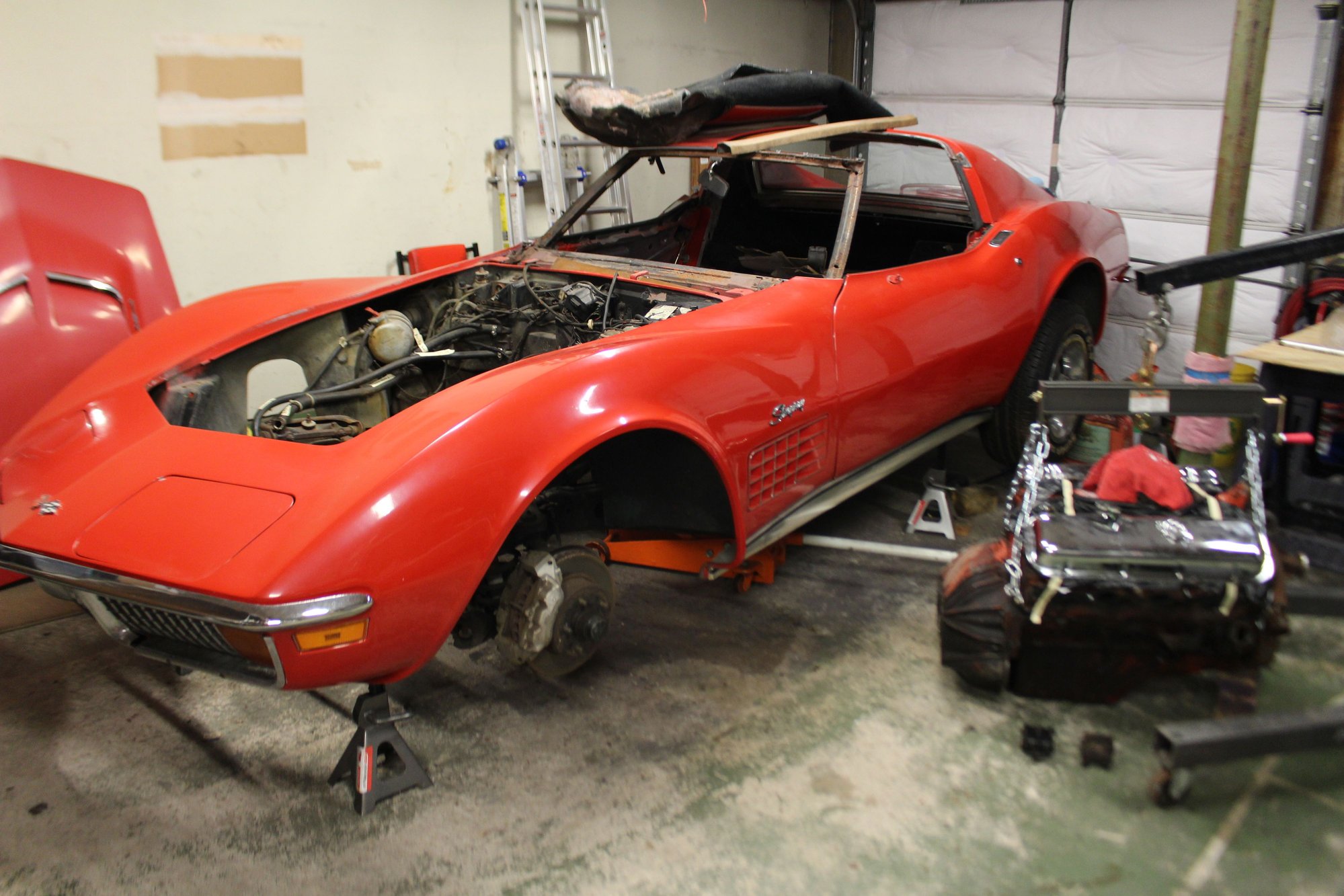

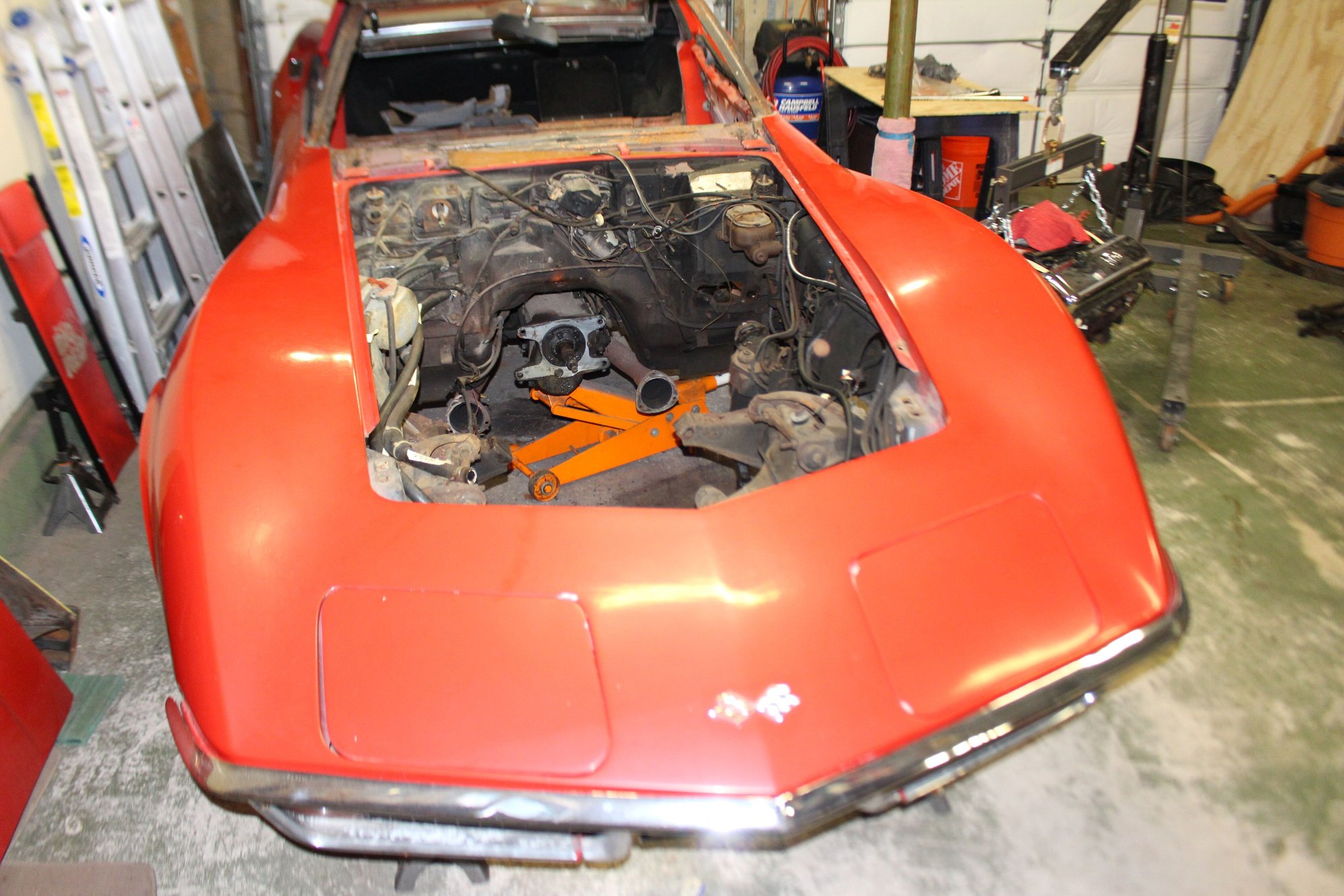

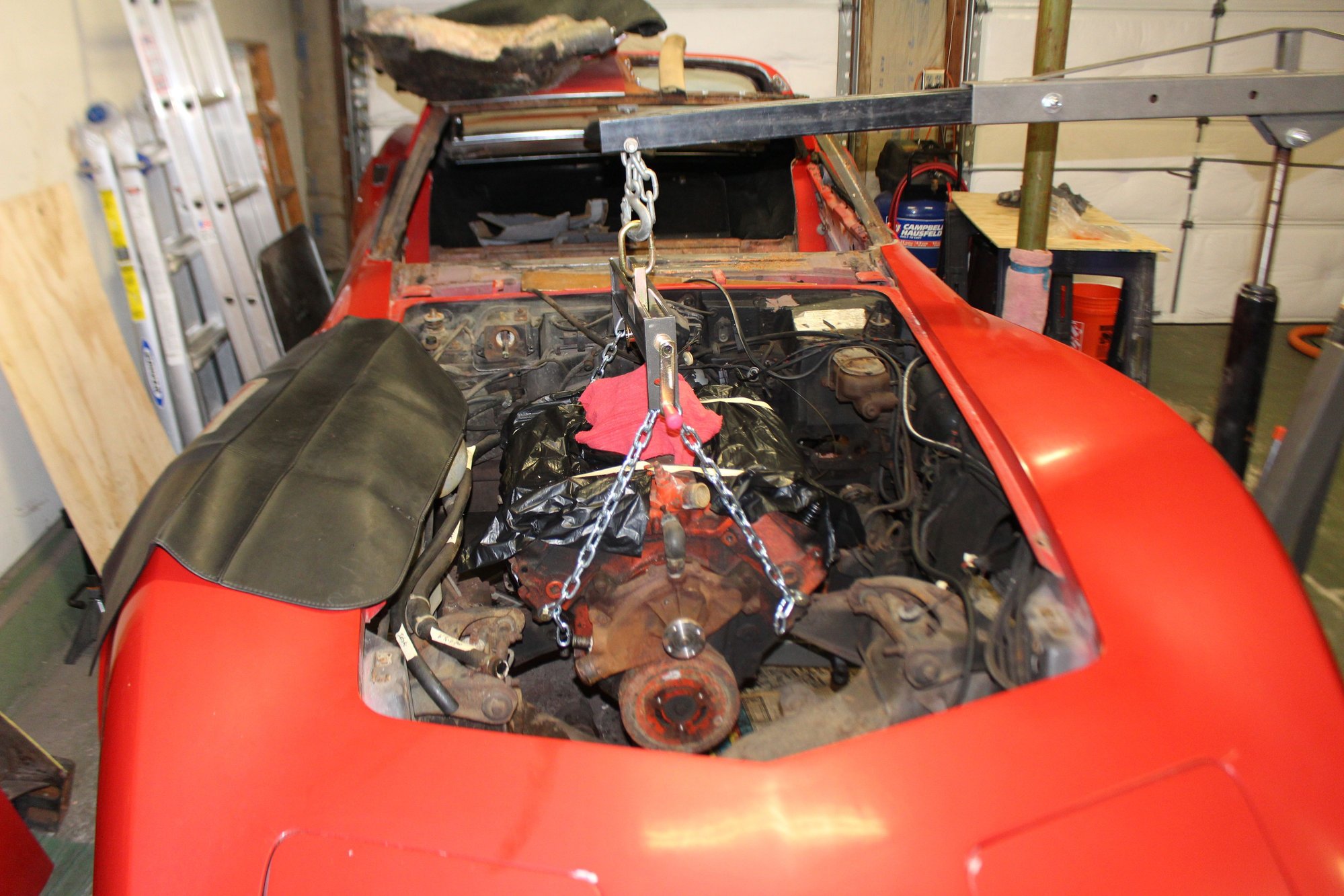

Just did this on my 72 BB.
A lot of room to work with hood and rad support off
If I were to do it again, I would bolt the rear chains somewhere else.
Left trans in, 1 rear bolt still in rear of trans. Engine leveler was not really required, but nice to have. Just tugged forward a couple inches and off trans.
Lowered car to top edge of lift legs for clearance under hanging lights maybe 7ft
Worse part was my nerves as I watched the 650lb lump sway over the top of my fiberglass fender! LOL
Notice the engine mounts on the floor. Why did I even bother to unbolt them? They both fell apart in 2 pieces.
Portable Harbor Freight style, long enough for side, not the front
