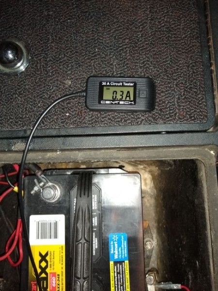

DISREGARD THIS REPORT. I AM ONLY KEEPING IT HERE FOR HISTORICAL PURPOSES. THIS METER WILL NOT READ BELOW 0.1 Amp.....
Here you go. 0.3 amps. Not the most accurate metering system but it works. The good thing about it is that it will read up to 30 amps so I cycled it through turning on the interior lights, all the lights, the radio, and even the electric fuel pump. I suspect it may be slightly lower than 0.3 amps, but the accuracy this meter is limited to 0.X amps.
I need to order a fuse for my multimeter so I couldn't cross check it. I'd forgotten about that so it's a good thing.... well, I suspect the fuse.

I suspect that anything much higher than 0.3 amps is too much, and anything near 0.5 amps is way too much.

Thank you so much for performing this. Now, if your setup reads correctly, you have 0.3 Amps draw which is relatively a big number. Mine is 0.047 Amps (not 0.47 Amps) which is about 1/6 of yours. Can't really tell how that battery can possibly turn your engine after few weeks of sitting with that much of drain...Anyway, I picked up a yellow top Optima and see how it goes. These suppose to have better resistance against being discharged for long times.

Good point. I don't think that meter is accurate down low. I'll have to get another reading when I get my multimeter working. I couldn't get this thing to read anything until I started some loads and then I would turn them off and it would settle here before it went to zero.
Sorry about that.
At least I found out my contraption works to read fuel pump amps and whatnot..... I ordered some fuses for my multimeter.

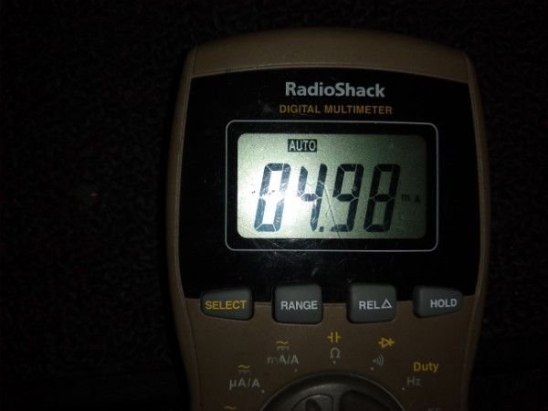

Just to close the loop. Got the ammeter on my multi-meter working. My car reads 4.98 mA with everything secured. I do have EZ-EFI and a stereo with a memory power lead. I can easily start it after a month of not using it. Per google conversion 4.98 mA = 0.00498 Amps
And, NO, I do not have a clock sucking up amps while secured. But nevertheless, even if I had a Clock using .025 amps while car is off, then the total load would still be less than .030 amps (0.02998) amps total.
