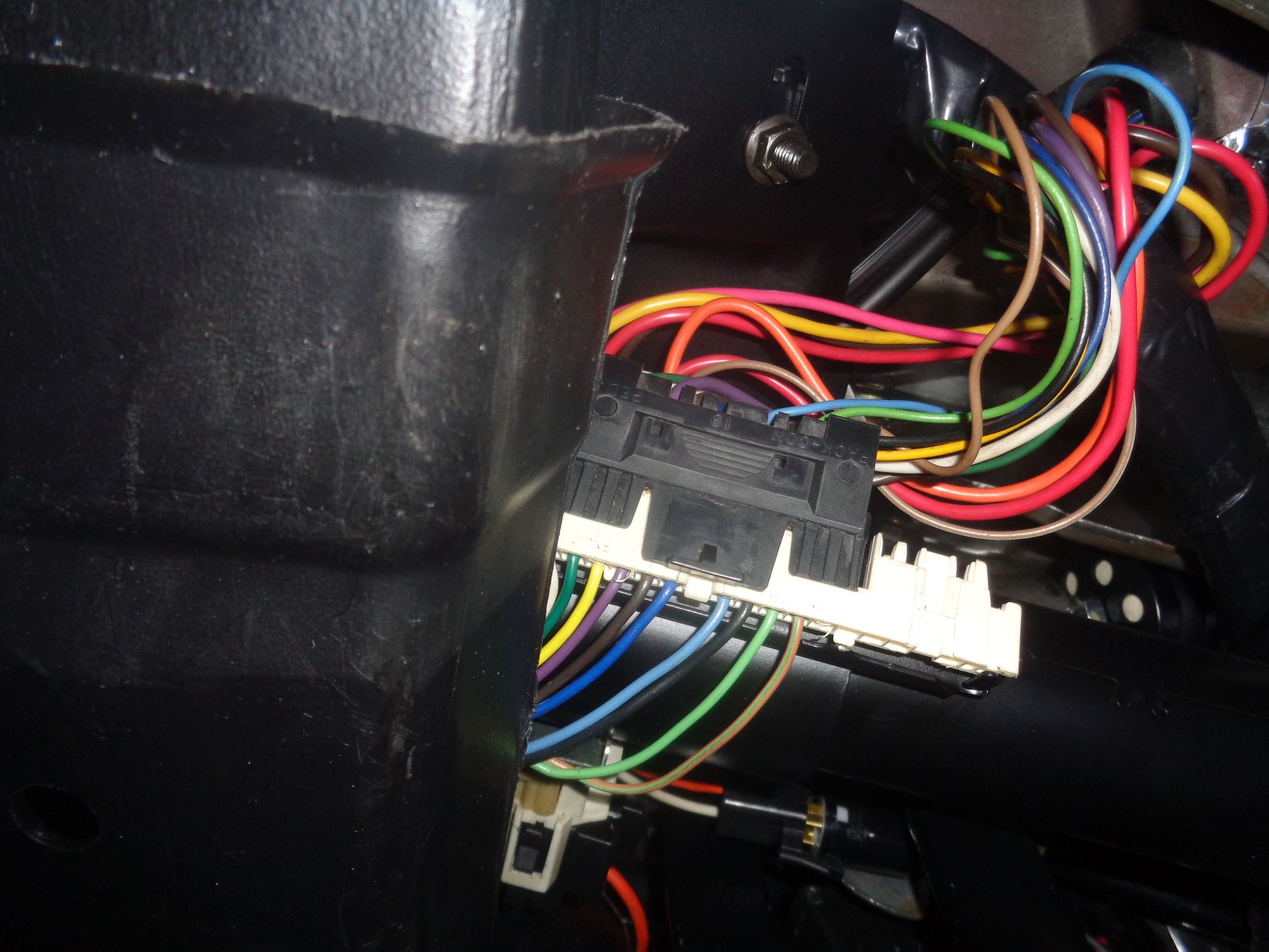

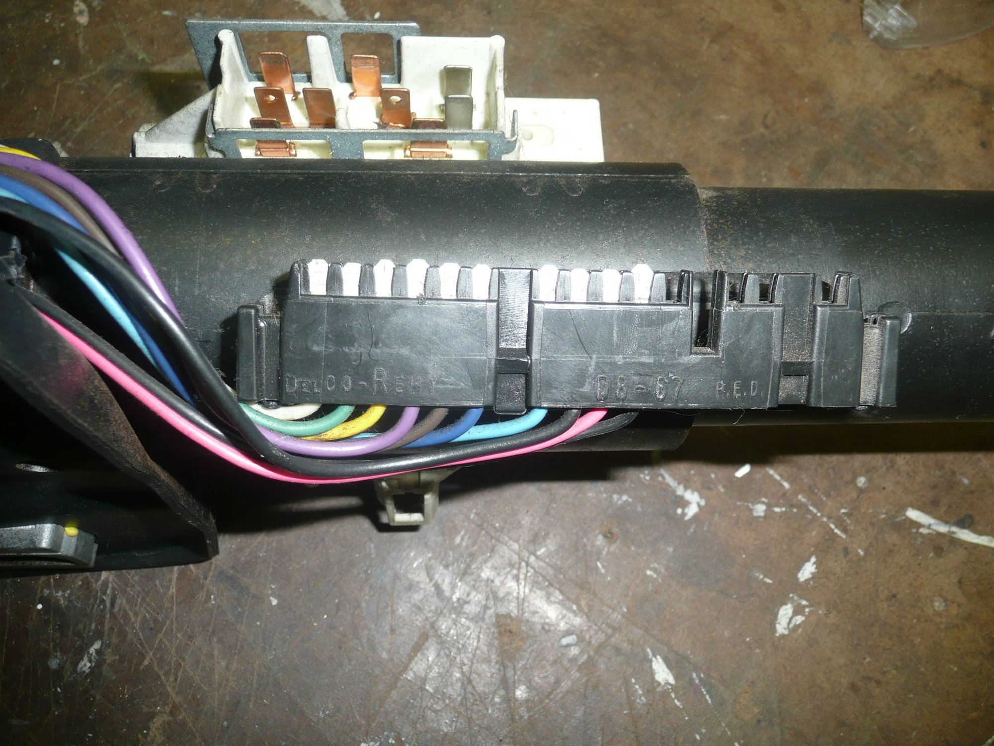

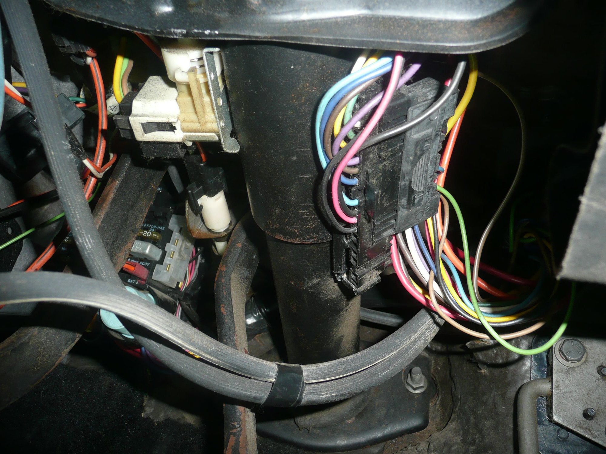

It just pushes down, and latches on the tabs of the column bracket. Pictures should help.

VERY helpful. Thank you! There are two female harmonica connectors. How are they secured other than plugging into the connecter in your pictures?

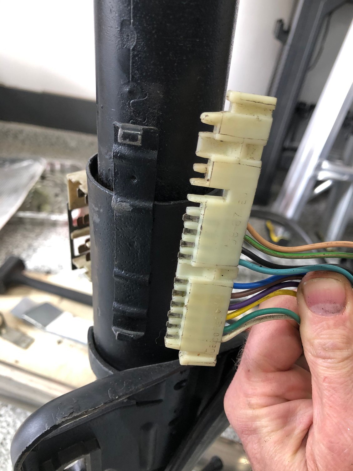

Found a better picture. The latching tab is in the center.

I think I have something wrong. Def not going to clip in.

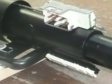

It comes down from the top. Maybe this picture will help.

Thanks all! Helped solve the problem.
