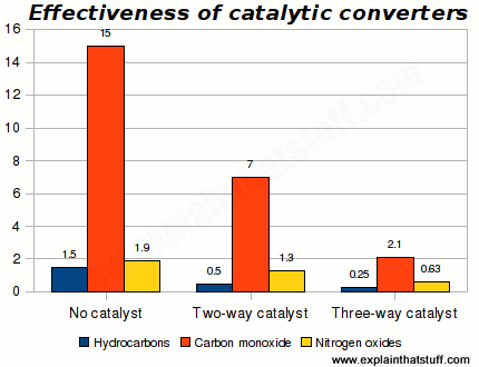

IDK why people are so against catalytic converters. It's a pretty amazing invention. They don't reduce exhaust flow as much as people think. Obviously they use them on high HP Hellcats, Vettes and Camaros. They cut the CO emissions dramatically w/o any maintenance. Kind of foolish, considering an owner could potentially face a fine while owning, or after a sale (an unsuspecting owner could come back and demand you install a new cat and you wouldn't really have a choice -- or get turned in). That's just the kind of lousy luck I have, so I don't push my luck anymore

No one is arguing that cats on newer cars are a bad thing..they are a great addition. BUT the whole emissions fiascos back in the 70/80's was frankly ridiculous! Trying to control emissions on a GEN 1 SBC back in the day with engine builds that were imprecise with loose piston and ring clearances , not to mention carbs versus Fuel injection, was like swimming upstream. The emissions technology was very crude and archaic.
The only car I own with no emissions is my 78 C3. All the other cars including my 1994 mustang GT (2 magnaflow pre cats and 2 magnaflow high flow cats), 10 C6 Z06, even my 01 grand prix with 225,000 miles on the motor has a it OEM cat and a magnaflow cat back exhaust. There is no reason to remove the cats on modern cars since the performance is not affected BUT back in the day the emissions created performance and driving disasters! Let's not worry about emissions on 40 year old cars...it's irrelevant.
BTW-most modern cars put out 0 carbon monoxide (incorrectly depicted in the graphs above). The major by product of combustion in a modern vehicle is very very small HC (about 10-20 PPM, some as little as <5 PPM), Water, and CO2......no carbon monoxide......
