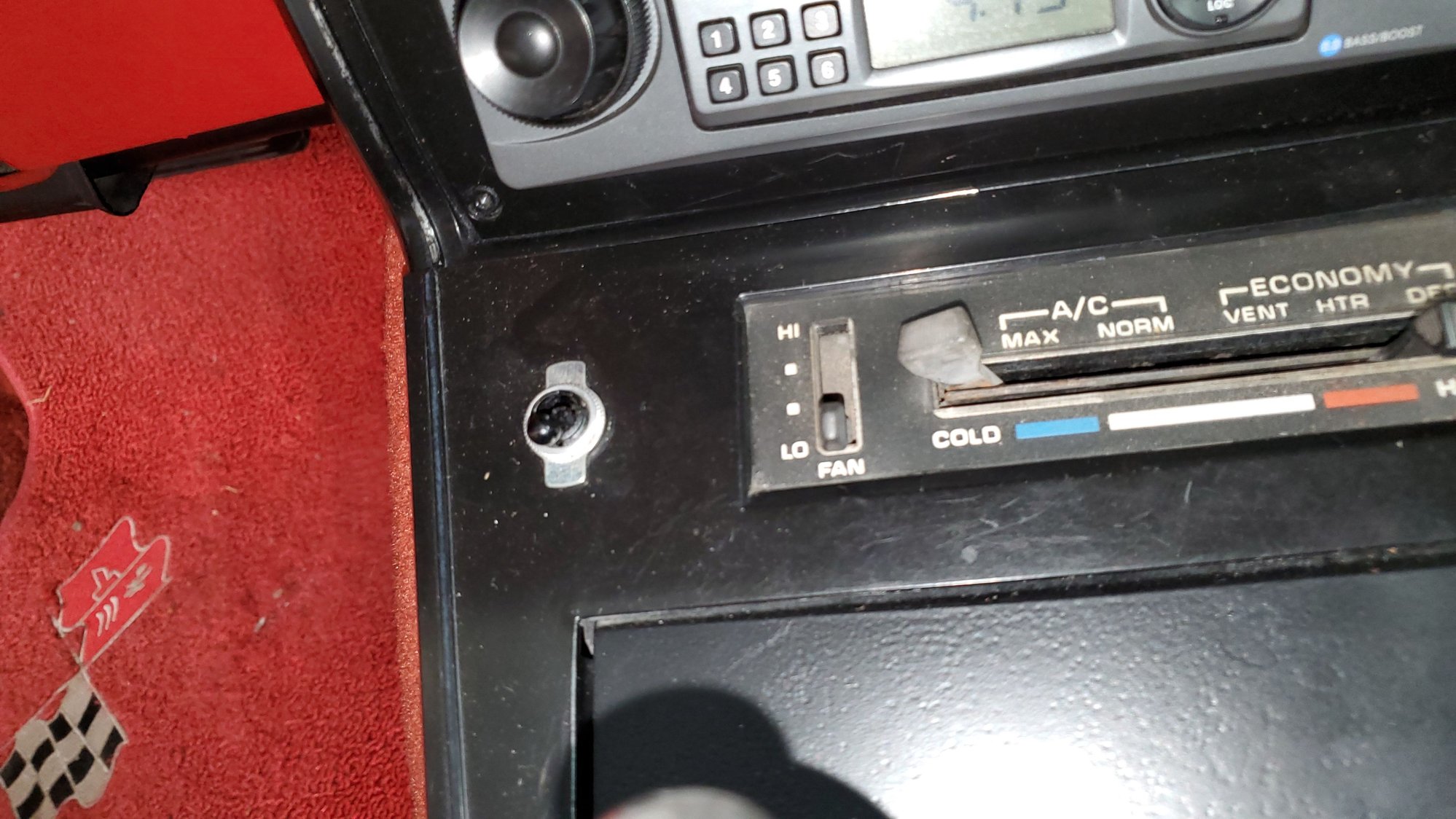

Hello,

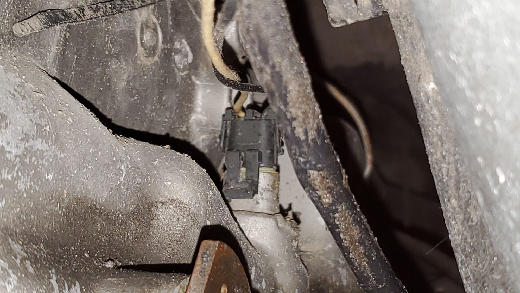

I have a 79 automatic Corvette, that has an unknown on/off toggle switch beside the air conditioning controls. I chased the wire to a plug into the driver side of the transmission. Does anyone have any idea on what this could be?
Pictures added below.
Thanks,
Scott.

Probably a torque converter lockup control manual switch. Someone may have installed a 700R4 trans.

That,s where the rear window defroster switch would normally go. If you have the defroster , I would not leave the switch on for extended times
Thsnks Mate.
No window defrost on my vehicle, and the wire definitely goes to the transmission.

Trans lockup disable.
Drive it at 55 mph and engage / disengage the switch, watch your tach while doing so.

No Torque converter lockup if OEM turbo 350 tranny. If it is a 700R4, easy to identify if the car has 3 (Turbo 350) or 4 speeds (700R4). If it is a 700r4, then maybe it is a switch for the TQ converter lockup to disengage that functiomn.
I'll take a stab at that switch being a manual on/off switch for the reverse lights to manually put the reverse lights on when not in reverse??

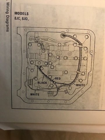

You are correct about the 8JD code for the 81. It looks like someone may have put the lockup trans in his 79 and added the toggle switch to control the converter. Definitely not a factory 79 install. Here is a picture from the 81 GM Service Manual of the inside of the lockup 350 valve body and TCC wiring harness. Just under the "More Standard Equipment" in the brochure, talks about the converter clutch feature.

Thank You, sir for Good Info ! Clear from svc manual valve body pic the wiring's there for lockup while sharing same pan profile as non-lockup THM350. Brochure's reference as well.
