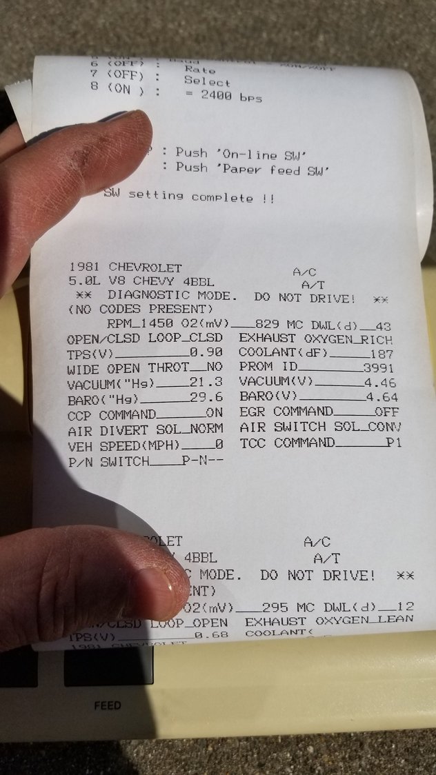

For de-bugging purposes this print-out illustrates which real-time ECM readings are available from an 81 Computer Controlled Carb (CCC) system via a scanner (Snap-on in this case).
(fyi, example is a Caprice)

I had no idea an ECM of that vintage was smart enough to dump data.........I was today years old when I found this out!
