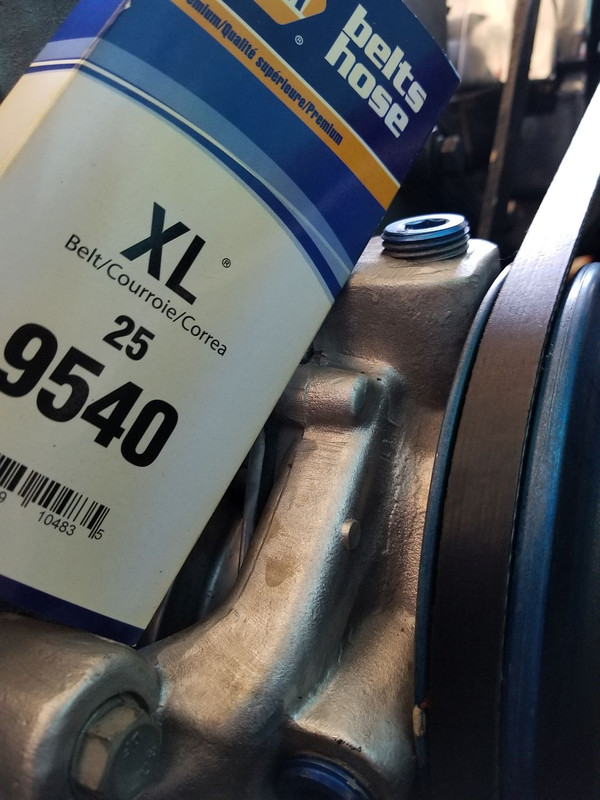

I had to get a 53.5 inch Crank/water pump/alternator V-belt today and it was almost discouraging with the lack of parts for our old vettes at chain parts stores. I finally found a high performance correct V width & angle online through NAPA. the belt is designed to get tighter as it heats up.

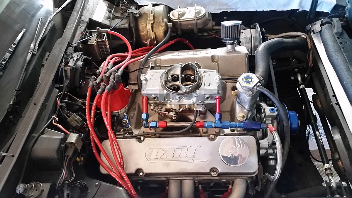

I caused the problem. Old belt and the first sunny 70ish degree days. Vette has been down for the winter. So I took it off the stands and drove over and filled it with Super Unleaded and took and afternoon test drive on the lonely highways here in Nevada. I ran it up to the rev limiter through the first 4 gears quite a few times and cruised at high speed in OD with my 4.11 rear. It just purred along. I got home and looking under the hood and what ever reason the belt I had didn't spit off, it was flipped and riding around on the thick side. I have deep grove March aluminum smaller diameter crank pulley. kinda stock water pump diameter and larger alternator.

I did have a memory refresher on what the numbers mean. Example for a 79 L-82 corvette from Napa:
The last three digits of the 257530 Stands for 53.0 inches Because of my altered pulleys I bought three sizes in one trip the 53 inch and couldn't even get the belt on with my bigger alternator against my taller valve covers. The 257540 being 54 inches would work if you wanted the alternator out at the end of the upper arced tension bracket. The 257535 fit perfect at 53.5 inches and I just return the other two

I was wrong on the numbers corresponding to exact outer circumference. but for this brand they are close. This belt of mine on the package is 54 and 3/8ths. but the important thing is the top width which is 12.5/13 mm so it fits our old pulleys very nicely.

The Napa 257535 fit, but it was on 10 mm wide and rode further down inside the pulley's. It would be harder to jump at 7500 rpm, but I think that the larger 13mm show above is much stronger. Because it rides out in the pulley it had to be longer.
Stock 79 l-82 lists the 257530 which is about a 1/2 inch shorter
