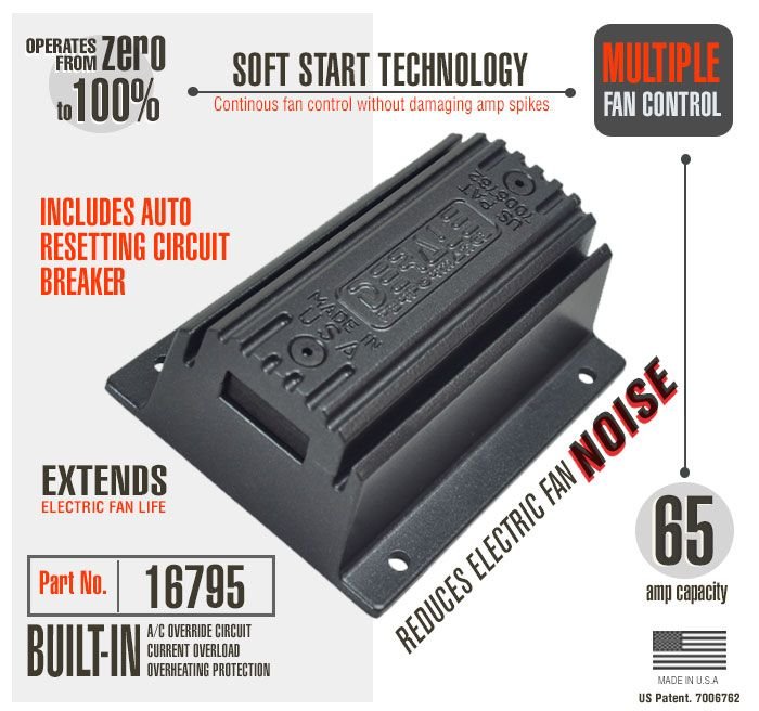

This PWM controller will work- about a buck and a half-
Varies the speed as needed- soft start plus uses it own sensor stuck on the "cold" side of the radiator.
And if you want- have a WOT switch that shuts down the fan(s)
I have my electric speedo output of my TKO500 connected to my ECU so at 35MPH turns the fans off.
https://derale.com/product-footer/el...n-probe-detail
Perfect!!!! Never knew that existed, exactly what Id want. Those controllers pretty reliable? Been balking as it seems most arent, dont wanna get stuck.
Thanks Rich
Thanks Rich
This one had a sensor problem when it first came out- they were using a through the fins piece- now they have changed to a new style for the past couple years.
Some guy designed this piece years ago- can't remember the name he was making them under- sold the design to Derale . Seems to be the most weatherproof & well built one I have seen.
Summit Racing sells them- so if you have a problem with it-they have always taken care of me.

Ill try that, perhaps wiht the controller this fan may just do it. Thanks again
