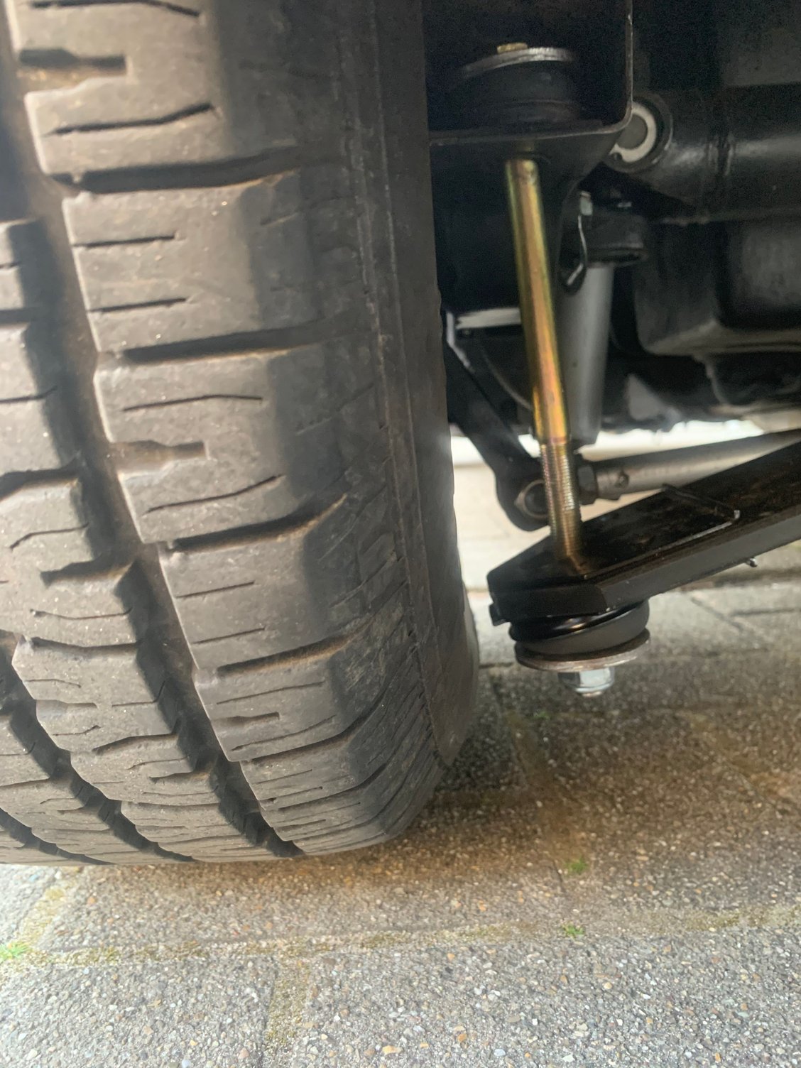

Yikes also....2-3 inches of deflection down low. Looks like you will have to bite the bullet and take Zip up on their offer to exchange. I feel for ya.

That looks a an autocrosser on road race slicks so probably pulling 1.25G. .Thats exactly why you want a big dia & wide wheel and really short sidewalls while racing.
You'd be lucky to get half that deflection on your street car, but that would still cause you big tire sidewall problems.
The only safe thing to do with it is to return it, unless you like your *** high!
Check my other thread for specifics but I would recommend a Van steel composite spring, if that's what you want.
Either their EZ-ride 200# or their 300#.low arch. Both should give you stock ride height with 8.0" spring bolts.
https://www.corvetteforum.com/forums...composite.html
Good luck!
Lee

Thanks Gents, and @leigh1322 in particular, for his insight and starting a new, clean, comprehensive thread with lots of clear information that I wish I had before starting this.
I am very uncomfortable with the installation. It looks unsafe and I shouldn't drive it. Fortunately there is a full lockdown here so I cannot drive it anyway
I can't return the spring as, in a desperate attempt to make it work, I trimmed the top plastic locating pin so it would slot in the bottom of the carrier allowing me to move the spacers under the spring (saving 3/4-inch ?). That just barely got me to the ride height with the nuts at the end of the 10-inch bolts.
Once my $$$ are in better shape, I will call Vansteel. Stay tuned

That tire looks like it could easily be our size, 255/60 on a 7 or 8" wide wheel, 8" of tread. At least 1.5" maybe 2" of tire movement. Sounds right and why you DO NOT WANT that rear spring TOO CLOSE to the tire. The factory tucked the spring end up inside the wheel, for a reason. Putting it down by the sidewall is like asking for trouble.
To the OP sorry for your troubles, but you are not the first, or probably the last to get bitten by that TRW spring. At least that spring didn't "bite you" in a way that would put you or your car at risk!

Wow ! Thanks !!! That’s super impressive. (Including the AN-8 fuel line and the beast under
the hood.) Those tires are deflecting enormously. Hmm. I measured to clearance with the end link and my tires. I’m at 1-inch. That deflection is more
than an inch.

Sooooo, I reached AIM wheel arch height of 27.9 inches, down from 29.5 and my half shafts are level.
To achieve this I had to place the spacer under the spring and I had to use 10-inch bolts with the nut run all the way down to the end of the bolt.
This probably will settle a little. For the moment it’s hanging a bit low for my comfort.
Dorian,
That is too close to the tire. If you hit anything in a turn that tire may deflect enough to hit that that tab on the spring. Remind me the size of those rear tires please.
My tires are 225/70R15

On this size tire, a 255-60-15, the sidewall will move laterally 1.5-2.0" under racing or hard cornering conditions. Seen it and measured it many times.
That's why we have a problem with the 10" bolts on the TRW spring,

If you are running the correct size tires the will not be close to the end of the spring. This has always been an issue for us who run wider tires, fiberglass or steel, sometimes the end of the springs had to be trimmed.
Tire Size: F70-15 Tire Size: 225/70-15
Tire Diameter: 27.10 in. Tire Diameter: 27.40 in.
Section Width: 8.20 in. Section Width: 9.00 in.
Tread Width: 6.50 in Tread Width: 6.70 in.
F70-15 was the tire size used when the car was built. I'd say the 225/70-15 he's running now now are pretty close to the F70-15. The problem with the tire being so close to the spring end is 10" bolts with 15" wheels.
