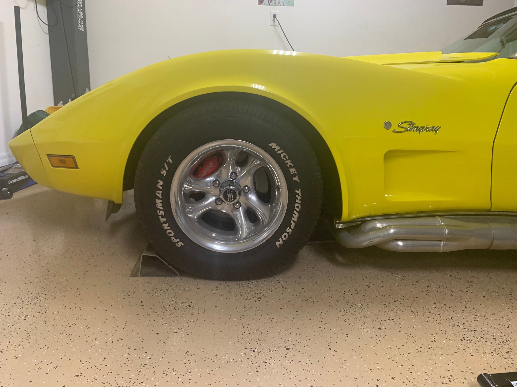

Hey All,
I just replaced my rear spring with a composite one and it seemed to me the rear was too high despite using longer bolts.
Taking advice from folks here, I loosened everything up and loaded the rear with 400 lbs of iron. I drove around with it a bit and then tightened things up.
That improved things but, it’s still too high.
What else could be leading to this problem ?

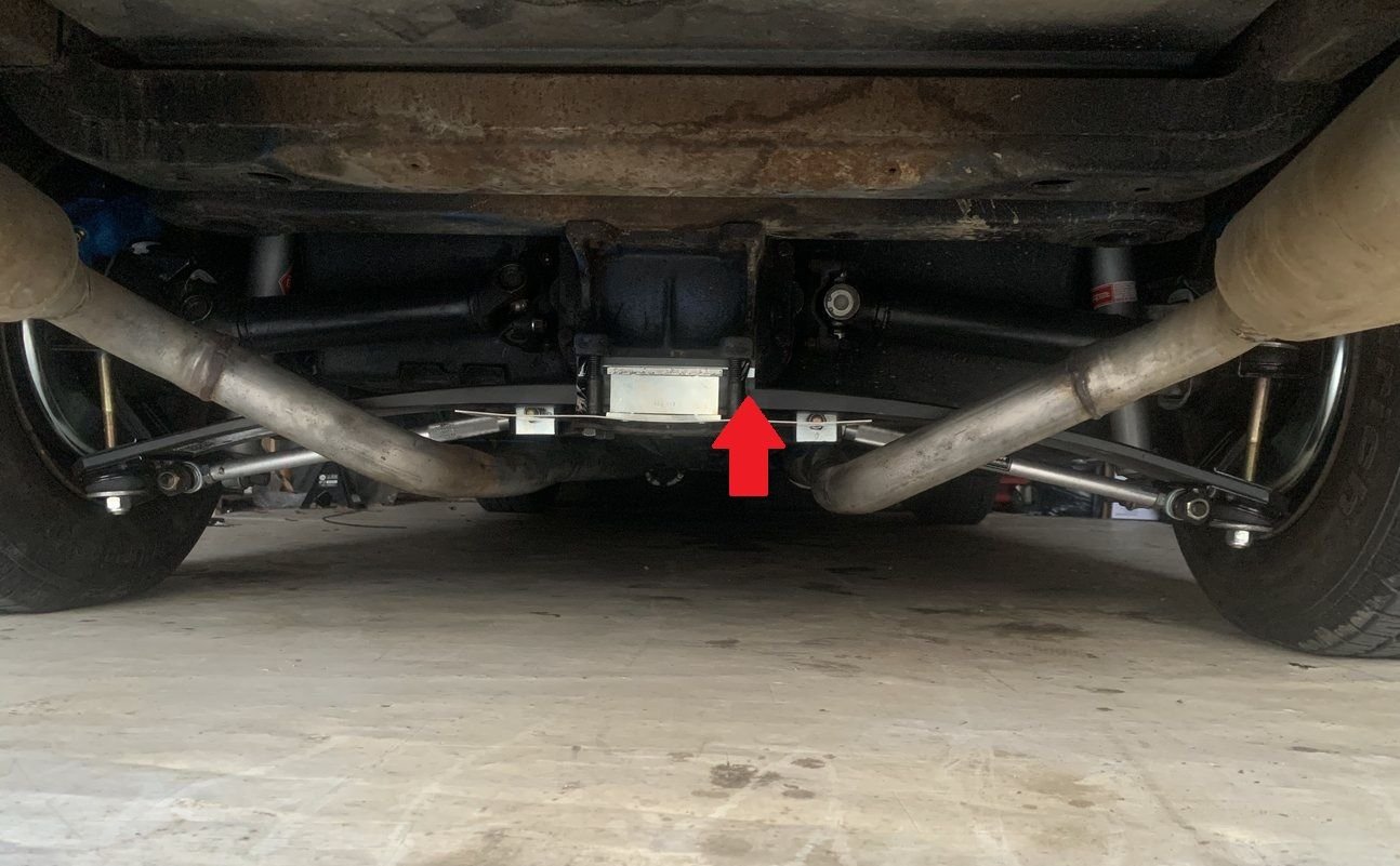

Something is wrong and longer bolts will not solve the issue.
Look at the angle of your half shafts.
With the weight of the car on the suspension with the tires on the ground, your half shafts should be level to the ground.
Yours are not and adding longer bolts like you did is only masking a problem.
Go back to the original length spring bolts and correct what is wrong.
As mentioned earlier, there are some aftermarket composite springs that will not allow you to get the proper ride height.
I would start checking everything again and maybe replace that new spring.

Can you get a close up of the area in the red circle?
Jebby

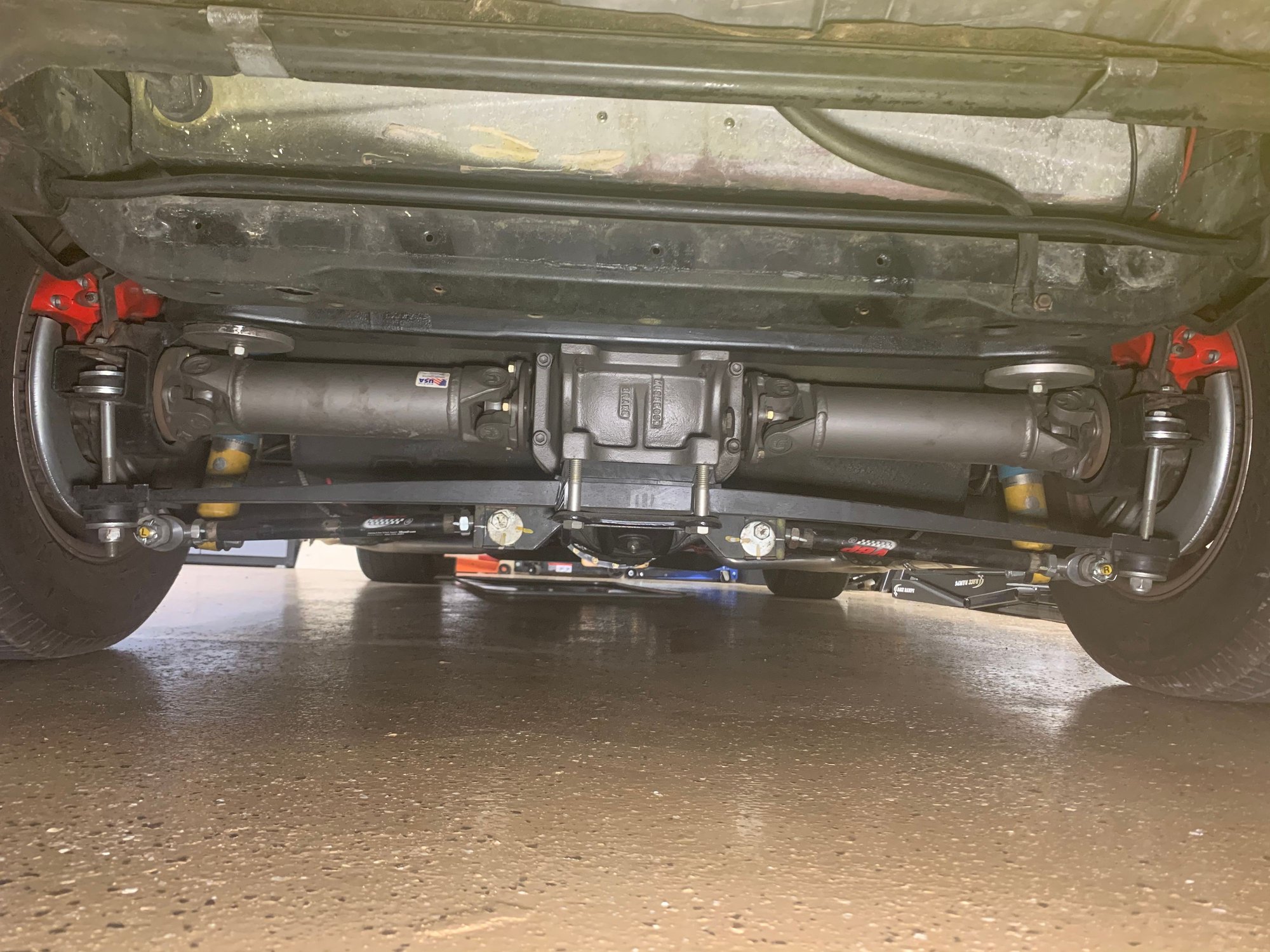

And here is a bad photo of mine for reference.......see how straight across the halfshafts and spring are? This is a VB&P spring.
Jebby
I agree-
Looks like a spacer that needs to be swapped to the bottom - or remove spacer and use shorter bolts TO the Diff.
If you swap out to longer bolts off the trailing arm- (10" as used on the C4) - you could possibly damage the tire - with the tire getting rubbed.
