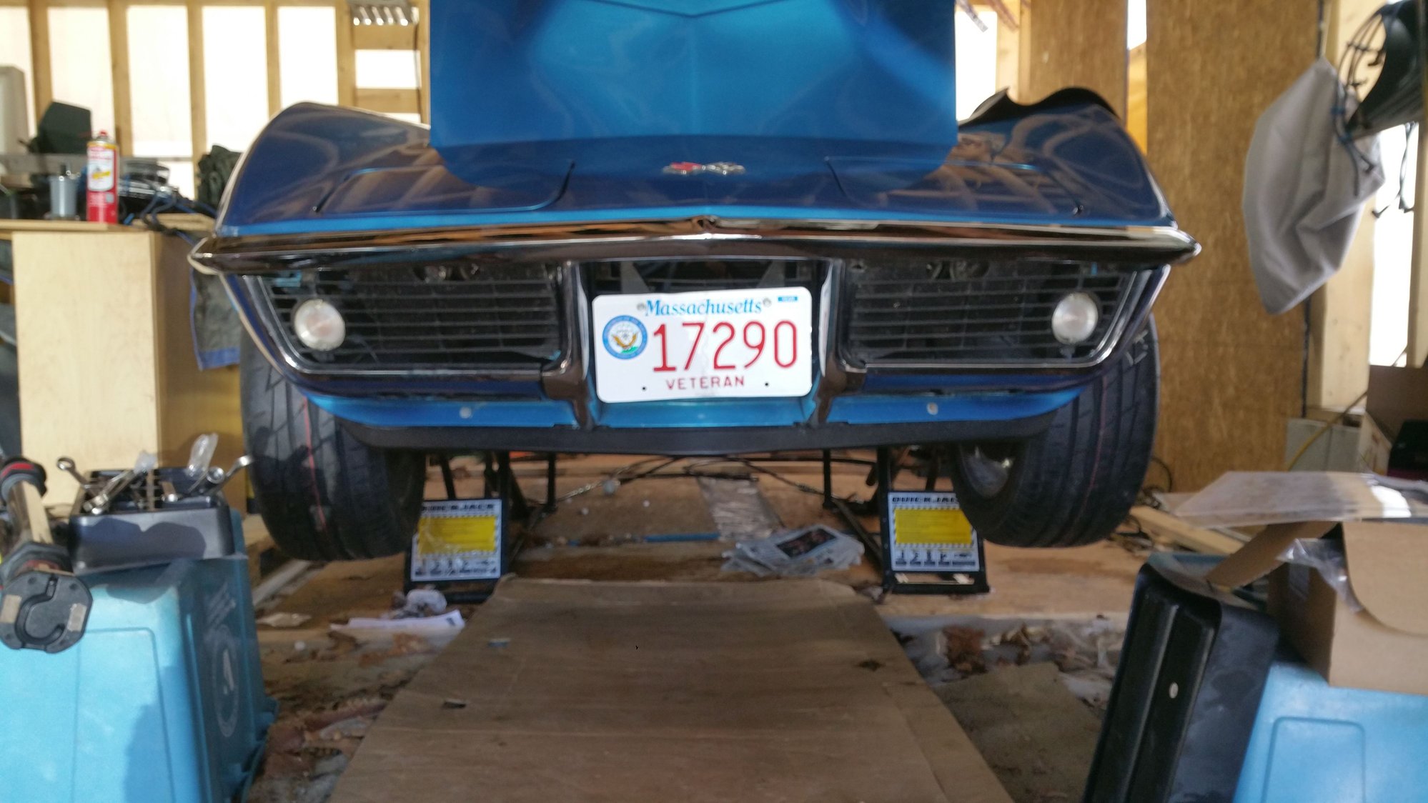

THeres a lot of good and bad info coming at you pretty fast. Your fan doesnt matter when you are driving on the highway, its all air forced in by the air dam underneath the nose that you are missing. I was battling these issues as I upped my horsepower and being a 68, the air dam was tiny to almost non existent. I added about 3 inches to my dam and the temps dropped atleast 15 degrees. And there are about 6 seals around the radiator, the hood and I found one I'm missing under the front of the radiator support. These are needed so that all the air forced into the opening in front of the radiator goes through the radiator and not around it. A good way to test the air dam test is to raise your headlights, the added area of the light buckets that is blocking the air flow will lower your temps a few degrees. I had to take out he shields and raise my lights at a track event last summer. you can leave the fan shroud in place if you like it for looks but you can lose it if you dont car. With the fan attached directly to the radiator it will pull though fine but just in that 16" circle. If your car is fine in stop and go and while idling you'll be fine. If you put on a flat metal shroud you wont get the cooling at highway speeds unless you have the little trap doors to let the forced air through. You can see those at Dewiits. There was a member selling a nice one for a larger radiator than I have but it was for a 17" fan. It could be made to work though.
The TINY air dam about an 1.5"
4 inch rubber extension added ontop of the tiny one
