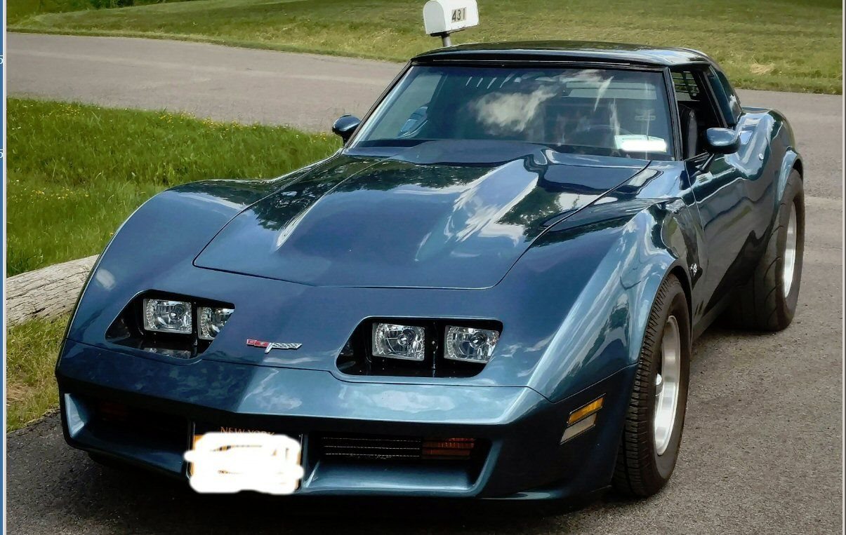

I am posting this for future users who search for coil overs. And want an option that's cost effective and has the control arm reinforcement . I have had this set on my 1980 from 2017 to present 2020 , There called Pro Shocks GM Coilover Conversion Shocks 200/SR375

Car drives perfectly with them . I might add that I do not have A/c and I have aluminum heads. So I may be a tad lighter then some. The springs have very little adjustment on them for the stance I am set at .
