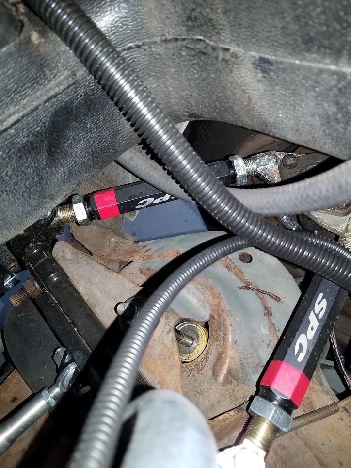

Here's my stock 2" 80 L48 radiator (AC removed), with the refreshed, but still stock, 1 1/8" front sway bar. The DeWitts radiator is a bit thicker, but I'd think you could make the swaybar work, even if you had to add spacers to drop it down from the frame stubs. This photo was taken when I was fixing a leak, so not the best photo.
Also, consider SPC adjustable upper A-Arms, and a SharkBite/SpeedDirect front brace (pictured, easy to fit with an electric fan). It's easy to dial in however much caster you want.

Thanks for the pics!
I did consider doing spacers at one point, just some aluminum stock at whatever thickness I need to clear the neck, cut to the same shape as the sway bar mount. I may still go that route, but I feel like I should fix the actual problem (being the core support damage and possibly sagging front clip)…. If I could get myself to turn a blind eye the spacer might work.... I just have trouble letting things go lol
