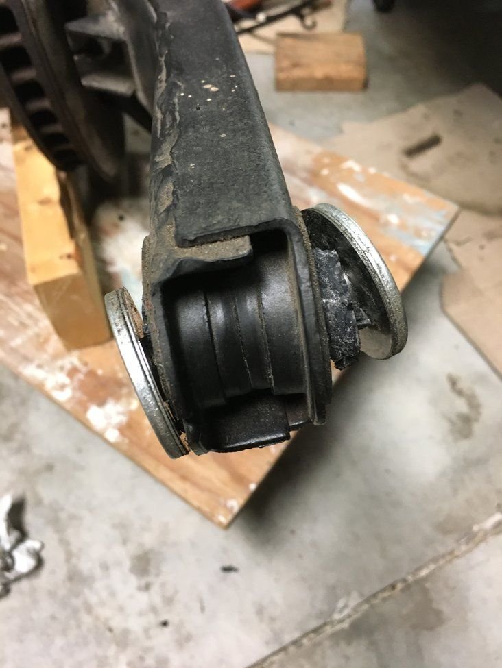

I am thinking about using Energy Suspension poly bushings on the 2 rear trailing arm pivot mounts. I understand these can be installed without removing the trailing arms completely as they are not pressed in and staked with a tool. Is this true and are the poly bushings the same width as the stock ones or are more (or less) shims just used?

Yes, it can be done. However, it is my experience that this is one place the poly bushings do more harm than good. Not enough compliance for the motion they endure.
Johnny joints are the answer here.

Thanks guys. I had heard some sellers were pawning off inferior "poly" bushings that were known to fail but figured Energy Suspension would know what they have or would have quit producing it but who knows... Some guys swear by the stuff but maybe rear control arms isn't the place for it.

i agree..would be nice to know definitely if usa made extruded quality vs a lot of known crap..personnally at this point id probably go rubber at this moment for ta only

I had Bairs put rubber trailing arm bushings in when they rebuilt my arms. They are the only rubber bushings left in my car. I've been happy with Energy Suspension poly bushings everywhere else (and heim-jointed strut rods, steel engine mounts, etc).
