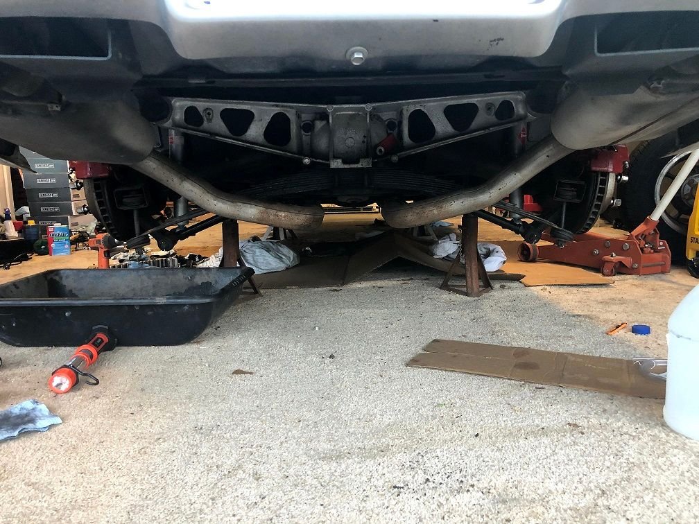

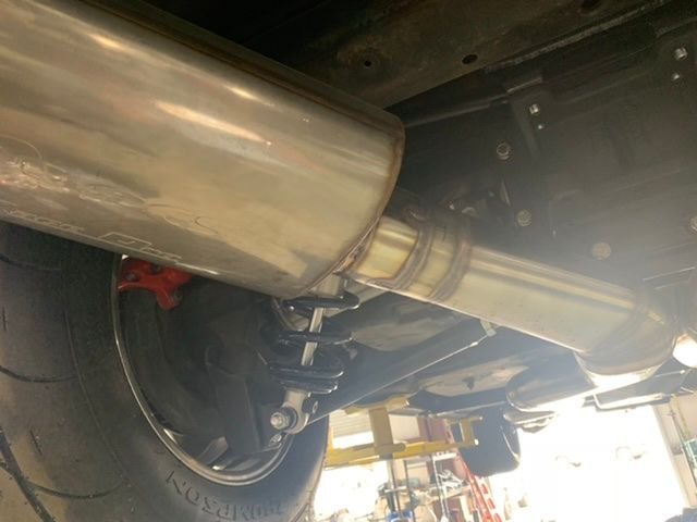

Here is a picture of the exhaust. Not really sure how much you can tell since it's off the ground right now.

I painted mine flat black using hi-temp barbecue grill paint. Now I don't see them anymore. lol

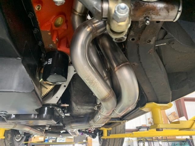

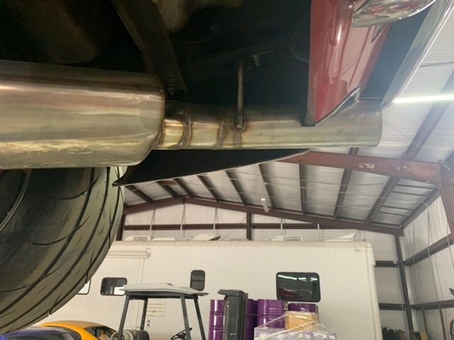

I repowered with a 632 and the engine builder recommended 21/4” headers with 3 1/2” collectors and exhaust pipe/mufflers. We transitioned from the 3 1/2” collector to 2 1/2” x 4” oval past the rear end and transitioned back to 3 1/2” pipe, mufflers and tips. Very clean and functional installation.

68vette2go,
That is a really nice job on that exhaust system. Looks like it would be hidden about as much as you could get. Maybe I'll learn to weld one day and see what I can do.

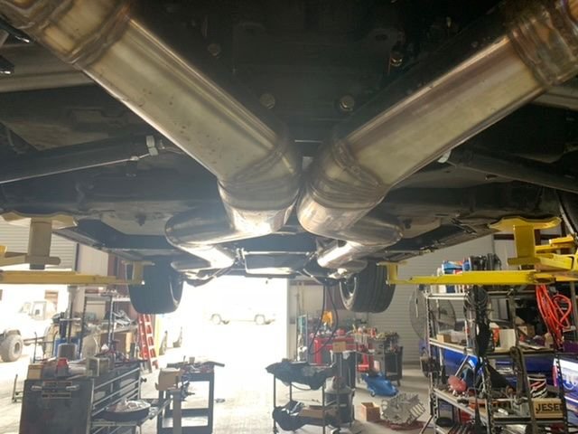

This is probably the best picture I have of why I don't like the exhaust pipe routing on my car.

If you paint the visible pipes a flat black hi-temp paint and remove (or turn upside-down) any muffler clamps, I doubt you (or anyone else) will notice them. That is the way that C3's look because of all the 'stuff' in the rear under-carriage.

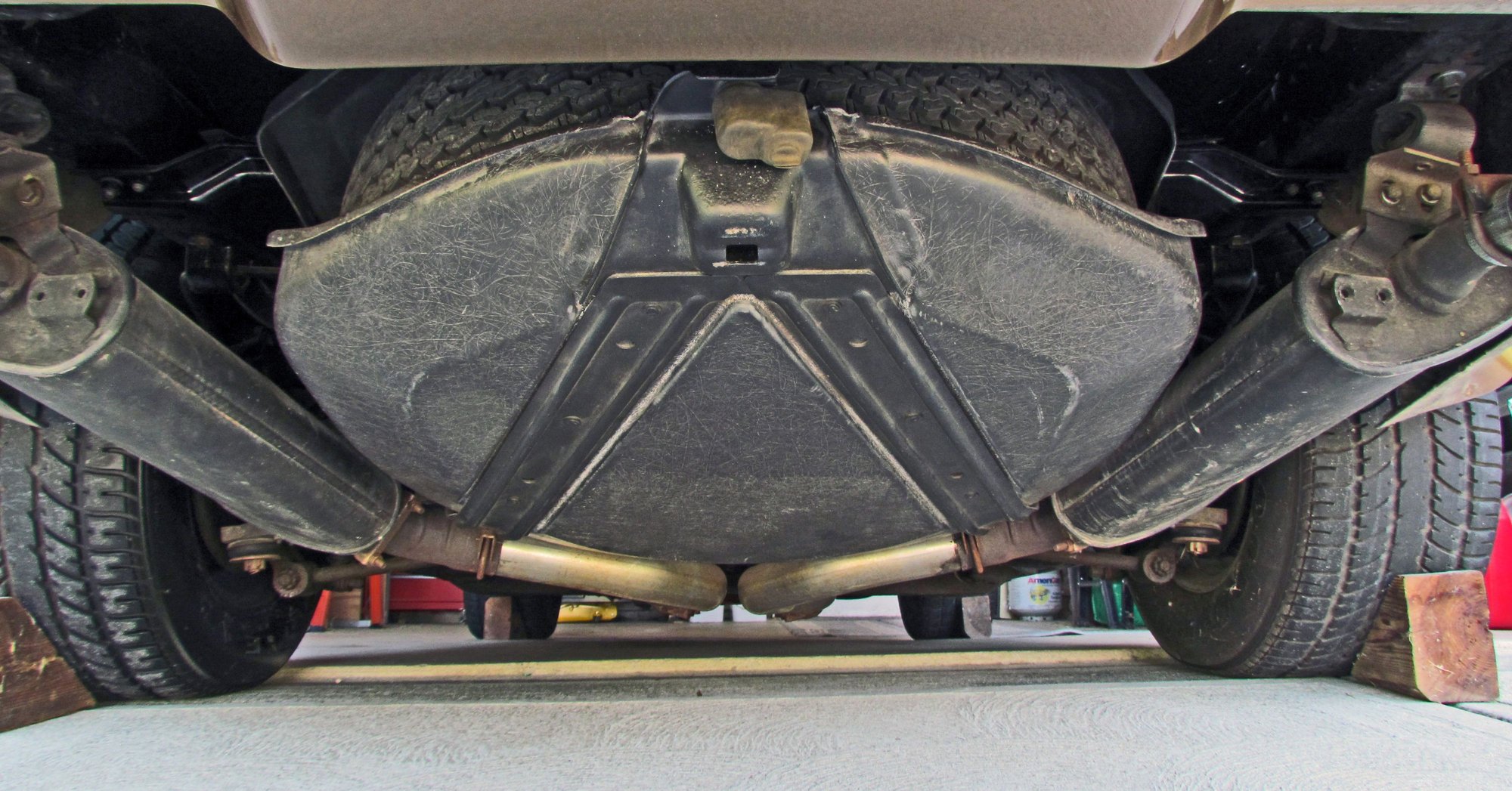

My guess is your pipes are not routed correctly. Here's mine from 10 years ago.

I agree..took me a bunch of tries to get it tucked under correctly..basically start loose from front keep toght to body within 5/8 inch accordingto manual...i swore forever my pipes were not right...they were..even the tips match now and do not stick out..at least with my hideaway mufflers..its amazing how much the tick under...or not depending on instal
