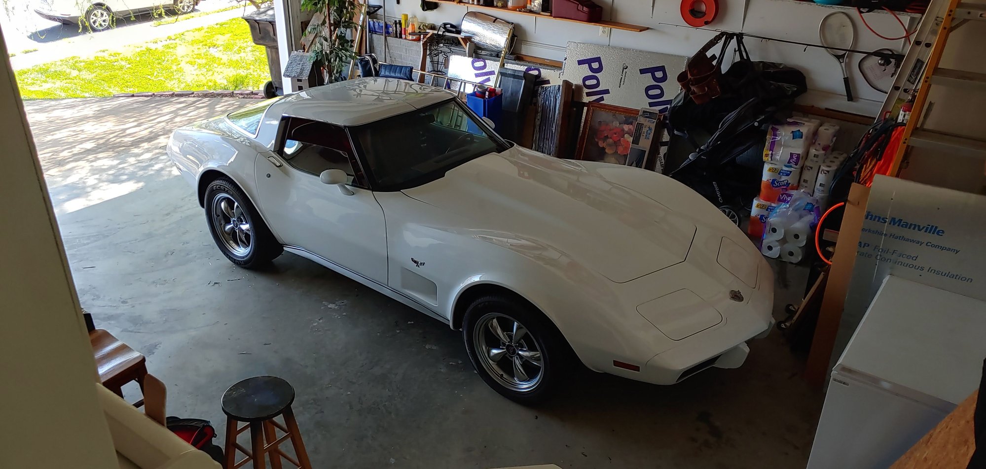

New to forum, just purchased a 78 Vette and of course got it home and found a number of things that need attention. First thing I want to fix is the temp guage. It's stuck just before the red on the dial.
Needle doesn't move whether I'm driving or parked, hot or cold. Thinking it's the guage? Anything I can do to check before tearing the cluster out?
Thanks in advance
Wayne

Nice car.. lots of threads on this..
i would personally get ir gun and see what your new ride is running for temperature at thermostat housing hose when hot..
great vendors and resources here (this is one see sponsors)
http://repairs.willcoxcorvette.com/c...re-gauge-info/
and great guys on here..mine reads 155f but is really 180f..oem t stat was 195f...
keep al posted and pics always good
haha might trade toilet paper for parts? 😎

Not sure about your temp issue, but I think we all now know who the paper towel and TP hoarder is.
