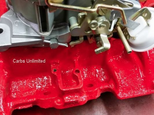

Your manifold needs to have a mounting spot for the divorced choke like this in order for an electric choke conversion to be installed:

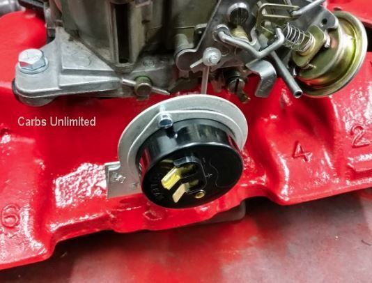

...or like this:

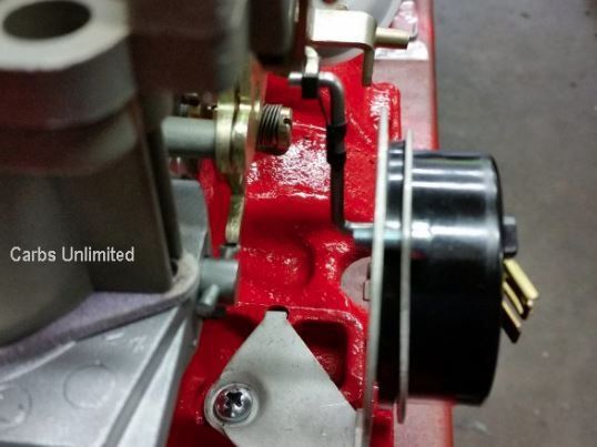

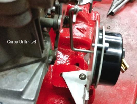

The electric conversion is then mounted to the mounting pad on the manifold:
It has to be mounted flat to the manifold. If your manifold does not have a pad like this, you will need to machine one, or fabricate a mounting pad to install to the manifold. You will then need to fabricate a custom choke rod to connect to the carb:

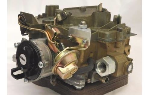

Actually, CarbJunkys has a setup that they have pieced together from M4M parts to adapt onto the 4MV carbs - sells for around $80. I have never used one or seen one in person, but they have had this on the market now for a couple of years. It only fits the early 4MV carbs from '67 - '71 with the slotted lever on the airhorn shaft - it will not work on the '72-'74 4MVs with the airvalve shaft with the single hole in the lever, unless you retrofit the carb with a '67-'71 or '75-'80 secondary airvalve shaft:
https://www.carbjunkys.com/Quadrajet...l-p/cj1000.htm
The other potential issue with this setup is that it uses the 1975-1980 choke pulloff. These pulloffs have a very fast release rate, and will often cause a bad secondary tip-in stumble. If this occurs, you have to fill the vacuum nipple hole and re-drill it to .021" diameter to regain control over the secondary airvalve opening rate.
