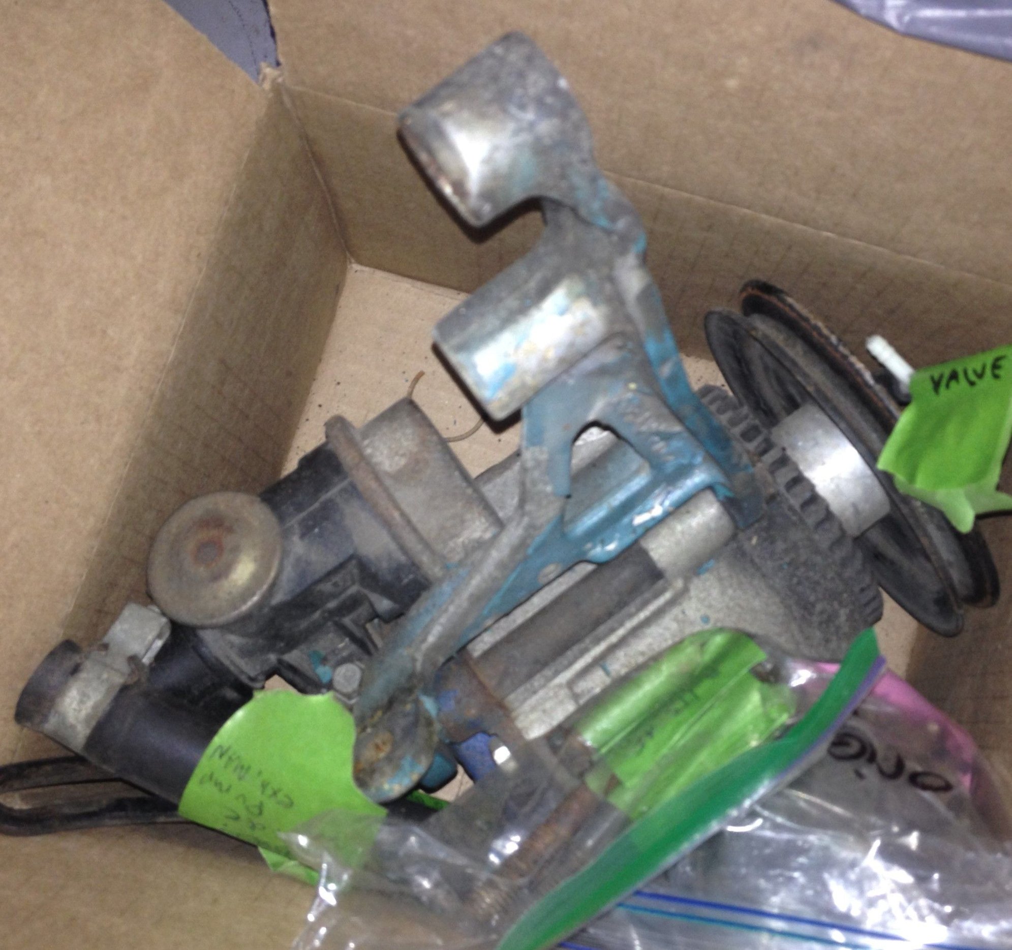

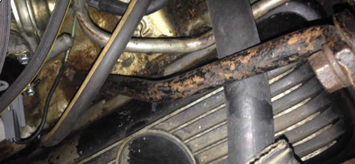

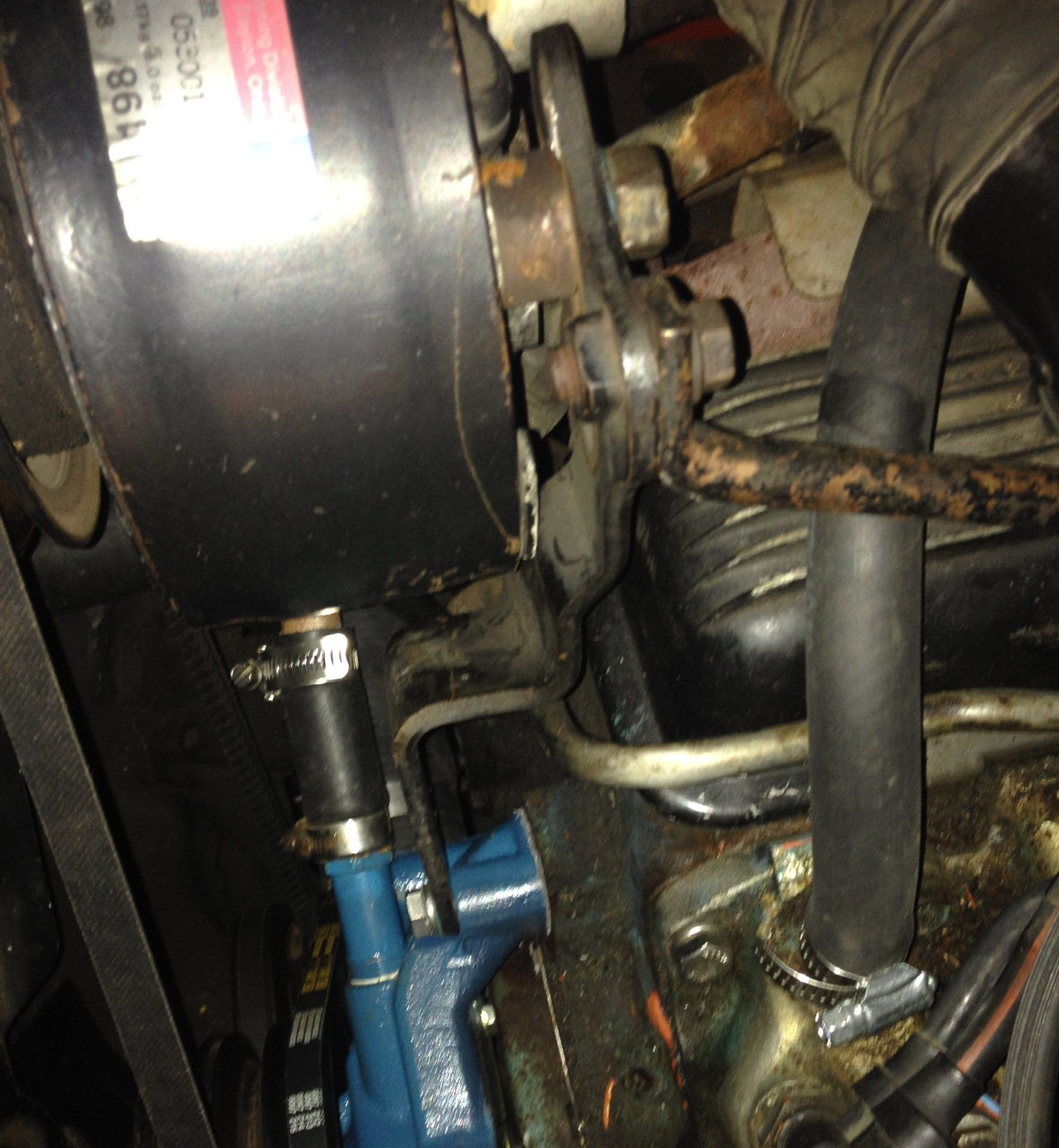

Not sure what the issue is. I bought mine new and have pulled the air pump and bracket off. The AC dose not use the air pump bracket. See photos below.
Here's where you'd see the pump if still there. AC compressor is fine. The rusty rod extending from the back of the AC bracket mounts to the intake manifold.
Close up of the support rod between the AC bracket and manifold.
pump now in storage with its bracket still attached.
Mine is an L82, but I'd be surprised if this was rigged differently other SBC's that year.

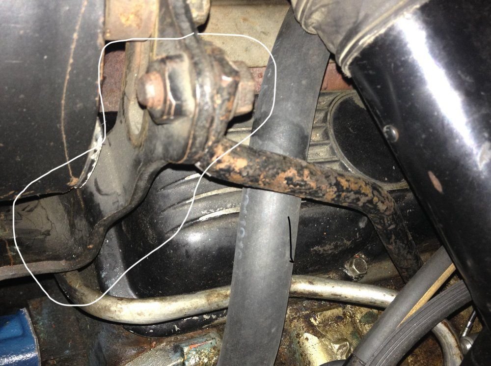

Actually the AC is on the right (passenger) side. The valve cover "tilt" is just due to the angle of the photo. Here's a photo with the support bracket from the AC to the manifold. Fortunately I had the air filter housing and snorkel ducts off already for other work. The attach point is just below and ahead of the choke.

thanks I see now. I found the other bracket that I believe online and ordered it. Not cheap but nothing is. With you photos I think I got it figure out. Really appreciate it
