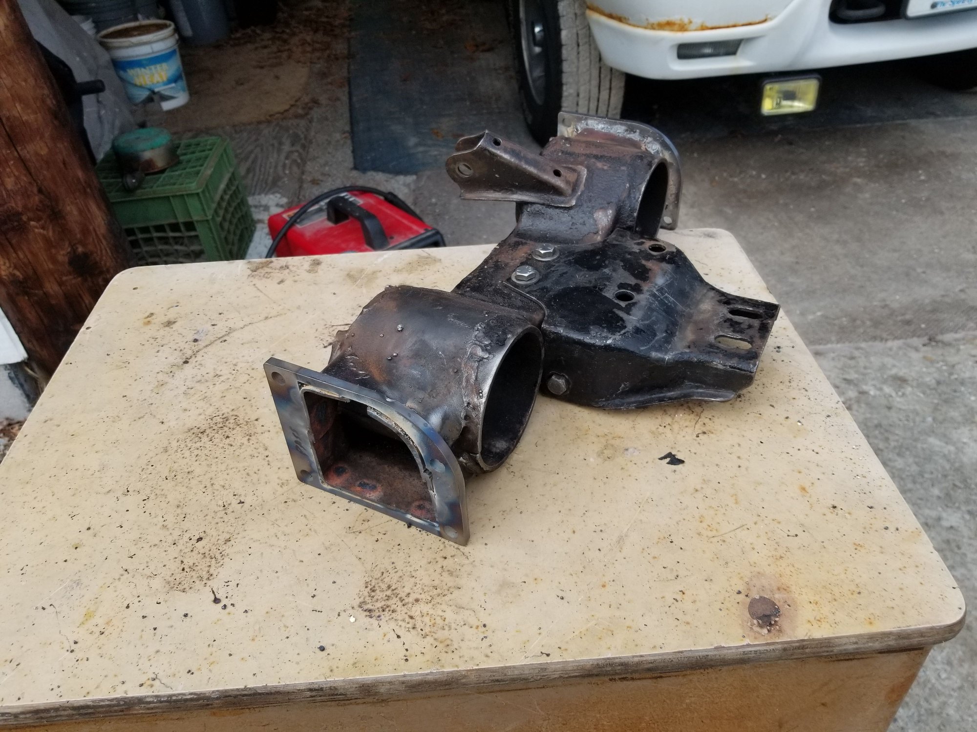

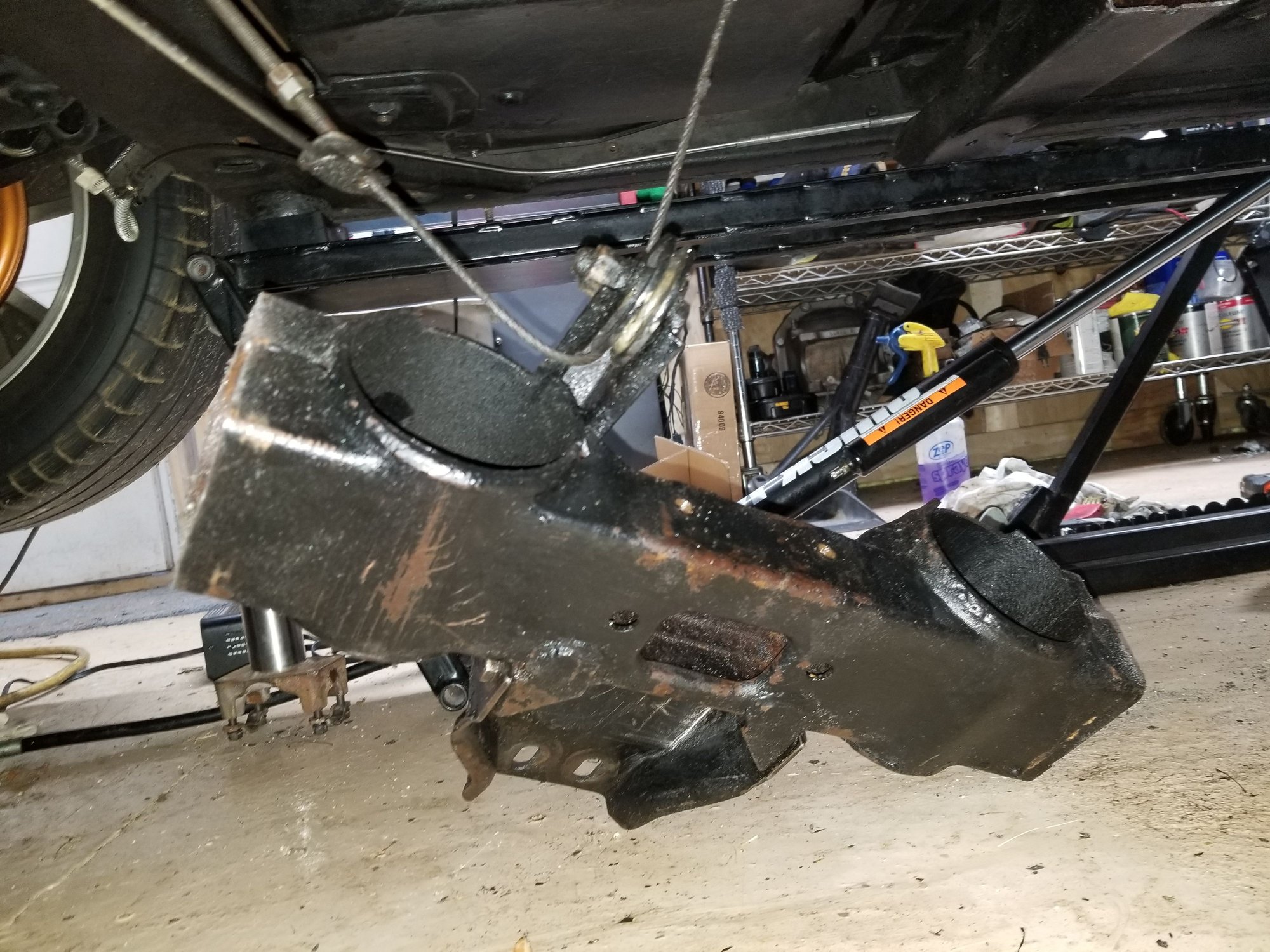

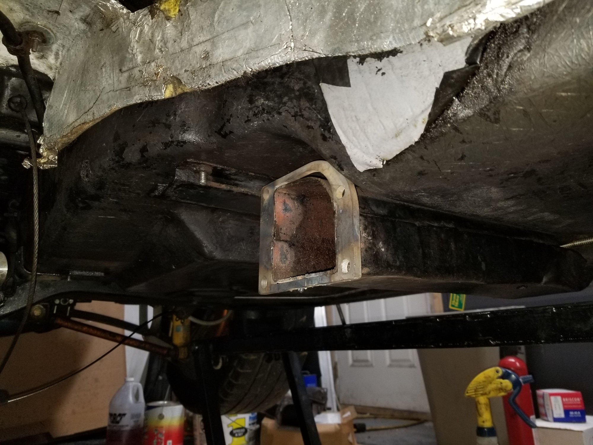

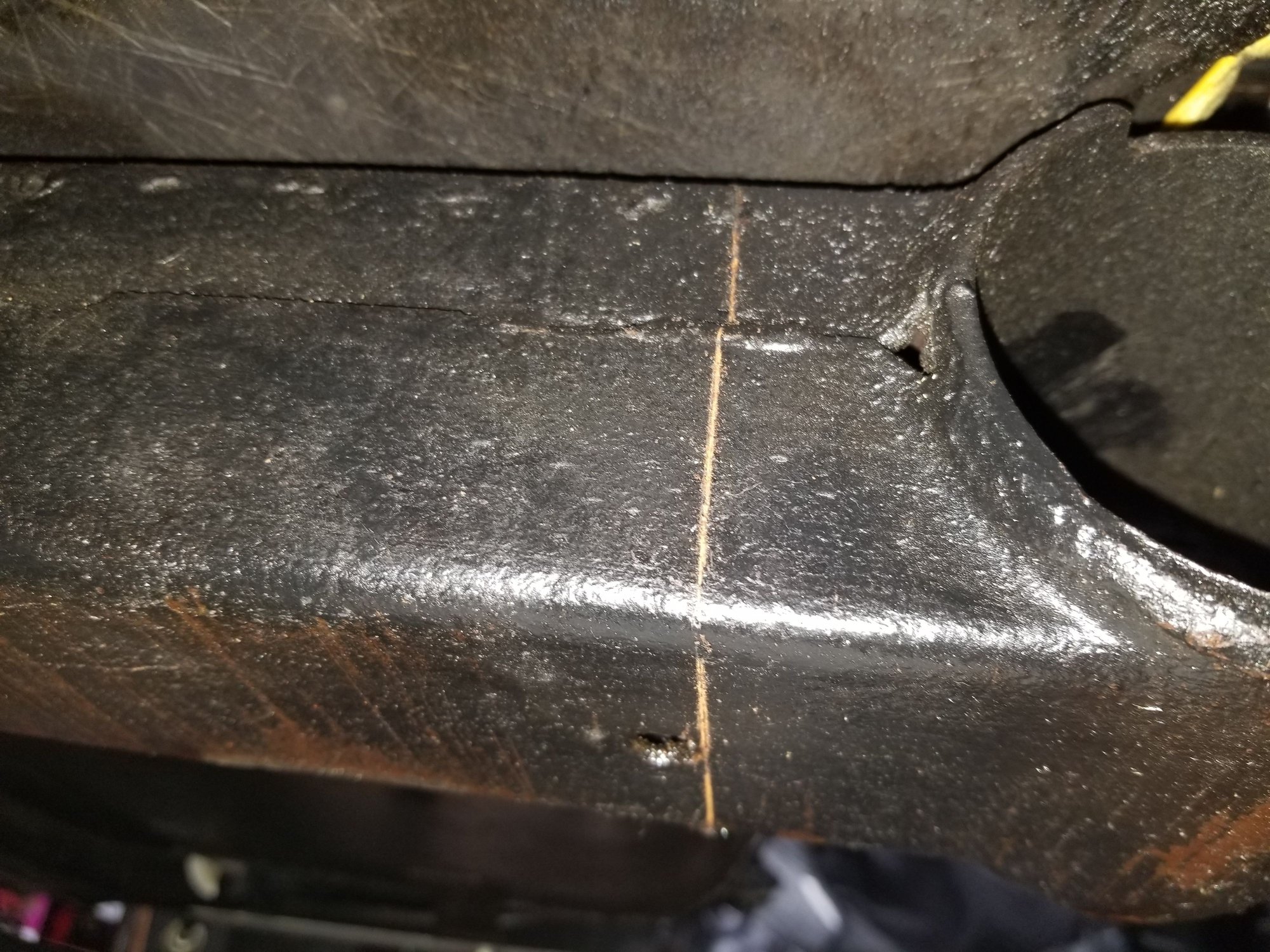

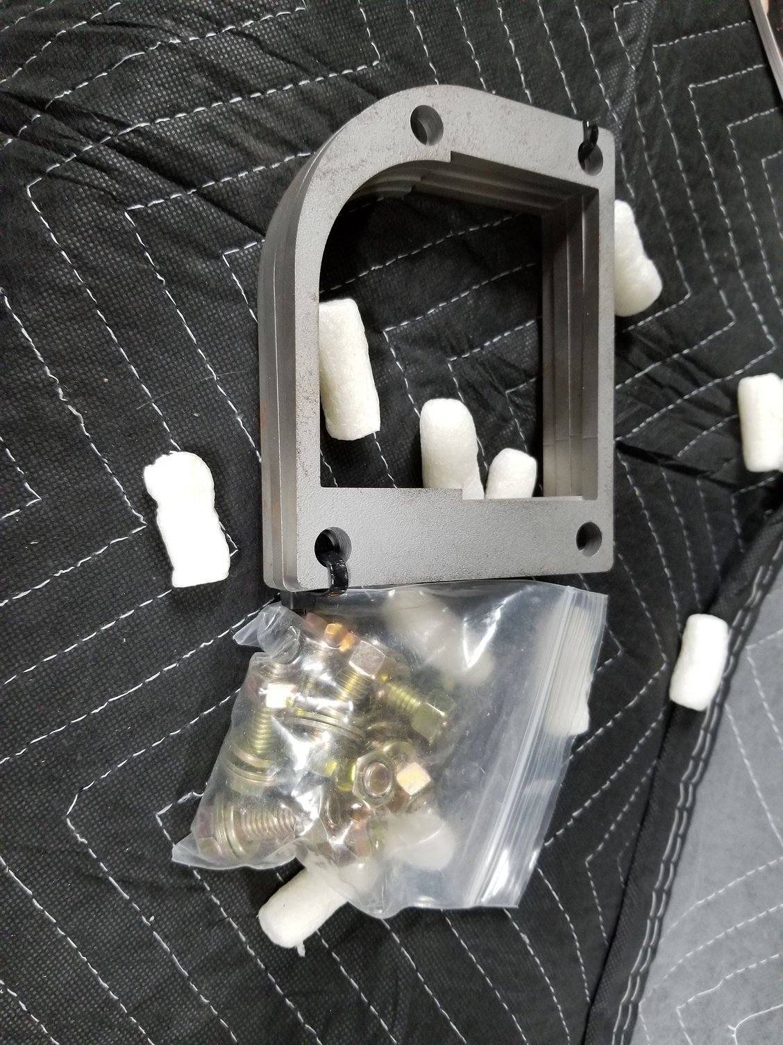

You'll have to pull the steering and dash to make getting at those pedals easier. You"ll need to make sure you find the downshift linkage as well. I would hunt around for a totalled car or someone parting out an auto car and buy everything from the pedal assembly to the tranny, but no the tranny. And buy a good OD tranny like they suggested above.
Cutting out the center of the crossmember isnt too difficult. I scribed some square lines on it and tried my best to cut it straight. Then just shave a little off the center piece so it was easy to manipulate. I used a piece of tin between the body and the frame to keep from cutting into the fiberglass floor and when I welded I used a welding blanket draped over the frame and everything I didn't want to burn or get spatter on including my QuickJack. I had an extinguisher handy and I just used a squirt bottle with straight water for any small flare ups and to cool the frame. It worked great and kept me from panicking when the welding blanket would smolder or flash.
I cant believe the difference in getting the engine in and out, so easy now
I got these from David Allvettesforme. He had a few extras back when he was doing a Restomod.
