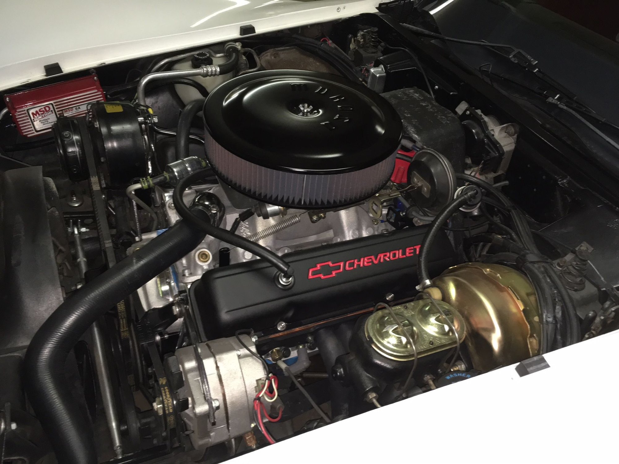

Looking for a place to mount a MSD 6AL and was considering mounting it down in the little cavity behind the right front tire near the washer bottle. Anything else supposed to be in this area.
The car is missing the wiper door and solenoid. It also has an extended aftermarket L88 hood that covers the opening. I plan to remove the last of the giblets that were left after the wiper door was pulled but I’m wondering if anything else should be in there.
Also any better suggestions?

This was about the only place I could find to mount mine on my '79.

doh! I mounted mine on the opposite side but the same spot. The hood prop just skims it when opening and closing. Lol you have a good spot. If i can shorten the vibration mounts ill be golden. Or i may leave it.
