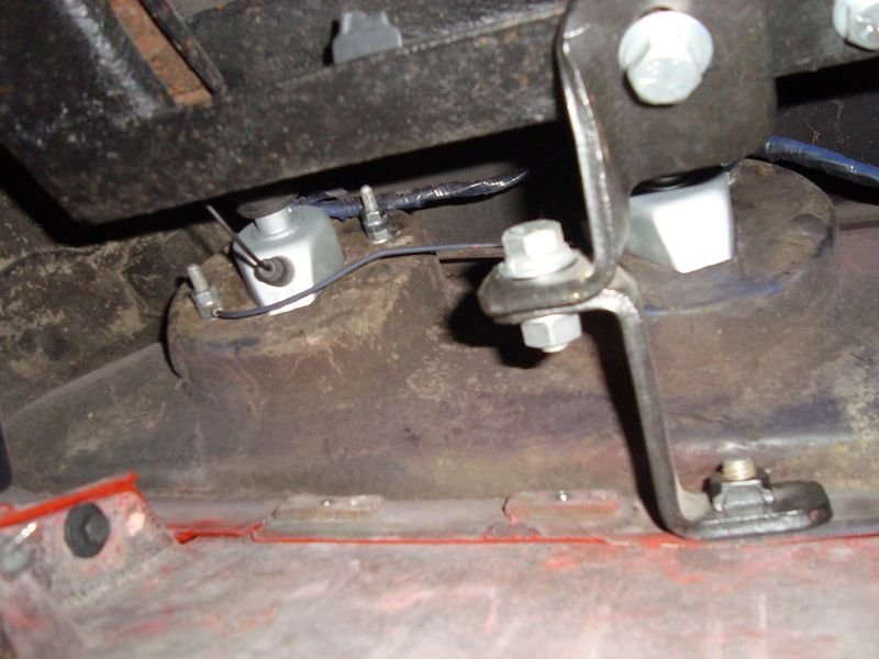

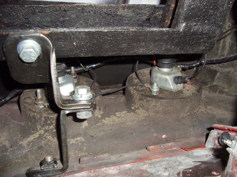

The black grounding wire in the tail lights harness runs directly to first light housing and is then daisy chained to the others (including the license plate light and goes also to the frame where the antenna grounding strap is mounted).
I guess there is also a diagram in the AIM?!
