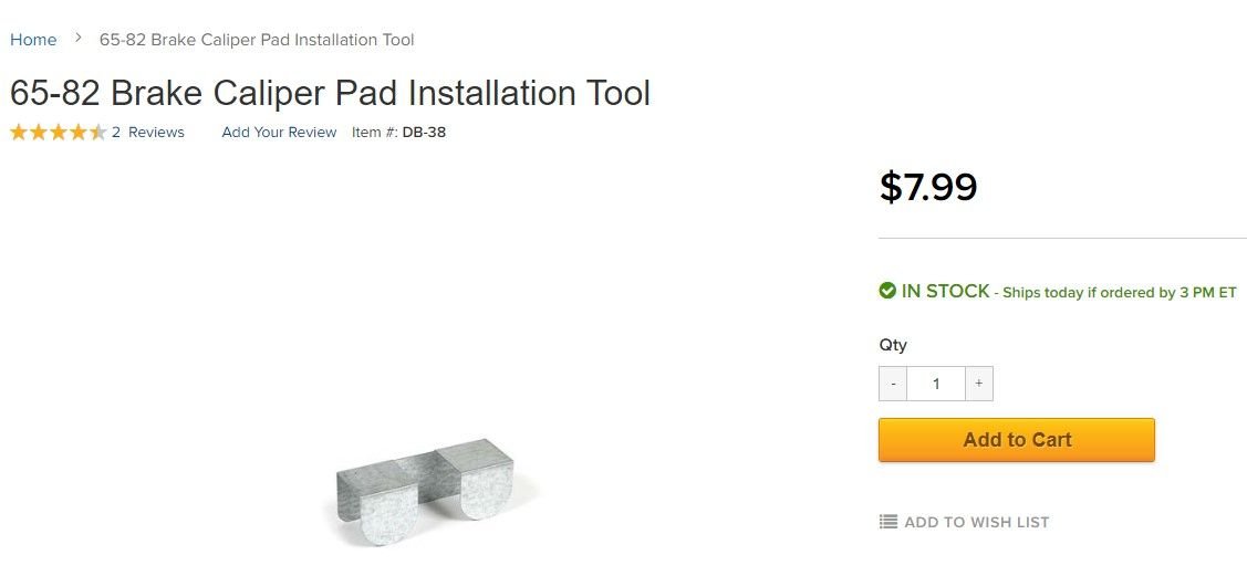

Some of the vendors sell thin C-shaped clips that will hold back the pistons on both sides while you slide the whole thing over the rotor.
Then the clips pull right out.
You could probably rig something up on your own if you don't have the time to order them or don't feel like spending the money.
I'm sure some of the whiz-kids on this board can offer some home-made remedies.
Found these on Zip's site.

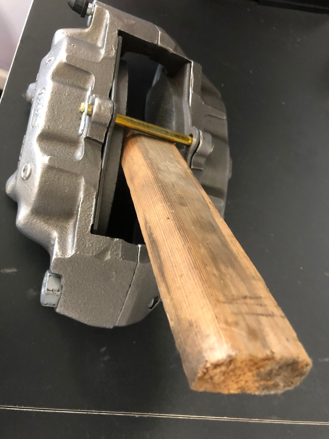

I didn't have the forethought to order one of those clips so when the time came I found a wooden block the same thickness as the rotor, a little thicker actually, cut it down so it would slide through the top of the caliper opening
Stick it in between the pads and when installing the caliper it gets pushed out the top
I've used it (well a pair) numerous times since then and it work, I should order one of those clips someday but...

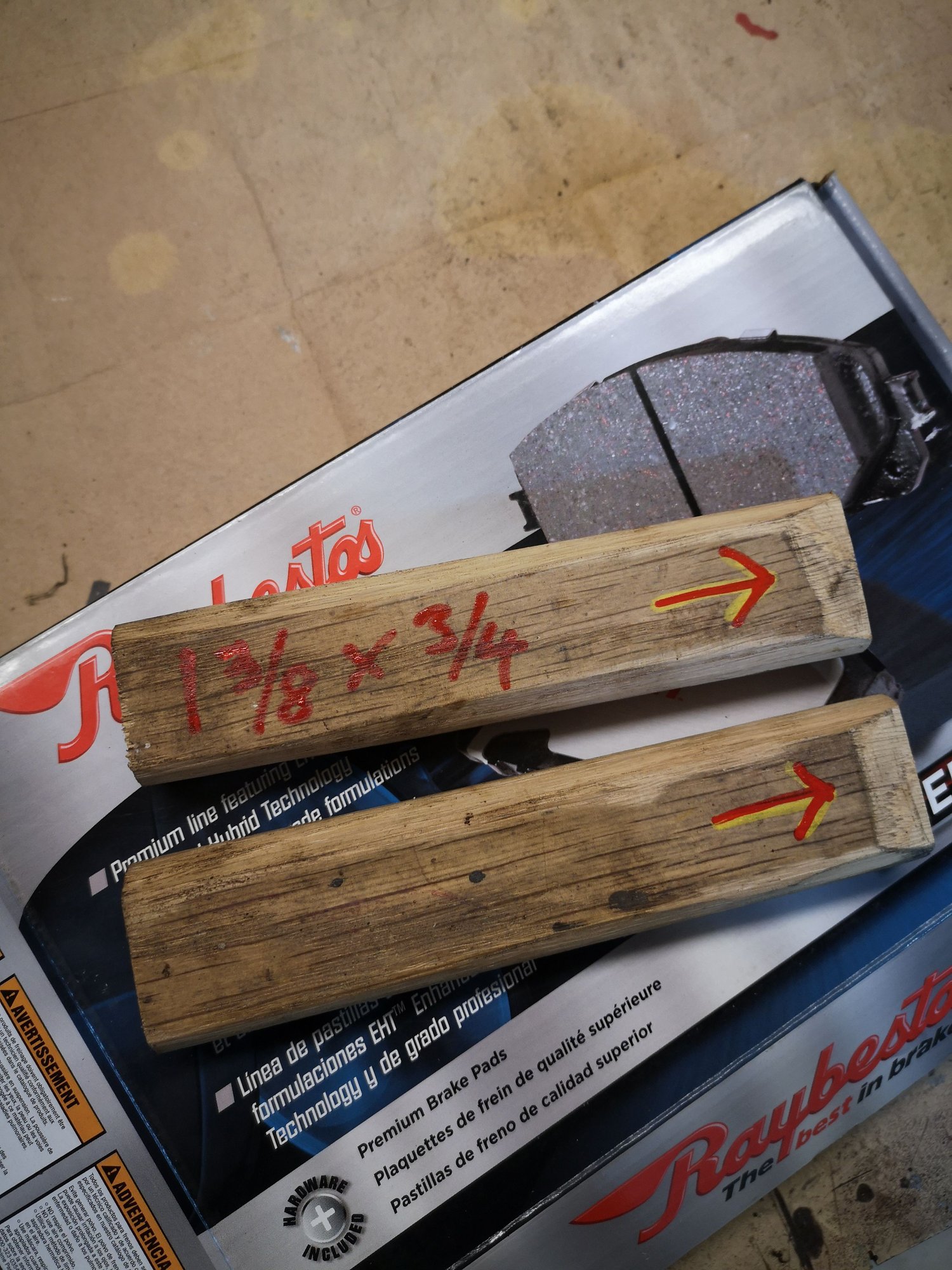

I have just used this same stick of wood for years. It's 1 3/8ths by 3/4" and I beveled off one edge. Insert it sideways then turn it on the curved bevel while helping the pads with your fingers. It's a 10 second job. Then place the caliper on the rotor and turn the stick back out on the bevel and you're done. It's also free.
