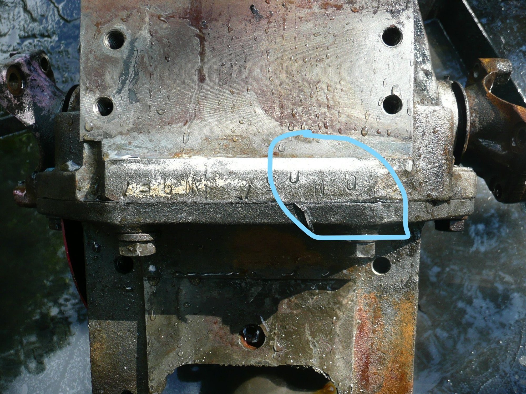

Here's the rear diff from my 79' 4-speed ("OM"). Code is stamped on the bottom.
