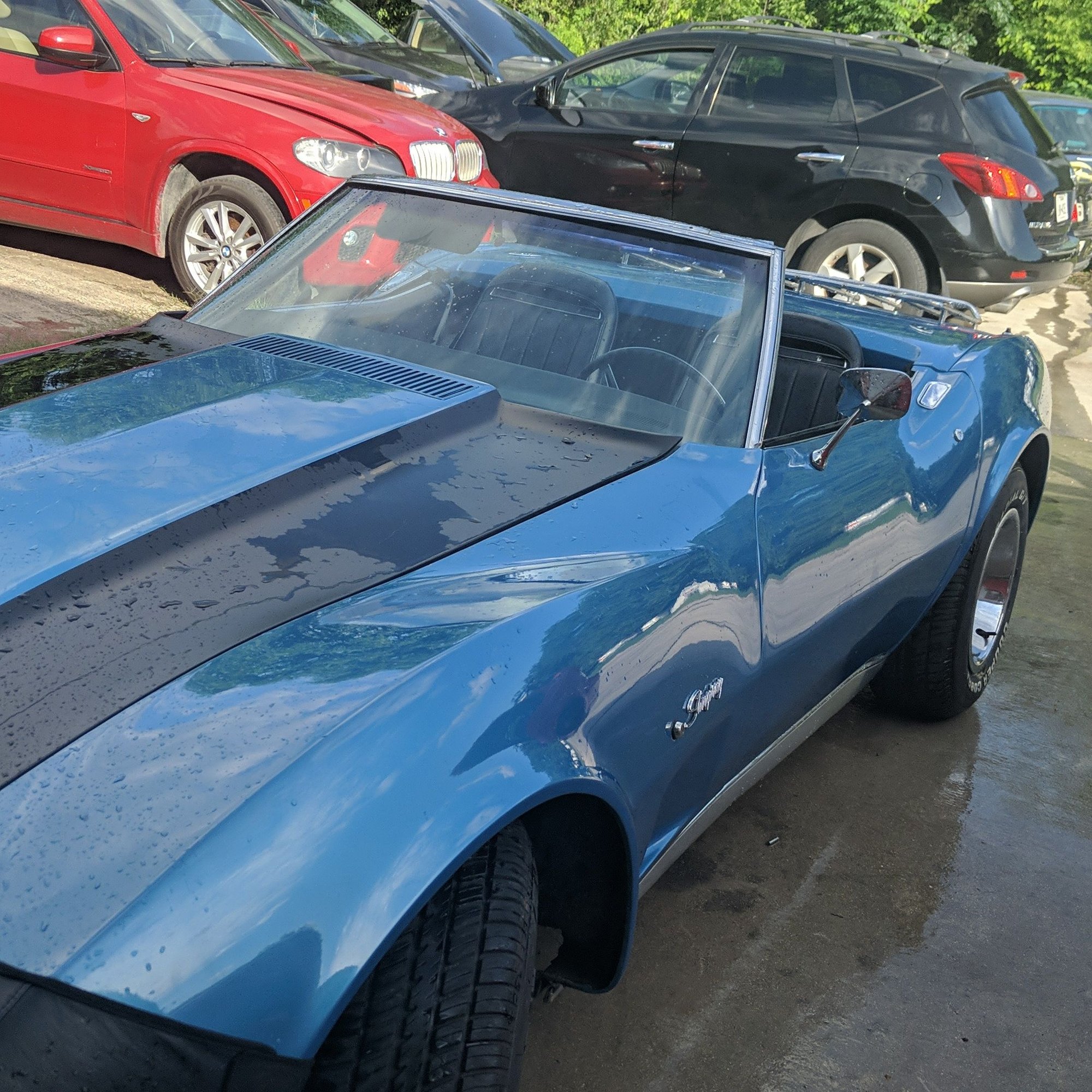

Hi!
I just swapped a LS1 into my 74 Vert. The front suspension was trashed so I replaced all the tie rods, the idler and shocks. Somehow I lost the pitman arm, so I ordered it off eBay. Then the relay rod was bent so bad it hit the oil pan. I had to replace that too! eBay again. I removed the stock power steering and went with a Borgeson low ratio great box. I have left the stock springs in the front so far, my girl sits a little high, I'm not sure if it's just because the LS1 is lighter than the old 350 or something else. I took it to a classic car alignment shop and they said the rear is so bad they won't do it. I need to rebuild my trailing arms, buy adjustable camber rods, and replace the rear gears while I'm at it. I bought 3.73 gears. I have a full blown shop with lifts and a press. I think I can get it all done in a few days to a week. I would love to not spend the money on the specialty tools, as my shop is a BMW performance shop. I won't buy another C3 and I will never sell this one. I don't expect to ever do this again. Will the Vette gods smile upon me and send a generous person my way? I would be happy to pay shipping and a little drinking money for the spindle demo, spindle removal tool, and I think there was another one. Please let me know. I am ordering the rear suspension rebuild kit and trailing arm rebuild kit tonight.
Thank you!
