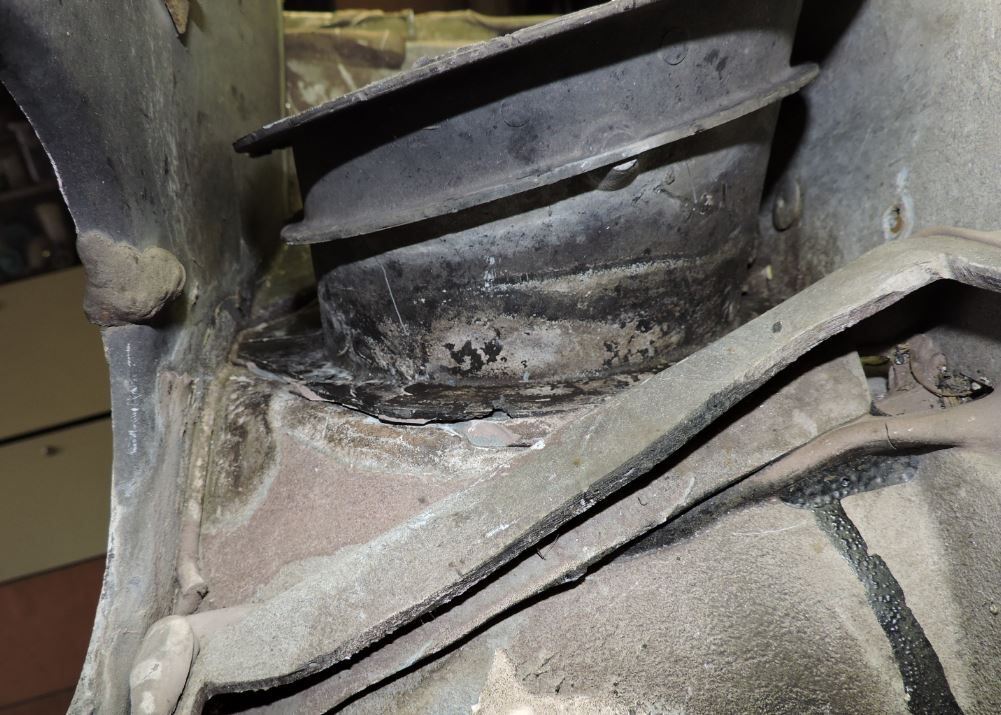

I have a questions for those that have removed and re-installed the firewall on a factory AC car (this ones 81, I think others are similar). How did you re-install the rivets under the re-circ cowl and under the fresh-air panel? (pointed out in red below) to remove I ran the oscillating saw into the bond for the upper ones and used the same saw to cut the back off the ones behind the cowl. I'm thinking about just drilling access holes in the fresh air panel and that cowl has to come out right? but how? I can't get anything in there to separate it. TIA, Doug.

Ah, let me put this as nicely as I can, what in the name of the wild wild world of sports are you trying to do? It looks like you are destroying a car, or maybe it's a bad picture.

I have no idea what you're talking about, this certainly isn't the first picture of a detached firewall on the forum, and to my eyes it looks to be in the same state or better as alot of the others I've seen. But thanks for the helpful feedback. Do you have any fresh thoughts on how to address the specific issue I asked about?

I take it the picture is from the interior, now I can conceptualize it. Basically he's right . Glad it's your problem 😉 good luck

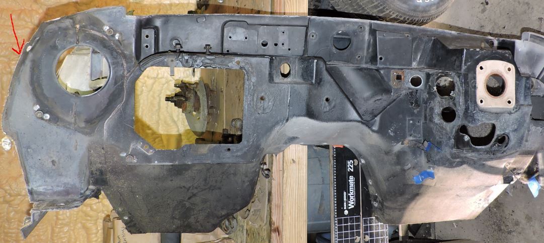

Quite literally "inside" this is behind the passenger side fender inside the plenum. This door opens and the fresh air door closes when running "MAX AC". Its so the cabin air is re-circulated and cooled rather than bringing in outside air. Below is the full firewall removed from the bird cage, the hole on the left is where the blower motor goes, this is behind that panel below that hole.

I have tried a little heat when I was taking the firewall off but switched gears to cutting the rivets to kick the can of dealing with this down the road. The heat does help soften it but you still need to get a putty knife or 5 in1 tool in there to split the pieces, which my delima - how / where the heck can I get a putty knife in here to break the adhesive? This is the fiberglass to fiberglass adhesive so its as hard as body filler. If I can't find some trick I'm going to end up basically cutting the outside adhesive lip off from the inside just on the outside of the where it fills the hole in the panel which means I'll also have to built a new connection lip for it to get glued back into place.
Here what it looks like from the inside, its pretty much just stuck to the outside of this panel with a slight lip through the panel.
This is looking down from the top, the lip you can see in black goes all the way around (the curve to the left of this is the blower opening. If you look to the right if this PITA you will see one of the rivet heads I cut from inside the hinge pillar.
From top still but a little closer, you can see I tried splitting with a putty knife and it broke that piece of the lip off. Its also got the attachment on the upper right but this one will split just tapping the putty down it sideways.
