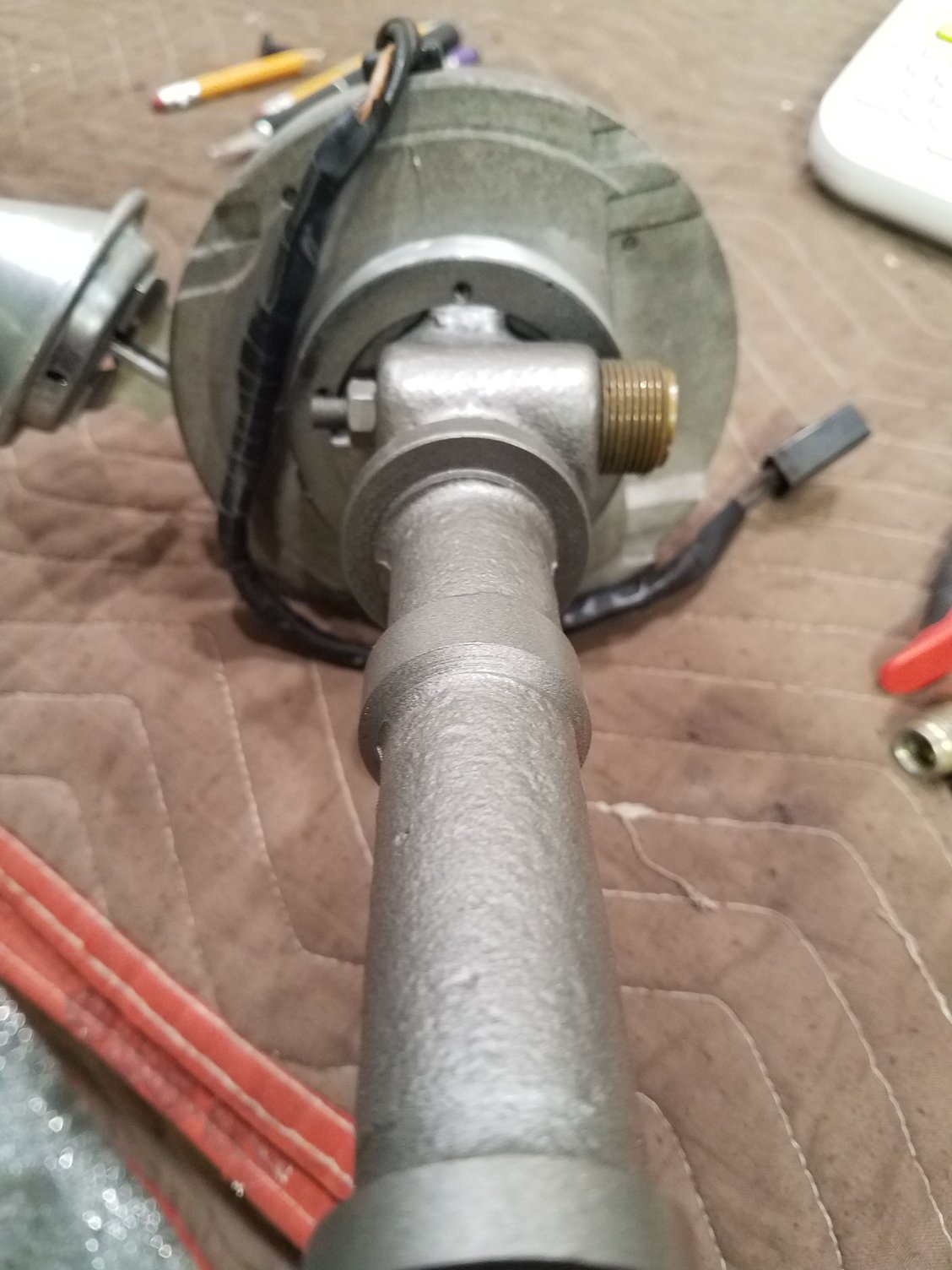

I just got this one in the shop. Someone with talent and time machined a tach drive, and installed an HEI top. Very well made.
Looks ok from here.
