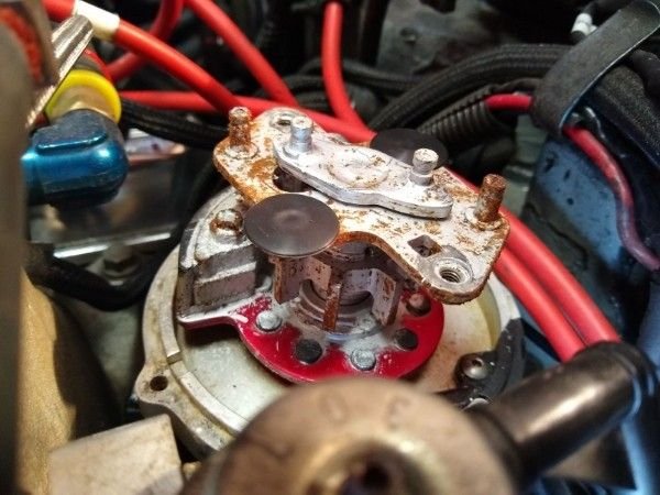

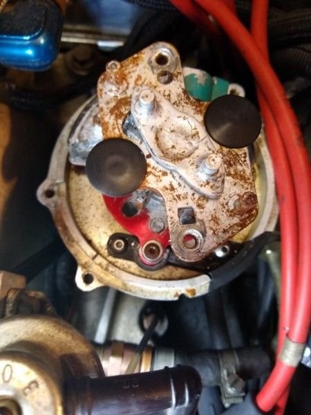

I have an MSD distributor and high voltage/current module and 6A spark discharge pack. The car is fairly new to me. I took the cap off and found this.
​​​​​​Does any of this need to be replaced? I don't have any experience with MSD stuff. I'm not 100% sure what all this is called. The car runs well. It doesn't miss. I think I should replace the rotor cap, but I don't know about all the other rusted stuff. Can you replace the internal parts? Should I just buy a new distributor and swap the whole thing?

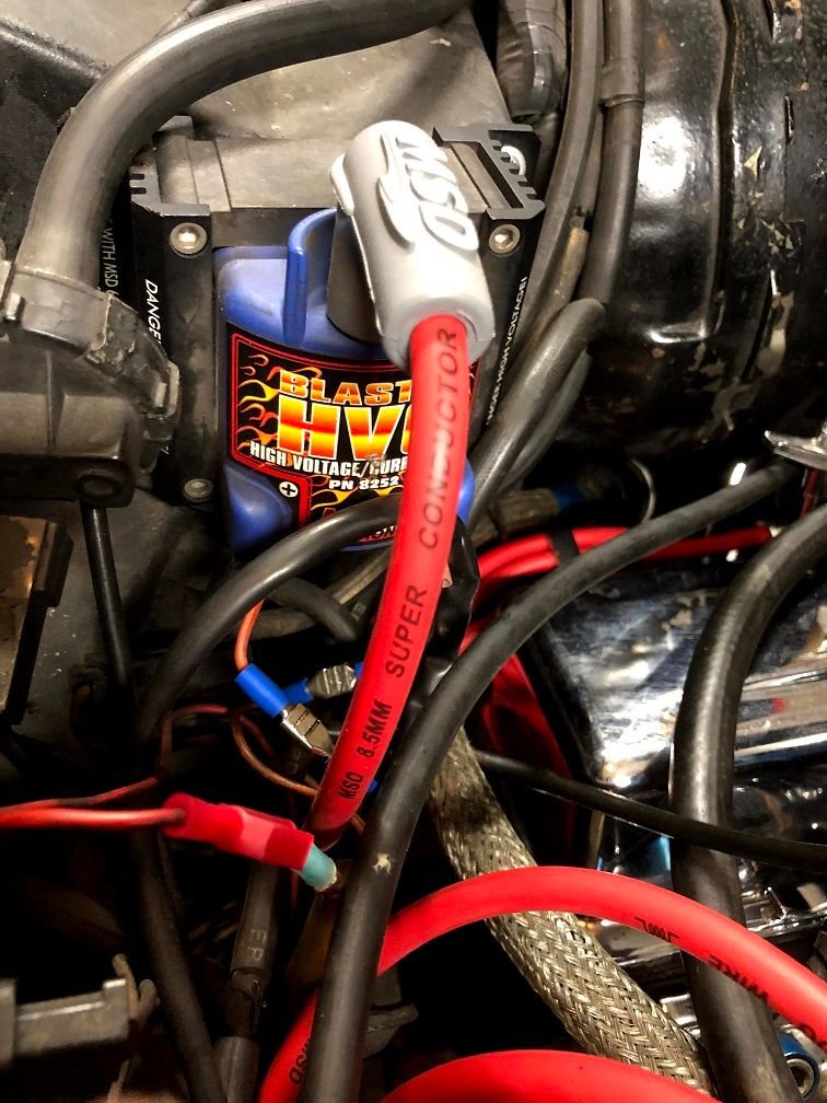

It also has these 2 modules.
So what do I do?

Very common if you search this issue. They wanted 150 to rebuild mine. I said bye bye MSD!
Some say venting the cap solves this but I have doubts. If it is running ok, then just clean it up best you can and keep running it.

Clean it, remove the rust, and then use rust encapsulator on it.
Mine has never failed.
Even when it looked like crap. Let me find the link where I last buffed it up.
Here are my latest updates. The last time I cleaned it and used POR-15 on it. https://www.corvetteforum.com/forums...post1594175835

If the rotor is that bad probably the cap is as well. I would replace both and clean the rest.

Yep you need to replace that.......and the super stiff springs for the mechanical advance. You have almost no curve in that distributor with two heavy silver springs.
Refer to Holley dot com and download the distributor instruction manual for how to change this.....but I can tell you that one blue and light silver spring and a blue bushing is about right for a mild street engine.

I would definitely keep the MSD parts working as they are. I have been using MSD parts for decades with no issues. Getting a new cap and rotor for sure and vacuum out the crud inside the distributor.
The Silver Springs are the "default" that MSD puts into their distributors. It is the slowest curve of all. MSD has a very informative set of instructions for setting up a Advance Curve. I would make changes slowly with your advance curve to avoid any problems. One step at a time...

Normal arcing within dist cap ionizes constrained moisture-laden air ... byproducts can be very corrosive ... Do vent.
Do vent via either drill thru top of cap or drill vertically thru bottom of dist base ... Then clean it up ...
... ensuring No particles stuck to magnetic pickup or "star" reluctor ... New cap & rotor.
IIRC, MSD offers a "cap-adapt" retrofit option using a large diameter Ford HEI cap which can help ... back when Cup used distributors, that's what most had.
FWIW, many vented caps available as marine options.
Vent not BS ...OE Vortec crab cap distributors in millions of Chev/GM trucks w/ L31 motors do have an OE vent-hole in bottom of dist base.
Folks way smarter than me figured this out Long ago.

The male caps already have a venting port to solve the moinsture issue.
But the old females don´t. I have drilled a hole into the cap with the same setup and old fashion cap.

I would keep the MSD. Definitely get a new cap and rotor and change the springs ( I use the blue and light silver in mine). Zuendler is correct about the caps. Mine has the male terminals and looks exactly like new inside.

Seems a vented cap alone wasn't enough.
Perhaps you should drill base & vent it as well ... like marine dist is
quote for MSD 8560 Marine UL dist:
For marine use, the distributor cap is bolted to the aluminum base. There are two flame arrestor holes with brass screens machined into the base of the distributor to prevent ignition of gas fumes that may build up in the engine compartment.
https://www.holley.com/products/igni...let/parts/8560
again, all those iron Vortec truck motors' OE truck distributors have vent holes thru base. I'll add, even they're not always 100% effective.

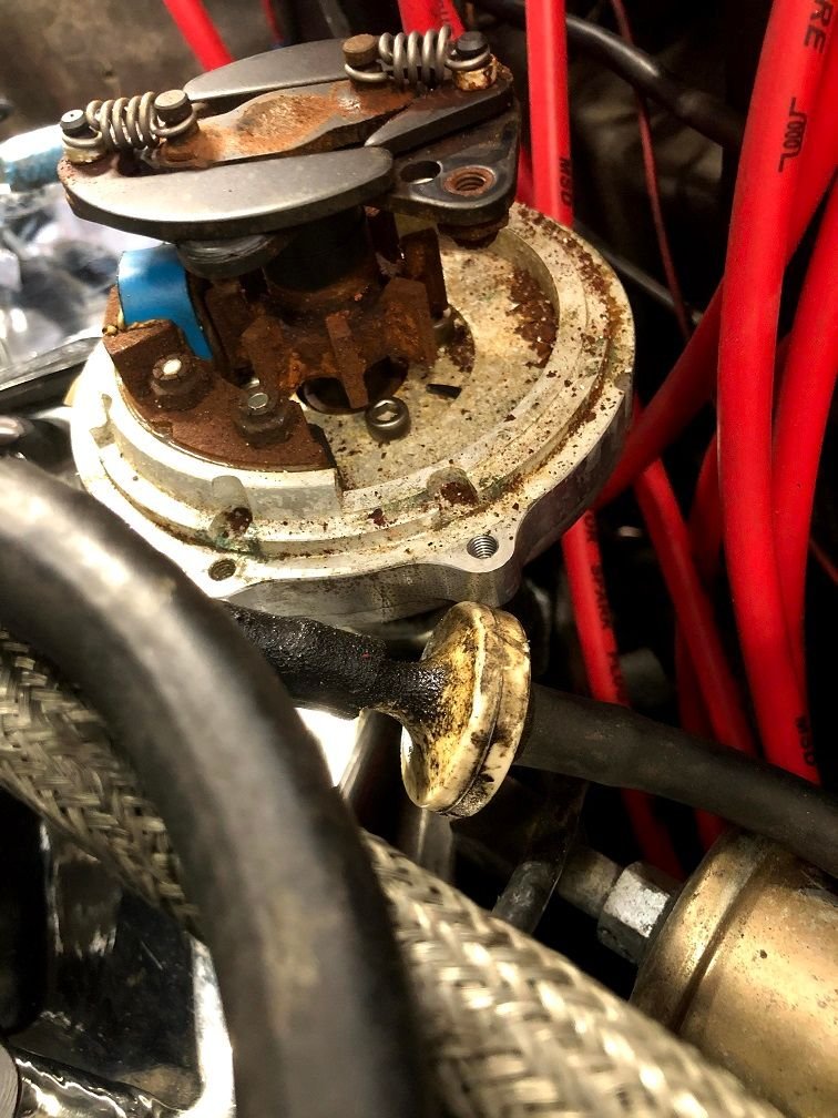

So - this post made me curious so I went and checked to see how my MSD was looking almost exactly 2 years after I painted it with POR-15. Note that I have the "good" vented cap and all that. Anyway, here are some pictures. It's a lot better than when I just coated it with WD40 but still....... it must just be some crappy quality metal in there. I cleaned it up and put another coat of POR-15 on there since it worked better than anything else.
Recoated with POR-15

I agree. The rest will get surface rust all the time whether vented or not. Clean up as best you can but replace rotor and cap.
